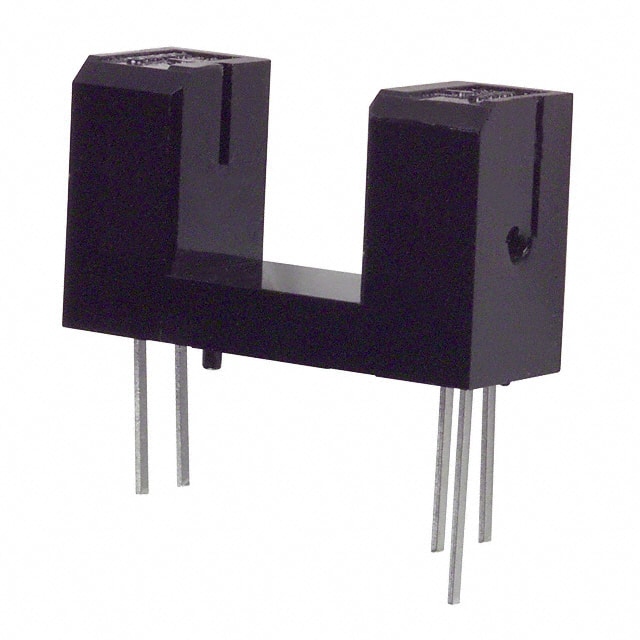

Hi all, I had a bit of a chain reaction failure on my trainer. The capacitors got all distorted and broke the plastic wheel that spins around them. The wheel has tabs that go through a photosensor. I think this likely makes up the speed sensor on the device. At any rate, that photo sensor got totally smashed.
You all have some great pictures of this PCB. I'm hoping someone has one where they can read a part number on that photosensor.
I am having issues uploading a pic right now. It's on the same side as the 4 big capacitors. I will try again later. It's very similar in appearance to this
https://media.digikey.com/photos/Omron Elect Photos/EE-SX3070,EE-SX4070.jpg
Any help is greatly appreciated. I think I can fix it, but need to find the part!

Sir stefhelm . . . . .
The capacitors got all distorted and broke the plastic wheel ( interruptor) that spins around them
. . . . . now, just exactly how do radial leaded E-capacitor cans get all physically / and / mechanically distorted ? ? ? ?
Refer to the center hole and the 2:00 clock position going from it to the 100 ufd C9 E-cap can. Go to its left to the gold flashed round test point labeled as PULSE.
Then located just to its right, should be the vertical rectangular layout of the 4 terms of the OPTICAL INTERRUPTOR . Top two pins are th SENSE and the bottom two, are for the illuminating LED . . with it being .fed through SM R7.
If your unit will still power up from AC power measure the DC supply voltage across the minor gold two test points to see what that supply line voltage is .
Then past the R7 to see what the dropped volage is.
Also go on up to the very top to the large REG1 and pass us all of its numbers.
OMRON 1041 . . . . .
http://www.farnell.com/datasheets/1813202.pdf
hat shows it to be using an internal IR LED emitter with the same low Vf as does a visible Red LED and is using an ~ 20 ma current pull.

stefhelm
Jan 17, 2021
3
Jan 17, 2021
3
Thank you very much. Great information. I fortunately do have a friend to help me out with the assembly of the new parts as this stuff is not my strong suit.
As for how it all happened... I have no idea. I opened it all up as I heard the broken chunk of interrupter rattling around. Nothing is deformed other than the capacitors. They are raised significantly off the board and one is totally missing a connection (how the heck is a pin totally missing from under the capacitor??)
I'm assuming that them moving was the initial cause... bearings in the roller are solid, so the interrupt wheel should have never been off its its axis. The cylinder bodies of the capacitors look a little bashed up like one or two could have taken a hit. Soon as the interuppter broke, I'm sure that is what flew in to the optical unit and ripped it off. Strange series of events. It does still power up. I was able to do a firmware update prior to knowing what was wrong.
I think the is good possibility of getting up and running!
