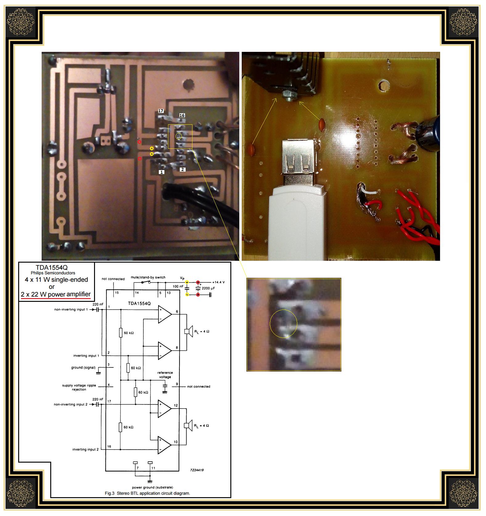

I have made an audio circuit with a tda1554 (bridged to make two 22W outputs) but the IC keeps melting. It is the same as the circuit on the datasheet but with the signal ground connected the the ground of the volume control potentiometer and the audio cable ground not power ground. I have added a picture of the PCB. The audio cable is connected to a Bluetooth module powered by USB. Please help.

your photo is too far away to make out any possible wiring errors
and show a photo of the bottom side of the board as well
Ohhh and what about your power supply ????
what is it, did you build or buy it?
if you built it, you better show pic's of that as well and how you connected it to the amp board

Where are those twisted red and black wires going to ?
is that 12V coming in on that wire in the lower right of the first pic ?
what is being hidden by the USB stick in that pic ?
you also appear to have missed the 220nF capacitors on the inputs

Sir adamdavies986 . . . . . . . .
Initial Observations / Considerations
1
You have your Power supply electrolytic at one side of the board and its companion HF/RF ceramic decoupling capacitor at the complete opposite side of the board with all of that inductive foil path between them.
2
Move the units to the YELLOW and RED circle positions RIGHT up near the pwr chip.
3
Might as well move the decoupling capacitors associated with the 3 terminal regulator right up beside its terminals also. Consult the 3 term regulator data sheet as to the preferred and types of capacitors + values.
4
With your choosing of BTL mode your mind must have been oriented to power output and at max power . . . . . that will be requiring one healthy size heatsink for cooling that small footprint PWR IC
and your choice seem adequate.
5
The YELLOW boxing is relevant to what looks like a solder bridging, but was probably created in pulling the PWR IC and will later be corrected.
6
Do not see any capacitive isolation on each of your AUDIO inputs.
7
Your chip failure could have been attributed to that long inductive foil path and its distant bypassing having that unit operating as a power ultrasonic <--------> RF oscillator.
SCALED AND MARKED UP REFERENCING . . . . .
73s de Edd

Your now loose pin, may well be related to the meltdown and fracturing of the chip during overload.
MOST importantly, no provision of DC isolation of the audio input of that Chip is being provided by the presence of a set of 0.22 UFD capacitors at its audio input pins . . . . check the provided data sheet.

1) and 2) not good but not going to cause his observed meltdown problem
3) again , not good wont cause the problem ... but should have been better placed
5) he commented on this in his earlier posts ... so not relevant, not causing the problem.
6) I already commented on this and he never responded
7) That is a possibility
@adamdavies98 .... overall the board layout is really poor and needs to be redone before you waste another chip
Also I noticed that one audio input pin on the IC might be loose, would that be enough to melt it almost instantly?
no
The output is the audio cable plugged into it not the data cables
you don't have anything except power connected to it ( the USB port)
So the capacitors on the inputs are very important?
absolutely ........ I commented a few posts ago that you didn't have them, but you didn't respond
Also, since the chip costs £10 and this is starting to get expensive, would the tda1558 work the same as the pinouts are identical and it is the same power rating
why change to a different chip ?
you FIRST job is to design a new board layout .... get places for the missing caps and get the layout done in a way that decoupling caps between positive and negative rails DONT
have to run the full circumference of the board

OK hopefully looks more like this ......
this is still not perfect and I haven't even addressed the lower right corner
I really dislike that long run for one of the inputs
But at least the power and USB port area has been addressed
NOTE the USB port has been flipped around so pins are opposite to what you had
The board is only 2/3 the size of your original one .... and could be still made smaller once the audio inputs are sorted out
the supply ripple rej. pin isn't addressed for bridge mode
in normal 4 channel mode it goes to ground via a 100uF electro cap
so for bridge mode, it suggests ( in schematic) leaving it disconnected
