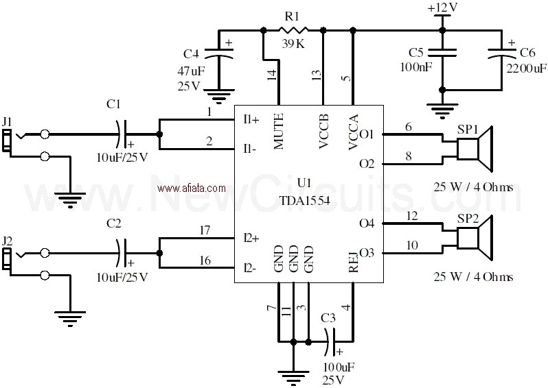

Hello, i need some help with TDA1554 amplifier circuit. It seems like i connected everything right but the circuit doesn't work. My bets are that i'm trying to make this circuit on a breadboard that's why it doesn't work. But I also think that i connected the top part of the circuit incorectlly. I connected those 2 capacitors in parallel and then connected the 12V and the paralleld + side of capacitors to the rest. If somebody could help me with this circuit i would be very thankful. Here's the circuit image. P.S If needed i can take pictures of the circuit.

When you say "it doesn't work", what do you mean exactly?
No sound, smoke, poor sound, hum, etc.

Start by measuring the voltages at all pins of the TDA1554 relative to GND. Post the list here. It's probably something simple and obvious.
Edit: When you measure the pins, be very careful not to put pressure on the probe in such a way that it could slip off the pin and jam itself between two pins, shorting them together. Another idea is to hold the probe near the sharp end and rest your hand on the breadboard, so you have very accurate control of the probe's position.
Also you should upload a photo of your breadboard layout. Breadboard is not really appropriate for a device like this. The pins are too wide to fit into the holes, and you have to stagger them between two rows.
