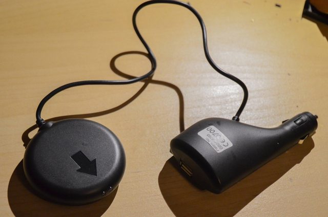

My car insurance company (Admiral, in the UK) contacted me and asked if I wanted to receive a 'box' that would monitor my driving and possibly reduce my insurance premium. I agreed. It only had to be kept in the car for 3 months and then returned, and since I only used my car for commuting, I didn't mind them effectively tracking me. After all they already know where I live and work.
I received the unit pictured below:
Two main components, the power adapter, and the circular "puck". The latter came with an adhesive pad on the back, and the manual noted to mount either flat or at vertically at 90 degrees with the arrow imprint always pointing forward. I assumed it contained at least an accelerometer and gyro to record my driving behaviour, as well as a GSM radio to send the data back to their headquarters for processing.

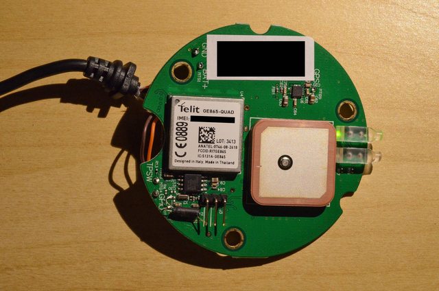

Puck PCB Top

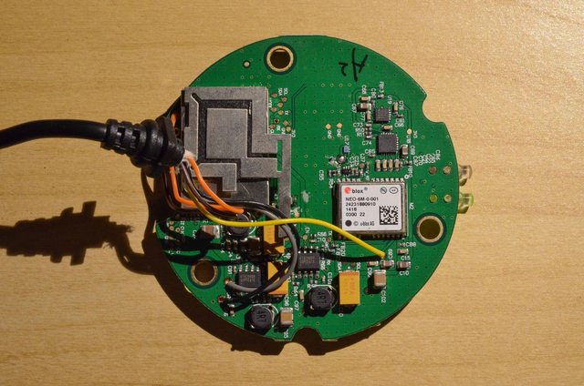

Puck PCB Bottom

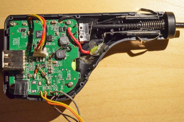

12v Power Adapter

- Identifying marks hidden in photos.
- Contains GPS and GSM units (datasheets linked below), and presumably an accelerometer/gyroscope and magnetometer (I'm unsure where these components are).
- Large shielding can under the angular antenna, unfortunately i didn't want to risk trying to pop it off without damaging the unit. Would have loved to see under it.
- Unit was powered up while taking these photos. Notice the green LED on the puck.
- There is a quite a significant amount of bodging done on the power adapter PCB. Mostly diodes and a couple bodgewires!
- Power adapter has a completely blank PCB backside.
- Power adapter has 2x AAA rechargeable batteries under the PCB connected to the white JST connector on the top side. the device is always powered until they die. There is no off switch.
- The power adapter has a switch on the centre pin of the 12v socket plug, allowing it to recognise when it is physically unplugged from the car.
- Power adapter also has a USB socket for charging external devices, and a secondary 12v connector (black plastic plug on the bottom edge, under the USB socket) for an included optional 12v automotive socket on a short wire
- Interestingly, the patent explains how the unit 'profiles' the car's electrical system (presumably electrical signal noise from the alternator) and recognises if it's being used in a different car.
- The patent proprietor is listed as the insurance company, so I assume they actually invented this particular model.
My questions are:
- Where is the processor? Under the can?
- Where is the accelerometer, gyro and magnetometer?
- Since the unit has a GSM radio, does it also need a SIM card? Where is the SIM?
- What do you think the 3 pin jumpers are for, on the top of the puck?
