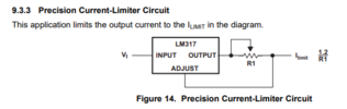

A quick and dirty way is use a JFET like a J109, operate it as current source,
and use a R to develop the V from the current.
See this book, section starting on page 233 for current source application.
OR if you dont have a JFET use a NPN -
OR use a LM317 -
