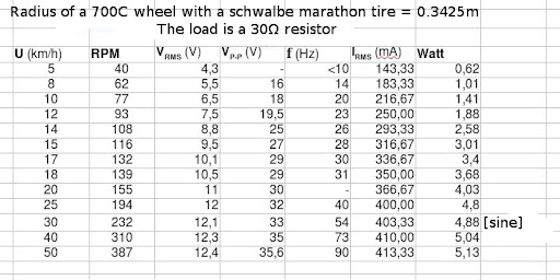

Here is a table I made when I tested the dynamo with a 30Ω load.
It's just basic measurements to aid me in the initial design.
It seems that in high speeds the output doesn't change significantly.
Maybe it has to do with the coil's impendance increasing as the frequency of the AC current increases with speed.
But I'm just guessing, I don't know much about generators.
Anyway, I am looking for a spice model for the LM2907 to test it.
I think it's the best choice because frequency monitoring seems to me the most reliable way to determine when to make the switch.

Have you tried reducing the the load resistance or short circuiting it?
It could be that your dynamo gives a constant current output rather than a constant voltage output above a certain speed. If the voltage changes widely as the resistance is changed but remains constant above a certain speed this is probably the case. If the voltage remains constant regardless of the load, then it's a constant voltage, like a normal transformer.
If it's a constant current dynamo, the LED can be connected directly across the output of the bridge rectifier without a current regulator. The batteries will have to be charged using a boost converter. if their voltage is above the LED voltage or with a buck if it's below.

I haven't tested it with a lower resistance but I have tested it with a higher valued one.
The voltage varies with the load. The higher the resistance, the higher the voltage.
