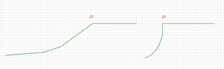

how can i change the centre frequency from 12k (stated in the spec )
to 6k
thanks ♪reg♪

Again a sim changing the pot from 0 to 100% :
Here caps change to get center closer to 6 Khz :
Regards, Dana.

Several approaches :
1) Cascade second order sections
2) Use Chebyschev LPF with G (Q) peaking
3) Resonator bank summing filter approach, sum a LPF and a BPF filter response
You will have to do some experimentation.
Regards, Dana.

Range of 5% to 100% on the pot (two pots ganged) :
Regards, Dana.

The sharp corners at 5k are not physically realizable for reasons I won't go into here. Not even with digital filtering, FIR nor IIR, is this possible. You will discover something called Gibb's Phenomenon if you actually attempt to create such a filter. Try using a circuit simulator as @danadak shows, with multiple stages if necessary, to come close to what you are trying to achieve. Since these are audio frequencies, you ears may be your best "test equipment".

I thought one could theoretically produce a desired response (within non linearity considerations) by doing this
with N (as necessary) stages :
Eg sum the various frequency regions with targeted response for that region
and add them all together.
So if I wanted a camel hump filter at w/two freq peaks......
Regards, Dana.

I was commenting on the inability of real filters to create a "brick wall" type of transition in frequency response. The problem occurs whenever the desired frequency response has a non-differentiable segment, which also includes any discontinuous jump in frequency response as well as "sharp" corners in frequency response. Such filters cannot be realized, even theoretically. Your twin camel-hump filter with smooth low and high frequency response transitions is of course possible, although possibly not desirable, depending on the state of your hearing. At my age, I need to boost the bass and the treble to make music "sound right" but the biggest problem seems to be audio volume. If I can't feel the bass notes, it isn't loud enough. Bag pipes and theater pipe organs seem to benifit the most from a large bass boost, although some classic rock music also sounds better (to me) when fully boosted, i.e., loud enough to rip the speaker cones right out of their baskets if not careful with the volume control.:cool:
