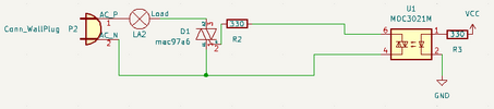

Hi, I use a small mac97a6 triac to control a small 10w LED lamp with a moc3021 photo coupler driven with an esp32 output. The problem happens when I power the triac circuit with 230 V for a moment the lamp turns on, but this does not always happen. I tried changing the Gate R (330 ohm) but nothing..... Do you have any suggestions?

Not supplying proper gate trigger ? Compare gate driving circuit to this :

Operation is correct when there is input on the moc the lamp comes on, and when I remove it it goes off. The problem only exists when I power the triac part for the first time.
I'm not saying you're wrong. I'm saying I cannot believe you. More information is necessary.
Do you have the entire original schematic?
And any and all modifications you might have made.Thank you.

The diagram is what I inserted, nothing more. Also because if I keep the part relating to the gate deactivated the problem remains.
Even using the scheme you suggested where only the R values change, the problem remains

Having noticed that the problem also occurred with the gate control circuit, I found this solution which seems to work.
