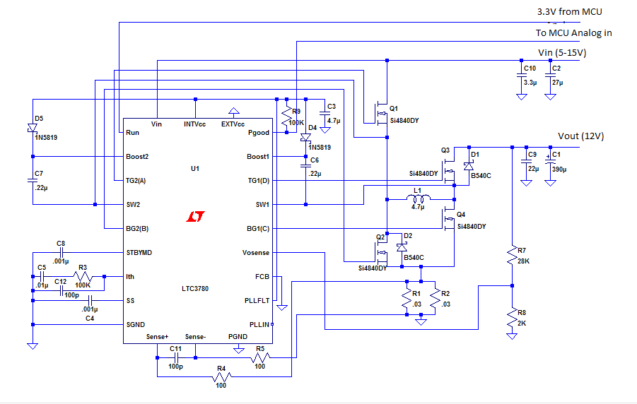

Hi everyone,
I have currently built a buck-boost converter using LTC3780 on a breadboard following this deisgn.
The circuit is calculated and designed to accommodate the input voltage given in the schematic. I have checked countless times and ensure that there is no mistakes in the connections. However the output that I am getting is only a noisy 6V. The switching signals that I observed on the oscilloscope is also fairly noisy. Can someone enlighten me how to troubleshoot this converter?
Thank You

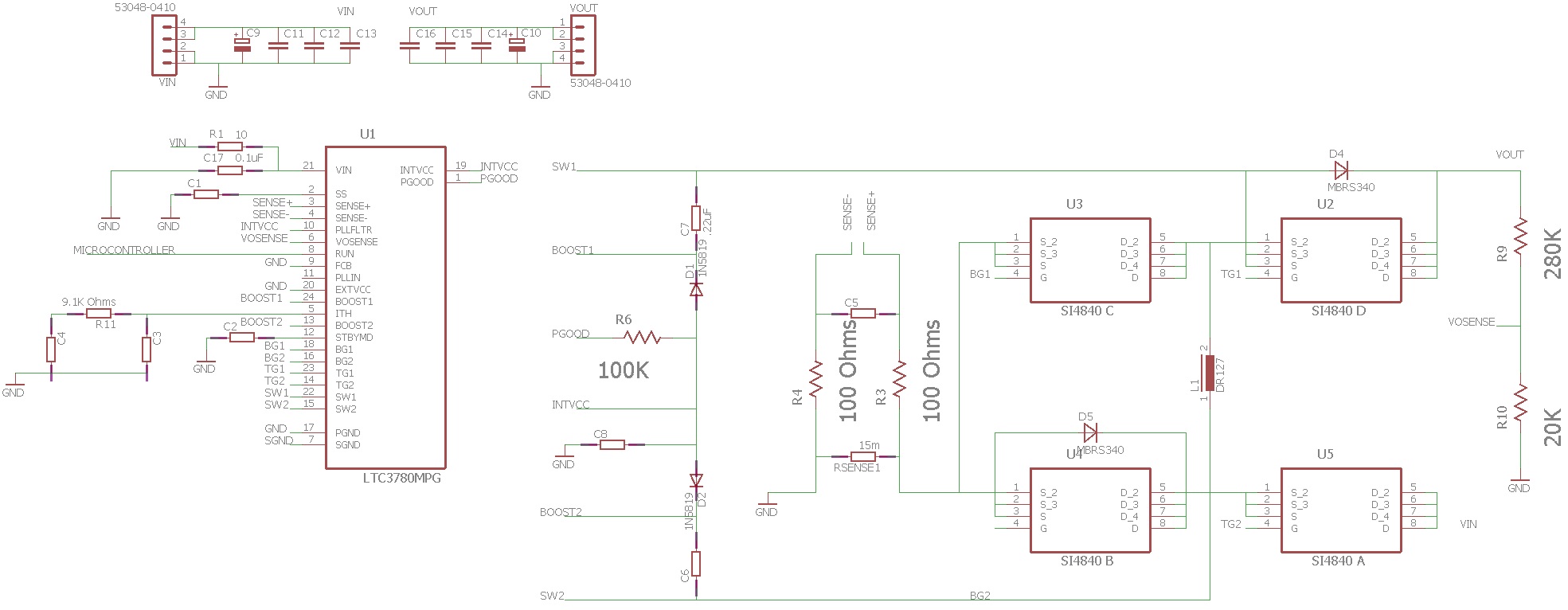

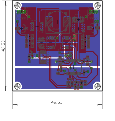

Thank you for your advice. I try the circuit on breadboard but the switching signal that I got from the controller in extreme noisy so I have decided to test the circuit on PCB. The following is my schematic and PCB, I have tried to follow the design consideration given on the datasheet as much as possible. could you guys give me some feedback on my design?
Thank You
