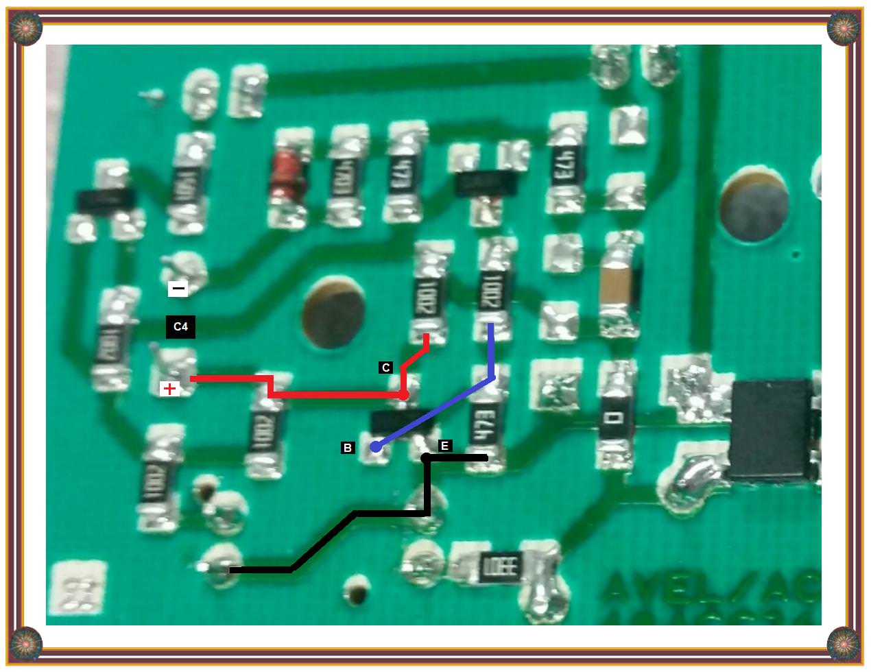

As far as operation goes: Yes, The molex connector goes to a microswitch pushed to initiate the punch cycle. The triac turns on a motor that drives a cam to make punch go in and out.
I have on order several zener diodes to replace shorted one found. Power supply was dead. I wasn't sure I was going to successfully identify the bad zd so I just ordered a variety of voltages. The original zener looks to be 15v.
This failed zd is likely the heart of the problem but I'm left with a few questions.
The Ir diode section of the photo interrupter has a 3.3k limiting resistor which only leaves about 4ma for it given a typical Vf of 1.2v according to the data sheet H301-05.
How much current is necessary to produce enough light to switch on the photo transistor? I'm sure it depends on how the transistor is loaded and supplied, but is there a range should I be looking at?
I see the graph shows If at 20ma at 1.2v.
Had I not found the 15v marking on the zener I would think the supply to be much larger than that.
I know maximums are important but if insufficient Vf or If is supplied, would this cause the Ir led to fail?

A crude sketch drawn without knowing the itty bitty transistor pinouts, in case anyone's interested.
Waiting for postman to bring me a zener.

With your reverse sketch, I can now see that the WHITE MOLEX switch starts a paper punch operation and simultaneously starts a timeout function with the two discrete transistors.
Then, if all is well, the punch action is completed and the punch cycle end was confirmed with the Optical Interrupters beam disruption.
However, IF the paper sizing/weight or number of sheets stalled the mechanism, the time out function stops the motor unit and the compression spring releases pressure on the indented / unpunched paper..
To be able to replot your initial sketch as a proper schematic . . . . . confirm for me . . . . . units BRAND and Model number, also wattage rating, if on its label.
  • 1 . . . I think that your connections of the C4 22 ufd @100VDC rated (for having low leakage) timing cap at the bottom of ur sketch are in error, I see its + going to a transistor collector.
  • 2 . . . I see that you caught cap bleeder resistor R2 1 meg, but that you omitted the R1 1 Meg resistor that is located between neutral AC line to the SWITCHED hot AC.
  • 3 . . . I can make out the markings of the wire terminal stakes of MOTor . . . . .C . . . . . LINE . . . .SW2 ( it being the units main power switch) and up above, the top MOTor . . . . N ??? . . . . . PL?? also, at board bottom there is an 8W3 , probably being SW3, what function is it ? and what does it go to, and where is that switches other end connection being ?
  • 4 . . . On the two PL's, I suspect them to be going to an AC line operated NEON pilot light, power presence indicator / power on, with its own internal current limiting resistor.
You seemed uncertain on your transistors element assignments . . . .if their I.D. markings are visible, see if they all might be the same or a mix. Then do a diode test from a base to each collector-emitter for the beeps identifying good junctions and also for that telling if they are being either an NPN or PNP type of transistors.
Here is basing, with the Collector tab being alone at the top
Left lower tab is Base . . . . . . . . . .Right lower tab is Emitter.

@73's de Edd: Excellent observations all spot on except the 22uf + does go to transistor side with only one leg (what your illustration shows as collector) I think its the base.
I'm not worried about plotting out the exact circuit at this point but its fun to know how stuff works. (....Including Viagra. lol)

Ok, I popped in a new zener a few minutes after getting my hands on it and the Punch machine is working fine.
Yes, I thought about bench testing to find out the current required but I was curious how it's calculated form using the datasheet. Alas, I have a lot to learn there.
In the event that a component can't be identified like that shorted zener, I would think it more practical to inject a separate DC supply like that in order to find the correct value, rather than try to figure the loading/currents and doing complicated math.
Had we just took a educated guess at where the voltage should be I imagine that it could have gone badly.
