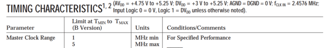

Hello,
I am trying to using an Arduino with an AD7730 ADC. I am unfamiliar with SIP interfacing so I used some code pulled from GitHub. However, since I don't have a clock on hand, I am trying to use the clock on the Arduino itself, but I am unfamiliar on how to do so such that it matches the chip's requirements. I am having a lot of difficult getting this to work, and don't know how to trouble shoot or how to begin.

Your master clock for the 7730 :
Page 32, 33 for clock generation.
Regards, Dana.

Hi Dana,
Thanks for the reply.
I have seen Pages 32 and 33. I am using a (hi-lo-hi-lo) clock from the Arduino digital output pin since I don't have a crystal clock on hand. Is this possible to do. MCLCK out has been left disconnected.

You meeting the specs I posted in post #2 ?
Does datasheet call out startup conditions for 7730 that have to be met before
part produces valid data ?
Regards, Dana.

Use a hardware timer to achieve the necessary high clock frequencies (link).
