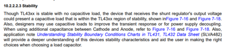

Caution about C loading of this part and its stability :
Regards, Dana.

That's when using the device as part of a linear regulator.
Here it's being used as a comparator.
This seems to imply there is in fact feedback in that circuit :
Some simple bench testing should show phase margin problems from transient response,
if there is a problem.
Regards, Dana.

9.4.1 Clearly states that as comparator, it is operating open-loop and thus cannot have phase-margin problems, since it has no negative feedback.
Why do you keep implying otherwise?

When the cathode/output voltage or current of TL43xx is not being fed back to the reference/input pin in any form, this device is operating in open loop.
I was looking at original OP posted schematic, now I see yours has a control loop 180
thru MOSFET, MOSFET C loading Vout pin of 431, then back thru load and its C (if any)
and MOSFET Rds and then R4.
Maybe a transient sim as well as a bench test ?
Regards, Dana.
thru MOSFET,
As I noted, that provides a small amount of positive feedback for hysteresis of the trip point, not negative feedback.
Only negative feedback would give a possible concern about stability.
Since the circuit is acting as a comparator with only two stable states, your continuing concern about stability has no basis.
