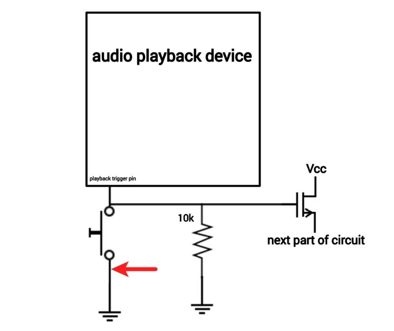

The module is set to button trigger mode for the fx system I'm working on. The module is a 5v device and the button pins measure approx 4.5v when floating and 2.6v when pulled to ground.
I then got to thinking about tying a path to one of the the buttons directly but as the pins are only 2.6v when closed circuit, it isn't going to be enough for the 555 trigger, so I thought something like the LP2992 logic level nfet could be used to tap 5v from the modules power rail as a monostable pre trigger.

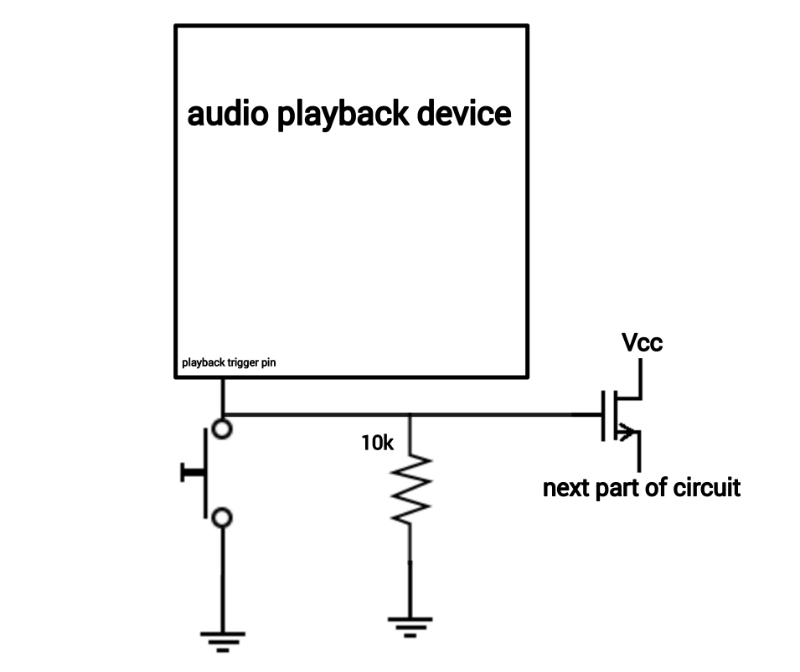

I made this quick schematic of that particular juction:
However, I have little faith in the above diagram as it looks like I've just gone and given the floating a pin a path to ground via the gate's pulldown resistor, which I'm guessing will automatically trigger the pin when power is applied. Useful to know for other projects but no good in this case.
The only place I can think of to go from there is on the buttons negative side to ground as indicated by the arrow in the pic below:
Again, my faith is a little shaky and not sure if it'll work as intended.
I hope so as I was then going to use the monostable to trigger a second nfet that controls the high current LED for the muzzle flash effect.

As shown this will unfortunately not work.
The transistor shown is an NMOS transistor. It requires a positive gate-source voltage to become conducting. As the drain is at Vcc, the gate voltage would have to be above Vcc in this circuit, which is not possible by simple means. Also, the 10k resistor from the trigger pin to GND is in parallel with the pushbutton and will keep the gate voltage at 0V regardless of the state of the pushbutton.
I recommend the following changes:
  1. remove the 10k resistor
  2. replace the NMOS transistor by a PMOS transistor
  3. connect the source (arrow) of the PMOS to Vcc.
  4. connect the load to drain of the PMOS
Note that you will have to use a MOSFET with a low threshold voltage (Vth) which can be operated by the Vcc (i assume 3V...5V) of your circuit, These often come under the nickname of "logic gate MOSFET".
[Edit] As you are going to trigger a monostable multivibrator from the pushbutton, you may probably not need the MOSFET at all as long as the monoflop can be triggered by the falling edge of the input signal. If the trigger input pin of the sound module has an internal pull-up resistor, the pushbutton will siffice. If not, add an external pull-up resistor to ensure high level on the inputs of both monoflop and sound module when the pushbutton is inactive.

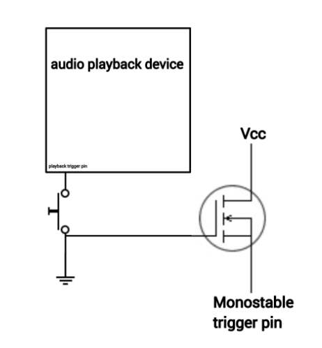

Oops, my bad. I'm terrible for getting the source and drain the wrong way round in my diagrams, it was supposed to be an NFET so I've re drawn it (took your advice and removed the 10k as well

No, sorry, this won't work either. The source of teh PMOS is constantly at ground, turningthe PMOS on. The switch has no effect on the PMOS.
You need to connect the source of the PMOS to the switched side of the button.
Also your symbol still showsn an NMOS transistor.
