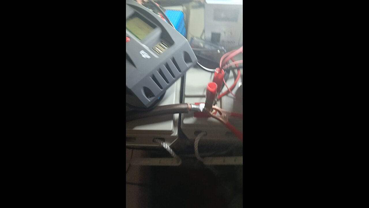

here.. 2 photos of my solar system if youd like to inspect anything.... please mind the mess.. just because i was miliitary once doesnt mean i will spit polish my boots forever....

i have a thought.. forget the ups.. just stick with the inverter... i bought a simple dc switch to cut power from mppt to battery.. and i will just buy a power charger and load the 2 batteries while i snooze.. and during the daytime i will just switch the power flow from mppt to battery and hopefully with 2x 12v 50ah batteries i will safely be able to keep myself preoccupied for 10 hours a day... hopefully with what is INSIDE the 2 batteries and whatever the solar panel is providing.. it will give me those 10 hours.. my question.. if you can answer this.. should i run low on power during the evening.. can i rapid charge the 2 12v batteries while im operating that scary inverter ?
here is a screenshot of the rapid charger that ive mentioned....
yes it sais motorcycle but thats because Asia is very motorcycle oriented...
i see no problem why this wouldnt charge both batteries that are linked in parallel...

okay.. so here is what i am planning to do.. so bear (bare?) with me.. i ordered a "smart" charger.. i will plug this into my 2 batteries(power bank) at night.. pump it full of happy watts.. unplug when i wake up.. and connect that to the mppt to the same 2 batteries.. so i will my use 3 electronics (pc monitor, modem) on the same power bank.. .. and whatever the solar panels actually get.. i kinda use..kinda made my own UPS... this way.. the power bank wont have 2 separate power sources at the same time... AND.. i built in a cut off switch on negative side from mppt to power bank to break the solar charging circuit to safely plug in the smart charger...im no elon musk or Stephen Hawking.. but i SHOULD get 10 hours of use out of this during the daytime... and yes i used billionaire genius Elon Musk first, he is after all half Cannuck...
quick question though.. for my occasional insomnia nights.. can i use my crappy inverter with the power bank while the "smart" charger is charging the power bank ?
AND additional percaution, i ordered a table fan.. with dc clamps to blow on anything that gets too hot.. like the inverter for example.. i did mention that my inverter that has 1000 watts on it and mandarin written on it gets super hot when ONLY the computer tower is plugged in...

Why? If the battery voltage and the battery chemistry are identical, the charger doesn't know or care about the capacity; all discharged batteries (of the *same chemistry*) look alike. The charger circuit will run longer before shifting down to trickle mode, but it already has a fan so that should not matter.
Separate from that - the UPS charger probably is not designed to balance the charging of multiple batteries in parallel. Welcome to the real challenge of electric vehicles.
I do. Can you post a sketch of the various components and how you have them connected now, and another with your proposed changes?
