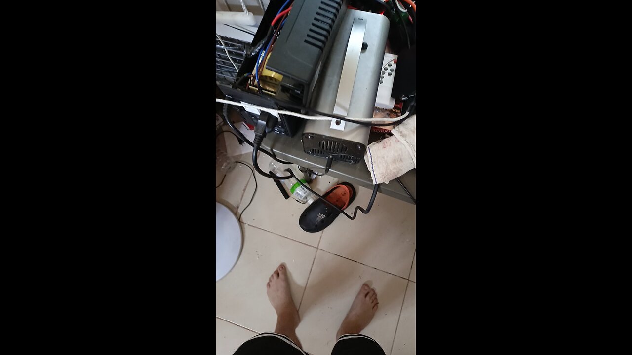

I think you might be interested in this
I hope it helps.
thank you, that video is nearly identical to my solar setup.. until he gets to the relay part.. i had a nosebleed and an aneurysm i think
here
https://rumble.com/v50opsl-your-diagram.html
voila, a nicely made video on my solar setup, kindly ignore the remarks about "diagram" that is intended for another thread, i of course welcome your criticism.. and the high pitched sound is actually the inverter fan...

Honestly I never saw one of your videos I don't watch videos pulled out the info from the conversation. Sorry buddy but I got it like that! Booyah!
I think you're going to do what you're going to do and you're looking for a cheerleader to root you on. You got here on your own kiddo you're pretty innovative I know money and material is in short supply but you have done well...
Put pen to paper and draw out a diagram what is very important is the length of your conductors the wires you hooked up. Just copy what's already given in the other videos and alter it to fit what you are doing this way we're on the same page. If you do that I will watch your video.

thank you for the advice, are you trying to lead me to cause my own personal 1917 Halifax explosion ???? i know Qc isnt popular but cmon, same team here... same red jersey on the ice...
i had very basic DC education in secondary (that is high school in Qc).. but my knowledge on solar is minimal at best, i still have manyt questions , for example.. electrons can only go in 1 direction .. either TO a power bank or OUT. so how can i use an inverter on said power bank whilst charging same power bank...id love to dig up Tesla and ask him myself.. or is it Edisson ??? but that might seem rude...
