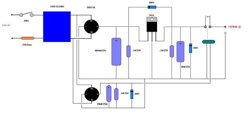

Hi Keron,
Practically, all IC circuits draw a very small amount of currrent, the latter can cause problems since a power supply when turned off will slowly discharge since current consumption of your circuit is not enough to pull it to ground fast enough.
When you rapidly turn your power supply ON/OFF the source voltage is never able to find ground fast enough, the slow decay during ON/OFF is still at a potential to activate your low current circuit.
Remember, filtering capacitors and how they store a charge...
A good way to bring the source voltage to ZERO when turned off is to provide adequate isolation, use the below circuit to OPEN the rail voltage when turned OFF.
The circuit is proven and will allow you to rapidly enable your source supply ON/OFF without any problems.
However, do not add more capacitance to the bottom section of the circuit, keep the small filtering cap at 10uf; one does not need a lot of filtering for a relay!
Furthermore, DO NOT disregard the circuit in replacement for a load resistor to pull the source supply to ground, the latter is counter-productive and will only create more current and heat!
The above is a dilemma with most on-board power supplies, the circuit presented is a very good work around that will address the issue without any drawback!
Finally, i am not completely sure as to how you are using the MOV in your circuit since i believe the problem is associate with the DC level (voltage) powering the CMOS etc...
Another way to mimic the above without building the (pictured) circuit is to power your circuit (CMOS) with a small DC battery with an in-line switch.
Rapidly, switch the DC on/off in rapid sucession and see if your issue is noted.  ;)

hello Omni,
                  can you explain more about  powering your circuit (CMOS) with a small DC battery with an in-line switch.
                                        the MOV is used across the contacts of relay which switch on and off the pump.i used it becuase i have seen sparks acrosss the contacts when pump switches off.
                                              one more question.i have providing input to logic gates from probes which conducts when water come in contact with them.VDD  is the input voltage.but at first i tried connecting it directly that is Vdd through water to gate input.but the probes need to be almost in contactfor that to work.
                                                so instead of that i used BC548 to anplify i think the signal.the signal from probe is connected to base of BC547 through 150k trim pot..VDD (vss)to collector and emitter is connected to input of logic gate.which is pulled down using 10k resistor.
                                          any problem with the said idea?

The DC source (battery) is a simple test to determine if rapidly switching your CMOS logic will operate properly without a false trigger.
Once the above is determined you will know if the DC power supply you are using is the culprit.
