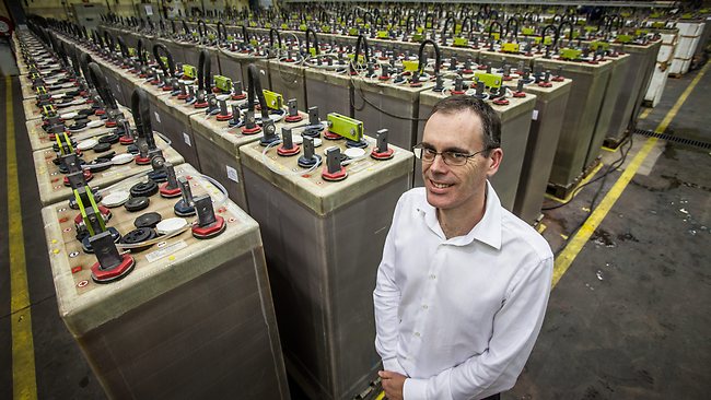

Low voltage can be deadly if high enough ampacity I work with a battery bank where each individual cell can supply 950 amperes. We insulate the terminals, you would not want to drop a open end wrench across them!
Also, they produce hydrogen when charging, creating a hazardous atmosphere.
You should check out a conventional submarine one day...
sirch
Dec 6, 2012
109
Dec 6, 2012
109
Now that's a battery! Might even run my laptop for a few hours :D

My original lead acid (plante') were 1/2 the size of the ones in your photo I've since replaced them with Ni-cads. Same capacity but 1/2 the size again. Stil 950A/hr. System is 130V, 65 cells.
