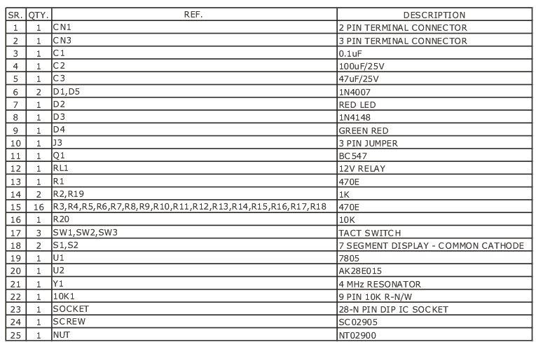

Specifications
- Microcontroller based design for greater accuracy and control
- Power supply input 12 VDC 200 mA
- Two 0.5″ display segments to display time
- 12V SPDT (Single Pole Double Throw) relay for alarm use
- Single key start and dual key alarm time set function
- Power and Relay-On LED indicator
- Terminal connectors for connecting power supply input and relay output to the PCB
- Onboard regulator for regulated supply to the kit
- Crystal resonator based design for better accuracy
- PCB dimensions 72 mm x 81 mm

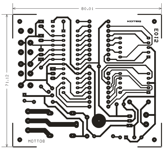

Sir I made this circuit as per circuit diagram but it is not working properly not showing display properly so I need ur help to solve this problem
Make sure you have wired the circuit as shown in schematic and verify your PIC is programmed and running.

i have the same problem as Rafiq : i built the timer, it seems to be working but the display has the segments somehow scrambled .
can someone please help me ?
Turns out the markings on the circuit schematics regarding the connections between the PIC and the led disply are wrong ; the correct connexions are :
-segment E1 on pin 25
-segment D1 on pin 24
-segment C1 on pin 23
-DP1 on pin 28
-segment B1 on pin 22
-segment A1 on pin 21
-segment F1 on pin 26
-segment G1 on pin 27
-segment E2 on pin 15
-segment D2 on pin 14
-segment C2 on pin 13
-DP2 on pin 18
-segment B2 on pin 12
-segment A2 on pin 11
-segment F2 on pin 16
-segment G2 on pin 17
The presented PCB is probably correct and will work but if you modify the PCB as i did then keep in mind the above modifications .
PS: it would have been much easier to modify the firmware then it was ,in my case,to modify de PCB so it would be much appreciated to post the firmware too .
