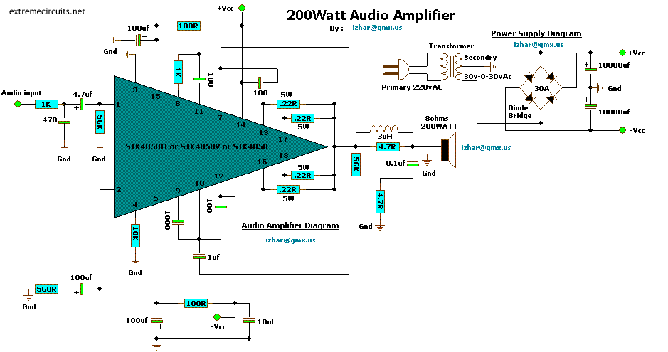

200WATT AUDIO AMPLIFIER
Description
This complete high quality, low noise mono audio power amplifier is based around the Hybrid Integrated Circuit STK4050 manufactured by Sanyo. The circuit incorporates volume and has a maximum music output power of 200W. The circuit incorporates an on board power supply; therefore, only center tapped transformer is required to power the circuit. I t has very good quality sound. U can use it with your Home Theatre your PC & etc… You can also use it as Subwoofer Amplifier. It is a compact package for THIN-TYPE Audio sets. Easy Heatsink design to disperse heat generated in THIN-TYPE audio sets. Constant-Current circuit to Reduce supply switch-ON and switch-OFF shock noise. External supply switch-On and switch-OFF shock noise muting, Load short-circuit protection, thermal shutdown and other circuits can be tailored-designed.
Specifications
  • Output Power : 200Watts
  • Load Resistance : 8ohms
    Input impedance : 55K
  • Maximum supply voltage : (+95v)-0-(-95v)
  • Recommended supply voltage : (+66v)-0-(-66v)

Hello!
Can I ask for the complete parts list of these stk 4050II. Thank you
Elmer
Also the pictures with layout of stk4050II.
robert
hey guys you can download it to manufacturers productlist
Bestluck
Please apart from the 3 listed ic, which are stk 4050,4050v and 4050ii, is their any other equivalent of the above mentioned ic.
