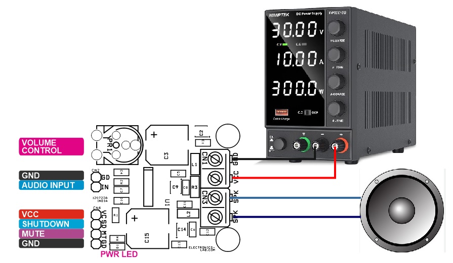

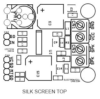

Connections and other details
- CN1 Power Supply: Pin 1 = VCC, Pin 2 = GND
- CN2 Audio Input: Pin 1 Audio Input, Pin 2 = GND
- CN3 Speaker: Pin 1 = Speaker 1, Pin 2 Speaker 2
- CN4 Mute and Shutdown: Pin 1 = VCC, Pin 2 Shutdown, Pin 3 = Mute, Pin 4 = GND
- D1: Power LED
- PR1: Volume Control

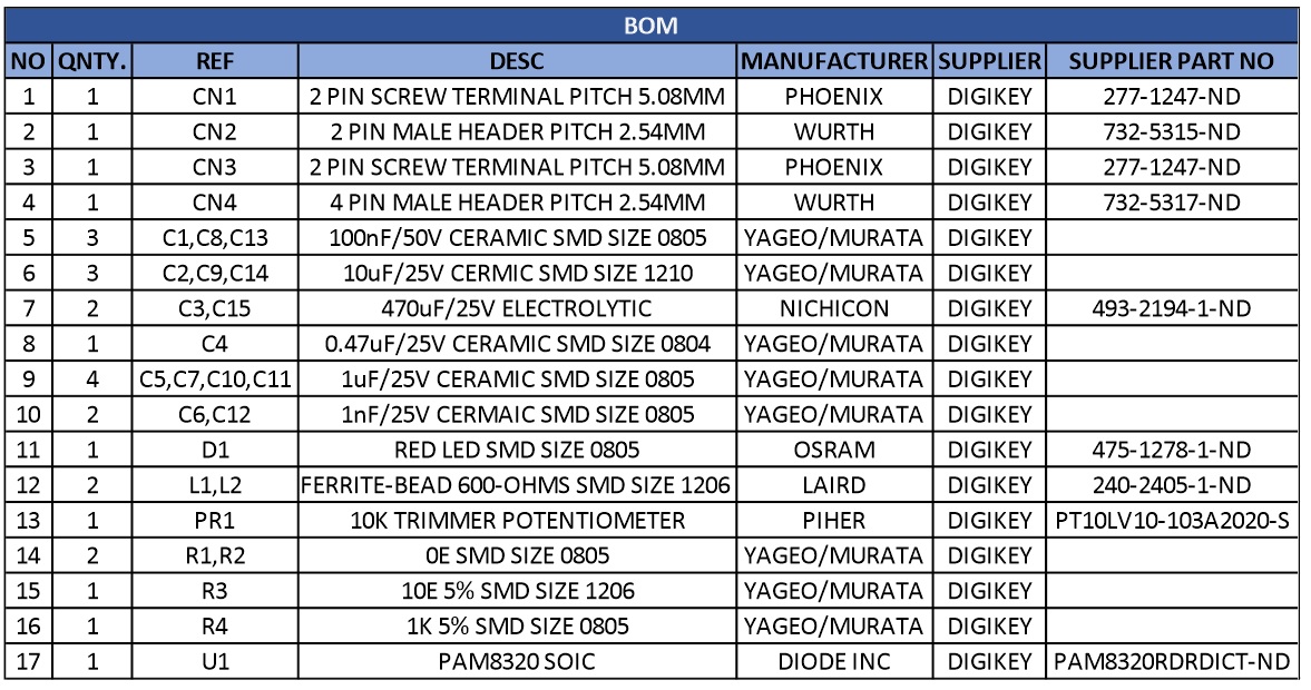

Parts List
| NO | QNTY. | REF | DESC | MANUFACTURER | SUPPLIER | SUPPLIER PART NO |
| 1 | 1 | CN1 | 2 PIN SCREW TERMINAL PITCH 5.08MM | PHOENIX | DIGIKEY | 277-1247-ND |
| 2 | 1 | CN2 | 2 PIN MALE HEADER PITCH 2.54MM | WURTH | DIGIKEY | 732-5315-ND |
| 3 | 1 | CN3 | 2 PIN SCREW TERMINAL PITCH 5.08MM | PHOENIX | DIGIKEY | 277-1247-ND |
| 4 | 1 | CN4 | 4 PIN MALE HEADER PITCH 2.54MM | WURTH | DIGIKEY | 732-5317-ND |
| 5 | 3 | C1,C8,C13 | 100nF/50V CERAMIC SMD SIZE 0805 | YAGEO/MURATA | DIGIKEY | |
| 6 | 3 | C2,C9,C14 | 10uF/25V CERMIC SMD SIZE 1210 | YAGEO/MURATA | DIGIKEY | |
| 7 | 2 | C3,C15 | 470uF/25V ELECTROLYTIC | NICHICON | DIGIKEY | 493-2194-1-ND |
| 8 | 1 | C4 | 0.47uF/25V CERAMIC SMD SIZE 0804 | YAGEO/MURATA | DIGIKEY | |
| 9 | 4 | C5,C7,C10,C11 | 1uF/25V CERAMIC SMD SIZE 0805 | YAGEO/MURATA | DIGIKEY | |
| 10 | 2 | C6,C12 | 1nF/25V CERMAIC SMD SIZE 0805 | YAGEO/MURATA | DIGIKEY | |
| 11 | 1 | D1 | RED LED SMD SIZE 0805 | OSRAM | DIGIKEY | 475-1278-1-ND |
| 12 | 2 | L1,L2 | FERRITE-BEAD 600-OHMS SMD SIZE 1206 | LAIRD | DIGIKEY | 240-2405-1-ND |
| 13 | 1 | PR1 | 10K TRIMMER POTENTIOMETER | PIHER | DIGIKEY | PT10LV10-103A2020-S |
| 14 | 2 | R1,R2 | 0E SMD SIZE 0805 | YAGEO/MURATA | DIGIKEY | |
| 15 | 1 | R3 | 10E 5% SMD SIZE 1206 | YAGEO/MURATA | DIGIKEY | |
| 16 | 1 | R4 | 1K 5% SMD SIZE 0805 | YAGEO/MURATA | DIGIKEY | |
| 17 | 1 | U1 | PAM8320 SOIC | DIODE INC | DIGIKEY | PAM8320RDRDICT-ND |

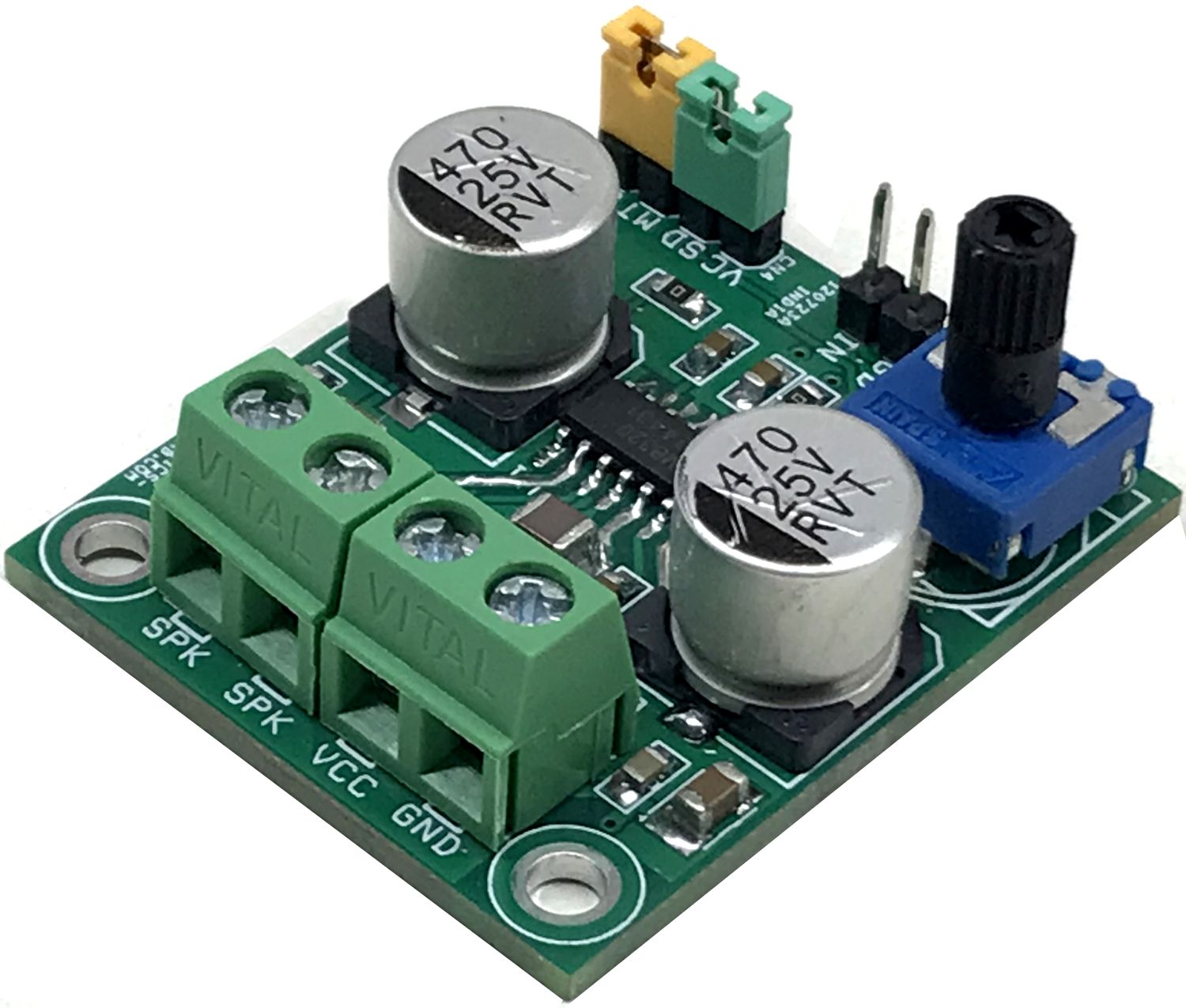

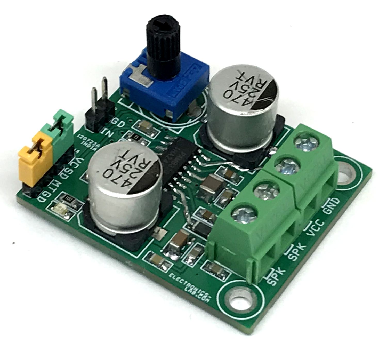

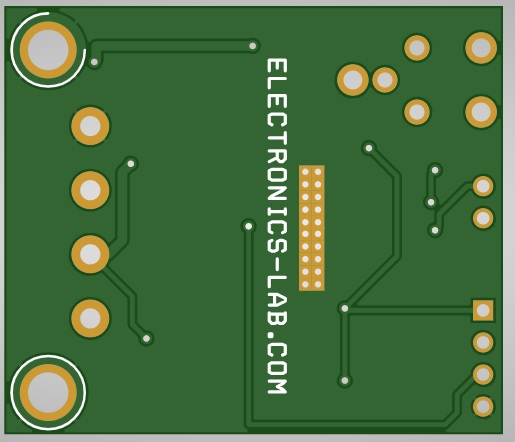

Connections

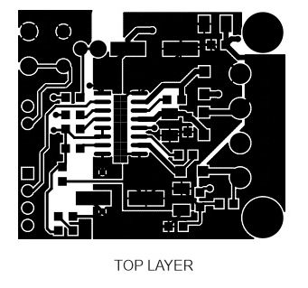

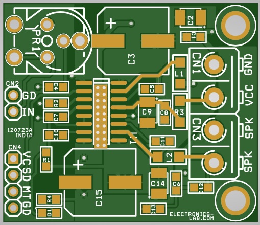

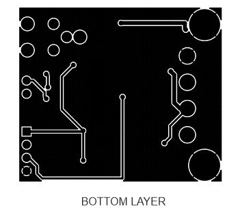

Gerber View

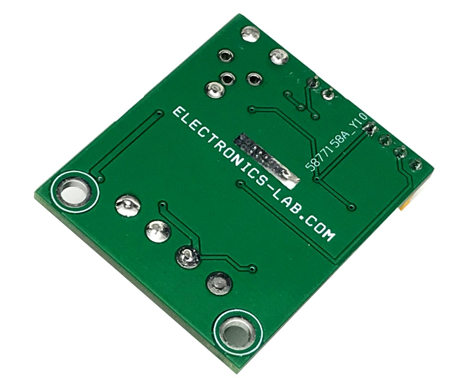

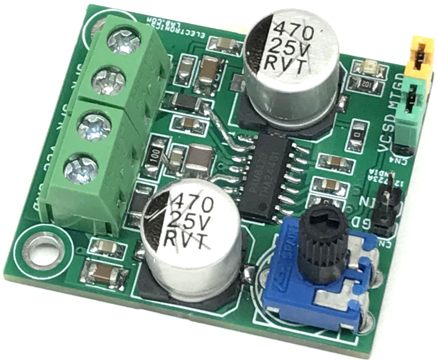

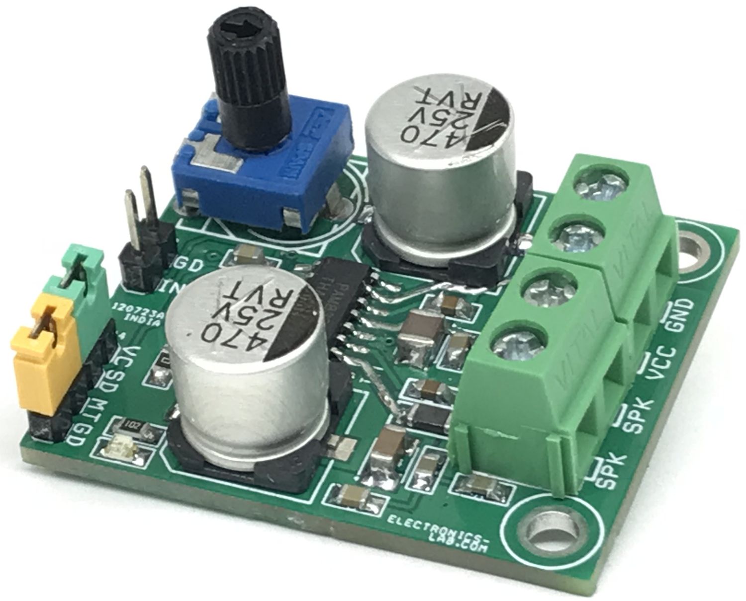

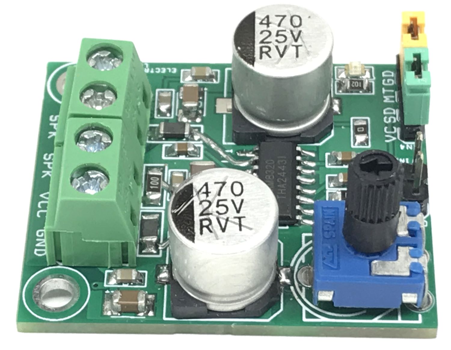

Photos
