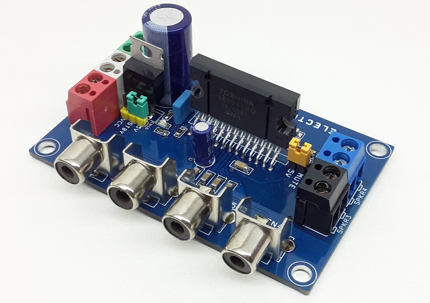

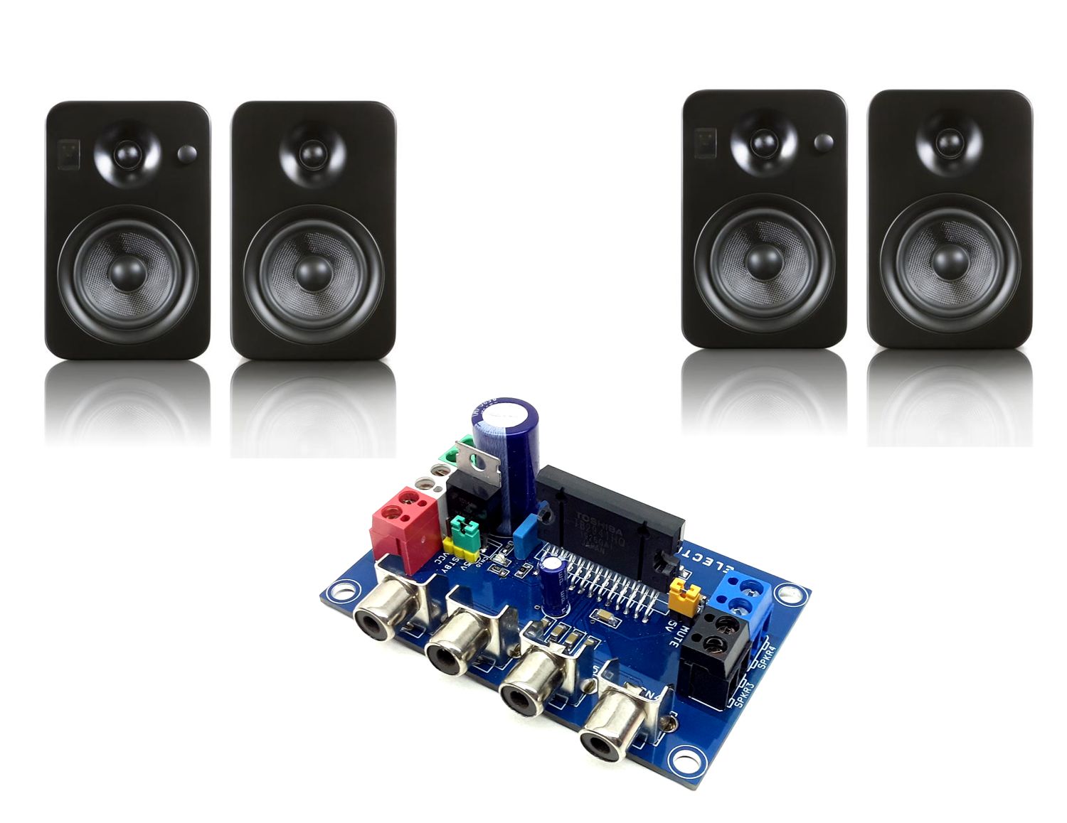

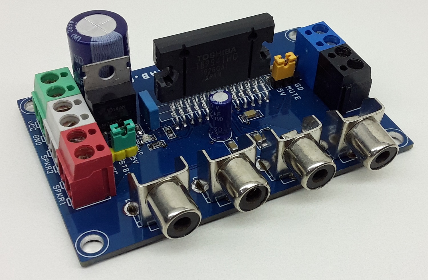

This is a 49W - 4 Channel audio amplifier project that is built using TB2941HQ power Integrated Circuit which has a built-in four-channel BTL amplifier developed for car audio applications. The maximum output power is 49W using a pure complementary P-Ch and N-Ch DMOS output stage.

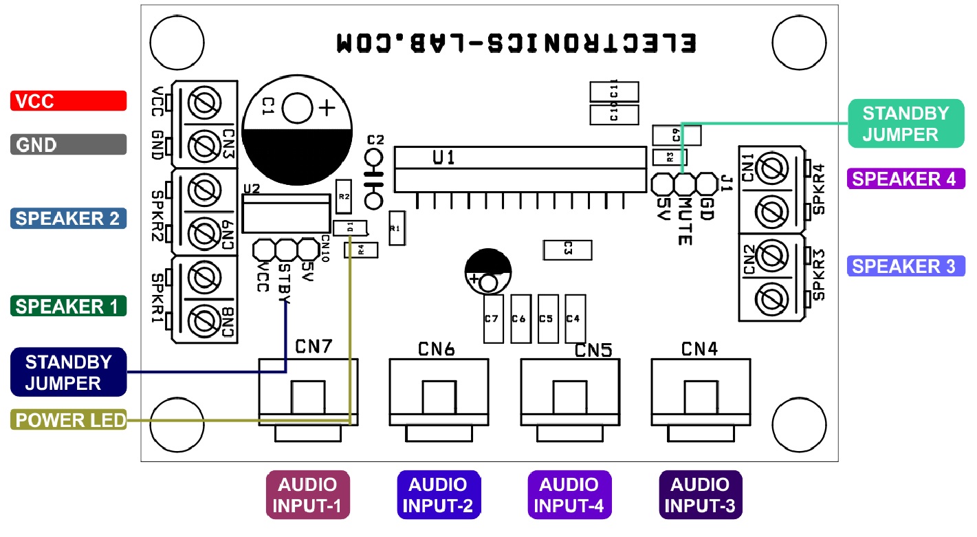

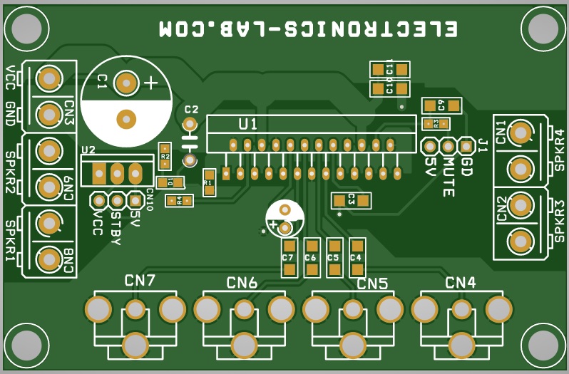

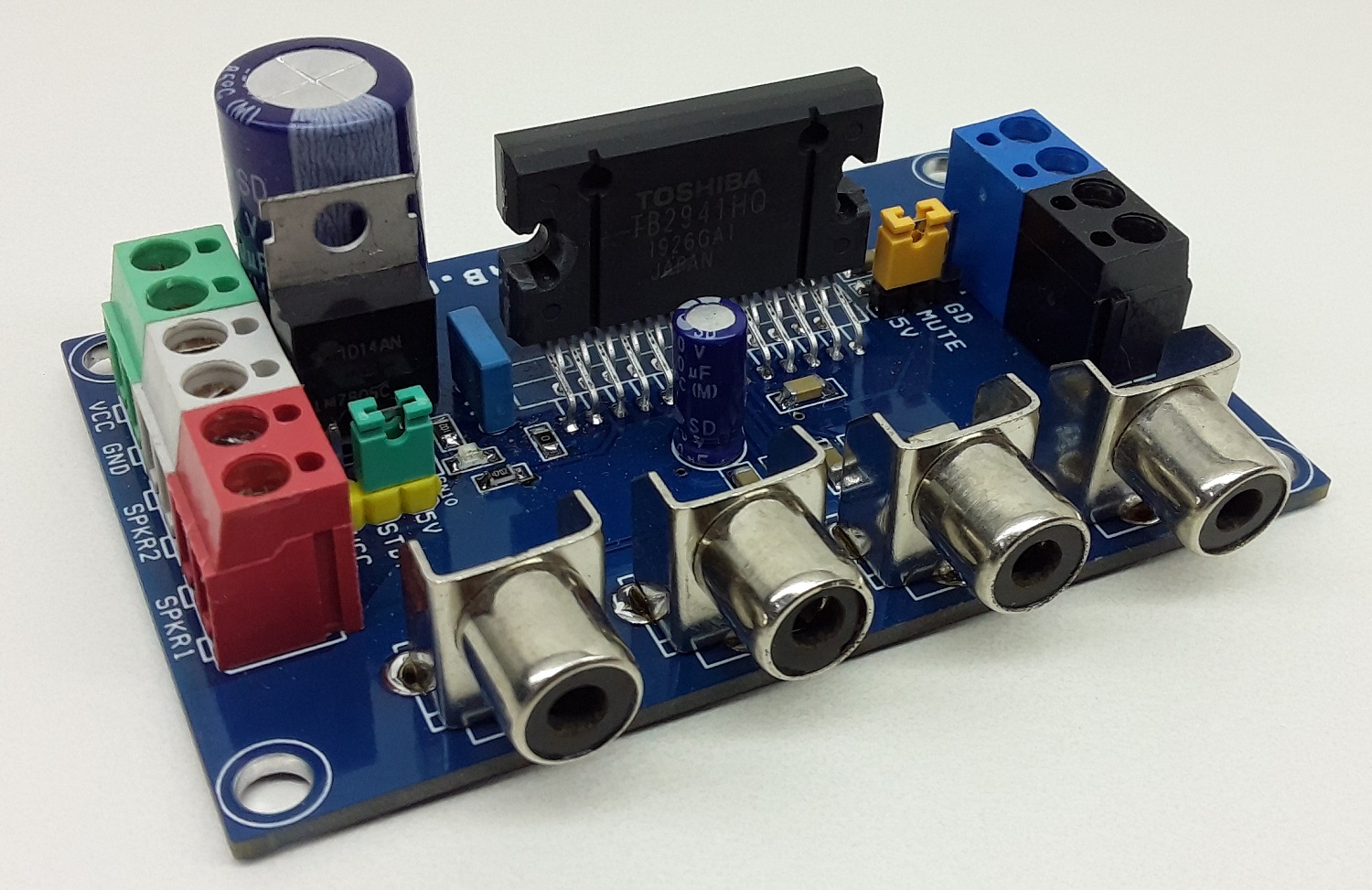

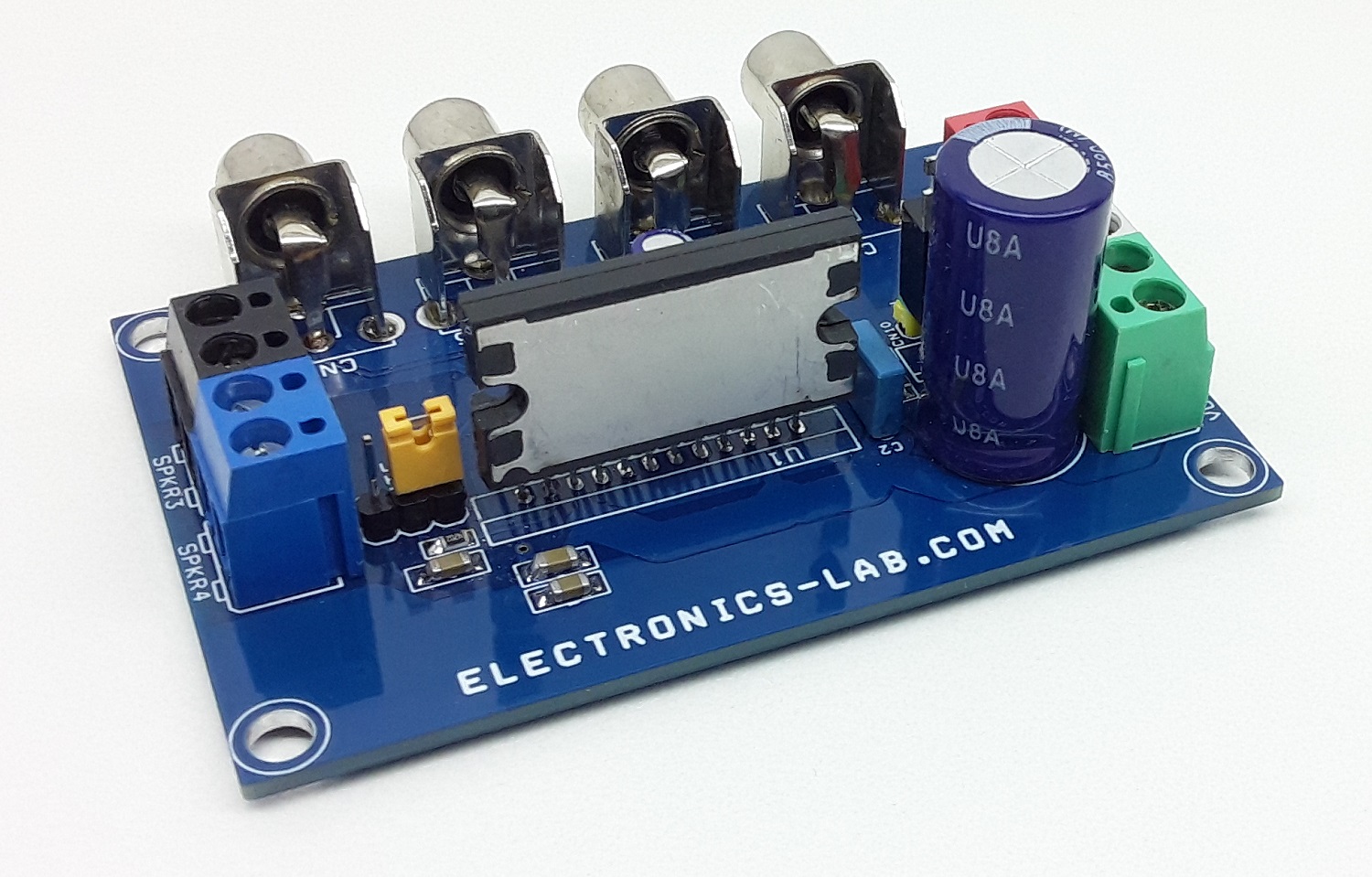

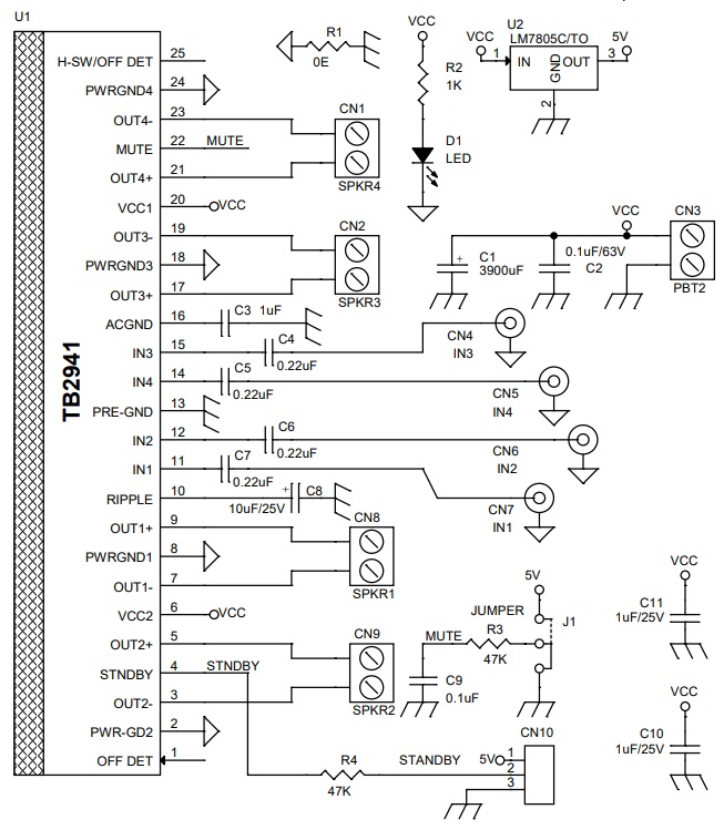

This is a 49W – 4 Channel audio amplifier project that is built using TB2941HQ power Integrated Circuit which has a built-in four-channel BTL amplifier developed for car audio applications. The maximum output power is 49W using a pure complementary P-Ch and N-Ch DMOS output stage. In addition, a standby switch, a mute function, and various protection features are included. The audio mute function is enabled when jumper J1 is connected to 5V DC. The power supply can be turned ON or OFF via pin 4 (Stby). The threshold voltage of pin 4 is 2.2V to VCC (5V). The amplifier is turned ON when standby pin is connected to 5V DC using Jumper CN10. Onboard 5V regulator provided for standby and Mute function. When the headroom voltage is suppressed by the low VCC, the TB2941HQ switches outputs voltage from VCC/2 to VCC/4 and reduces the audible pop noise and the sound cutting. The TB2941HQ can reduce the distortion which is generated by low VCC because this amplifier circuit keeps the voltage gain of BLT outputs. In other words, if one side output of BTL has the voltage margin, its output can make up for the clipped waveform of the other side output.

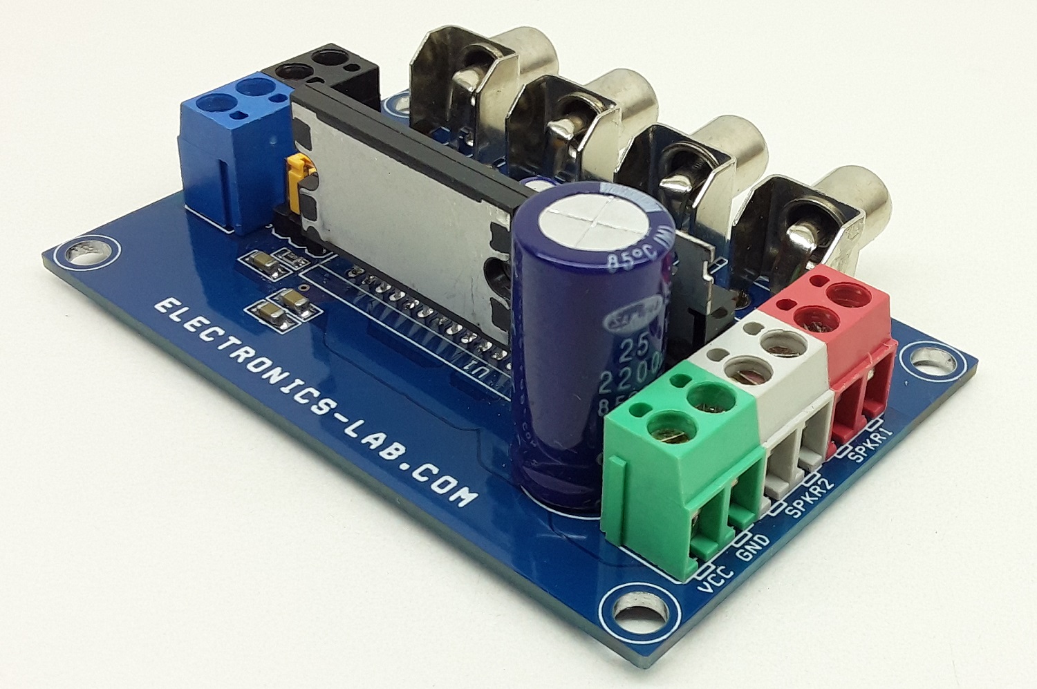

- Operating Power Supply 7.5V to 15V DC (VCC 15V = 49W output, VCC 13.7V=40W) THD 10%
- 49W Output with 4 Ohms Speaker
- 4XScrew Terminal Connector for Speaker Connections
- Screw Terminal Connector for Power Supply Input
- Female RCA Connector for Audio Inputs
- Voltage Gain GV 26dB
- Power LED
- High output power, low distortion, and low noise property
- Jumper for Mute Function
- Jumper for Standby Function
- Thermal Shutdown (Built in IC)
- Built-in various protection circuits over-voltage, short to VCC, short to GND, and output to output short)

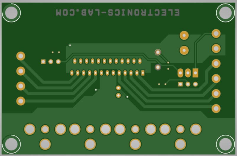

- PCB Dimensions 79.06 x 51.44 mm

Schematic

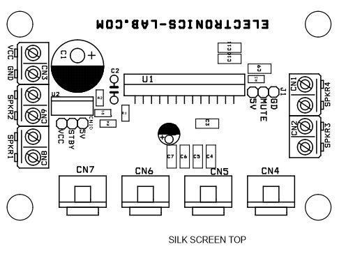

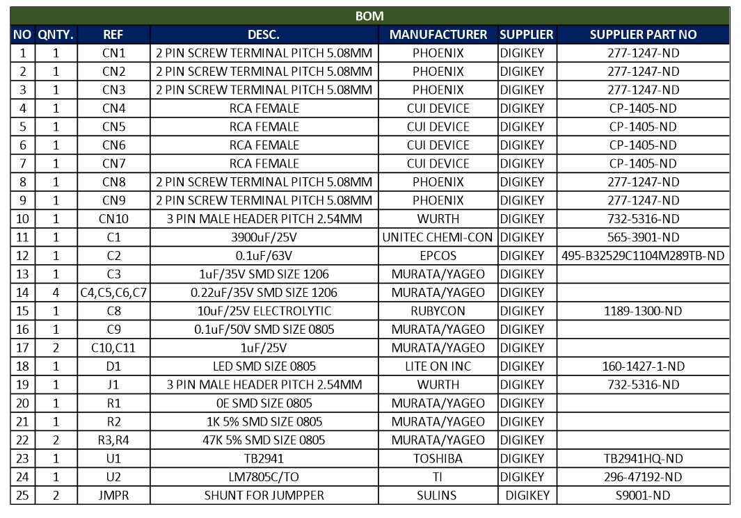

Parts List
| NO | QNTY. | REF | DESC. | MANUFACTURER | SUPPLIER | PART NO |
| 1 | 1 | CN1 | 2 PIN SCREW TERMINAL PITCH 5.08MM | PHOENIX | DIGIKEY | 277-1247-ND |
| 2 | 1 | CN2 | 2 PIN SCREW TERMINAL PITCH 5.08MM | PHOENIX | DIGIKEY | 277-1247-ND |
| 3 | 1 | CN3 | 2 PIN SCREW TERMINAL PITCH 5.08MM | PHOENIX | DIGIKEY | 277-1247-ND |
| 4 | 1 | CN4 | RCA FEMALE | CUI DEVICE | DIGIKEY | CP-1405-ND |
| 5 | 1 | CN5 | RCA FEMALE | CUI DEVICE | DIGIKEY | CP-1405-ND |
| 6 | 1 | CN6 | RCA FEMALE | CUI DEVICE | DIGIKEY | CP-1405-ND |
| 7 | 1 | CN7 | RCA FEMALE | CUI DEVICE | DIGIKEY | CP-1405-ND |
| 8 | 1 | CN8 | 2 PIN SCREW TERMINAL PITCH 5.08MM | PHOENIX | DIGIKEY | 277-1247-ND |
| 9 | 1 | CN9 | 2 PIN SCREW TERMINAL PITCH 5.08MM | PHOENIX | DIGIKEY | 277-1247-ND |
| 10 | 1 | CN10 | 3 PIN MALE HEADER PITCH 2.54MM | WURTH | DIGIKEY | 732-5316-ND |
| 11 | 1 | C1 | 3900uF/25V | UNITEC CHEMI-CON | DIGIKEY | 565-3901-ND |
| 12 | 1 | C2 | 0.1uF/63V | EPCOS | DIGIKEY | 495-B32529C1104M289TB-ND |
| 13 | 1 | C3 | 1uF/35V SMD SIZE 1206 | MURATA/YAGEO | DIGIKEY | |
| 14 | 4 | C4,C5,C6,C7 | 0.22uF/35V SMD SIZE 1206 | MURATA/YAGEO | DIGIKEY | |
| 15 | 1 | C8 | 10uF/25V ELECTROLYTIC | RUBYCON | DIGIKEY | 1189-1300-ND |
| 16 | 1 | C9 | 0.1uF/50V SMD SIZE 0805 | MURATA/YAGEO | DIGIKEY | |
| 17 | 2 | C10,C11 | 1uF/25V | MURATA/YAGEO | DIGIKEY | |
| 18 | 1 | D1 | LED SMD SIZE 0805 | LITE ON INC | DIGIKEY | 160-1427-1-ND |
| 19 | 1 | J1 | 3 PIN MALE HEADER PITCH 2.54MM | WURTH | DIGIKEY | 732-5316-ND |
| 20 | 1 | R1 | 0E SMD SIZE 0805 | MURATA/YAGEO | DIGIKEY | |
| 21 | 1 | R2 | 1K 5% SMD SIZE 0805 | MURATA/YAGEO | DIGIKEY | |
| 22 | 2 | R3,R4 | 47K 5% SMD SIZE 0805 | MURATA/YAGEO | DIGIKEY | |
| 23 | 1 | U1 | TB2941 | TOSHIBA | DIGIKEY | TB2941HQ-ND |
| 24 | 1 | U2 | LM7805C/TO | TI | DIGIKEY | 296-47192-ND |
| 25 | 2 | JMPR | SHUNT FOR JUMPPER | SULINS | DIGIKEY | S9001-ND |
Connections
