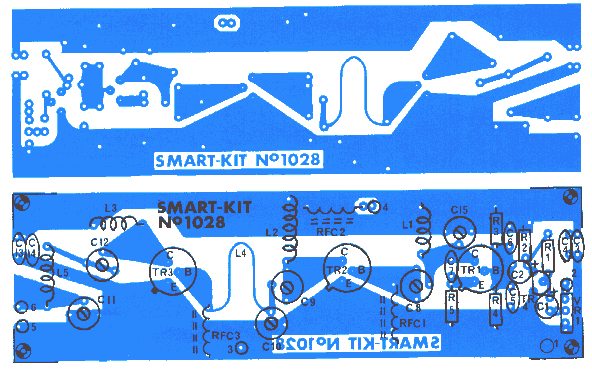

General Description
This is a small but quite powerful FM transmitter having three RF stages incorporating an audio preamplifier for better modulation. t has an output power of 4 Watts and works off 12-18 VDC which makes it easily portable. It is the ideal project for the beginner who wishes to get started in the fascinating world of FM broadcasting and wants a good basic circuit to experiment with.
Technical Specifications – Characteristics
- Modulation type: FM
- Frequency range: 88-108 MHz
- Working voltage: 12-18 VDC
- Maximum current: 450 mA
- Output power: 4 W

This is an RF project and this calls for even more care during soldering as sloppiness during construction can mean low or no output at all, low stability and other problems. Make sure that you follow the general rules about electronic circuit construction outlined above and double-check everything before going to the next step. All the components are clearly marked on the component side of the P.C. board and you should have no difficulty in locating and placing them. Solder first of all the pins, and continue with the coils taking care not to deform them, the RFCs, the resistors, the capacitors and finally the electrolytic and the trimmers. Make sure that the electrolytic are correctly placed with respect to their polarity and that the trimmers are not overheated during soldering. At this point stop for a good inspection of the work done so far and if you see that everything is OK go on and solder the transistors in their places taking grate care not to overheat them as they are the most sensitive of all the components used in the project. The audio frequency input is at points 1 (ground) and 2 (signal), the power supply is connected at points 3 (-) and 4 (+) and the antenna is connected at points 5 (ground) and 6 (signal). As we have already mentioned the signal you use for the modulation of the transmitter could be the output of a preamplifier or mixer or in case you only want to modulate it with voice you can use the piezoelectric microphone supplied with the Kit. (The quality of this microphone is not very good but it is quite adequate if you are interested in speech only.) As an antenna you can use an open dipole or a Ground Plane. Before you start using the transmitter or every time you change its working frequency you must follow the procedure described below which is called alignment.

Electronic Diagram
Also check this site for additional information

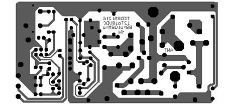

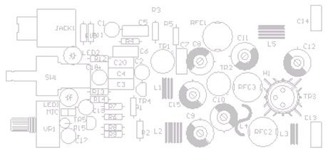

Improvements on original design
Thomas [thomasciciyan @ yahoo.com] made some improvement on original design:
- The ability for capacitor microphone
- Preamplifier for the mic
- External audio input jack, for example: to transmit sounds from a computer audio card
- A selector switch to select microphone or input jack
- PCB redesign
Parts added
C17 (1uf)
C18 (4uf7)
C19 (4uf7)
C20 (100NF)
H1 (13*13*10MM)
JACK1 (STEREO)
LED2 (RED)
MIC (CAPACITIC)
R6 (1M8)
R7 (1K5)
R8 (560K)
R9 (820R)
R10 (4K7)
R11 (4K7)
R12 (1K)
R13 (1K)
R14 (2K2)
R15 (680R)
TR5 (BC547\BC548)
VR1 (50K)
