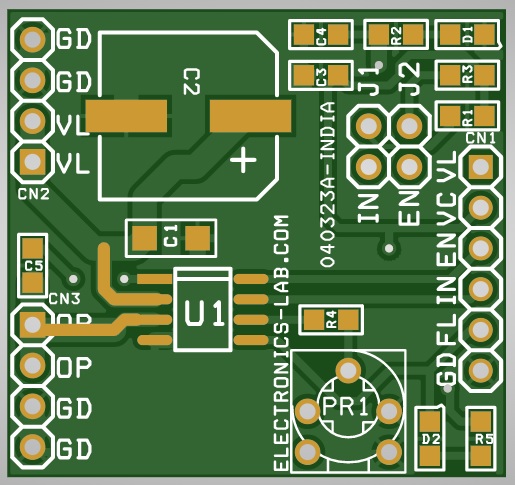

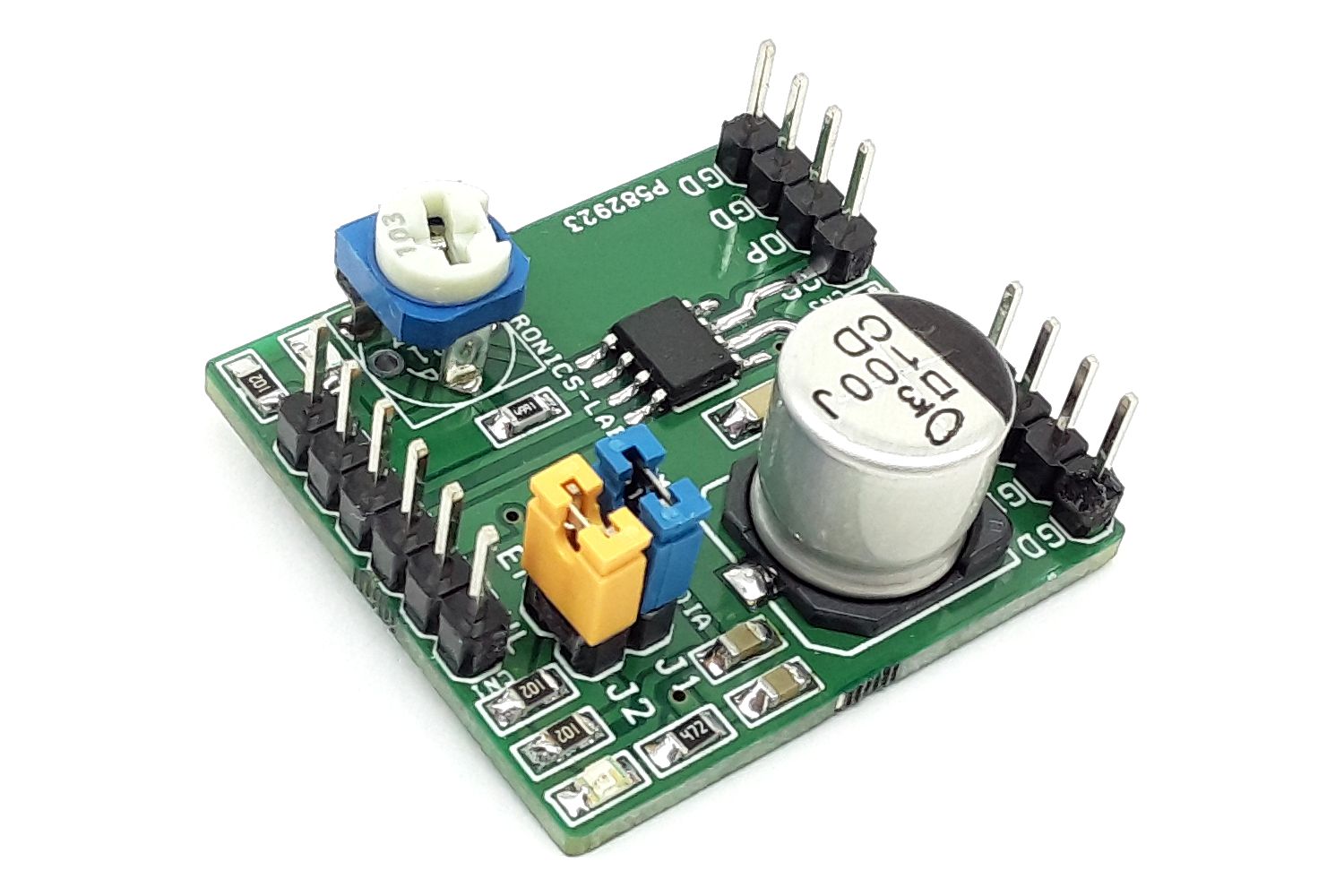

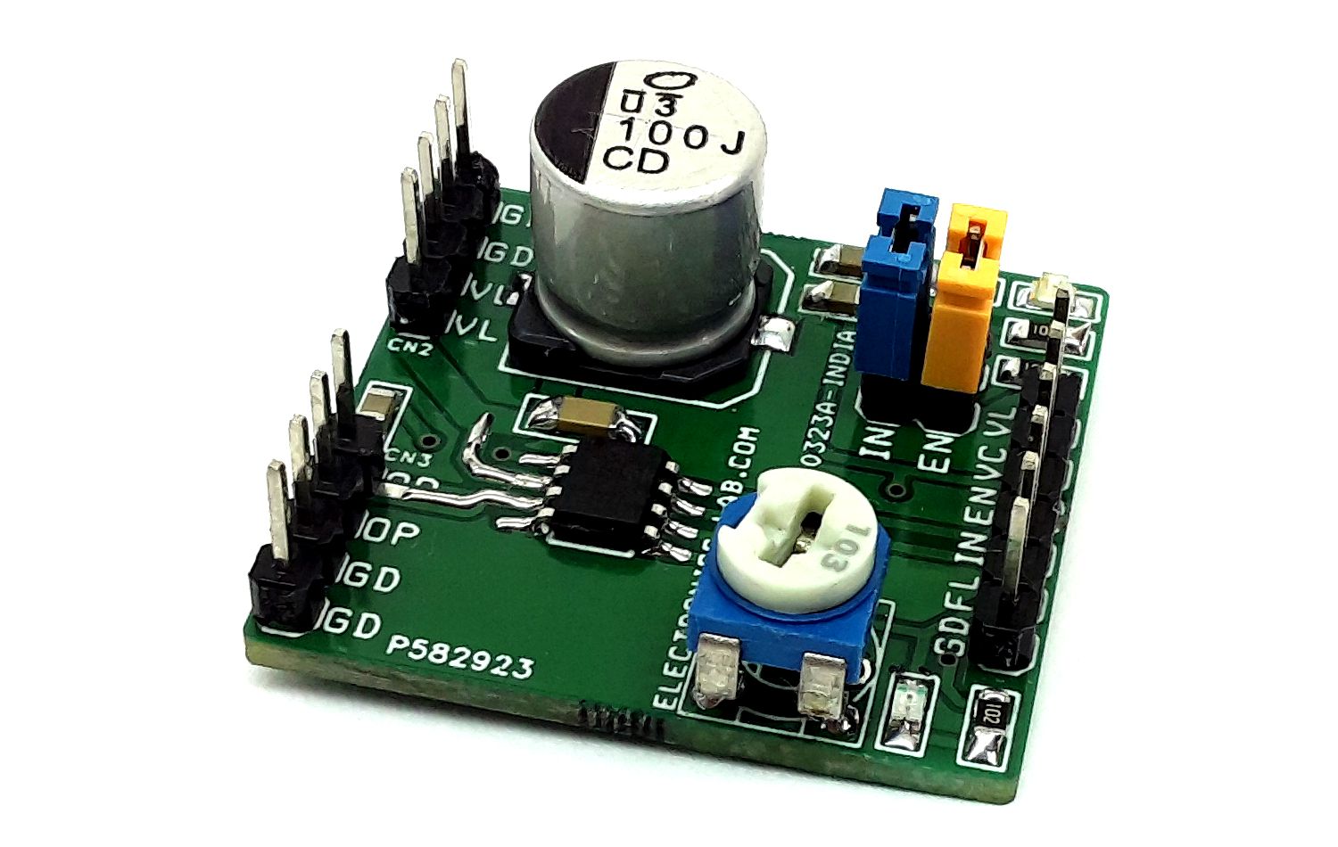

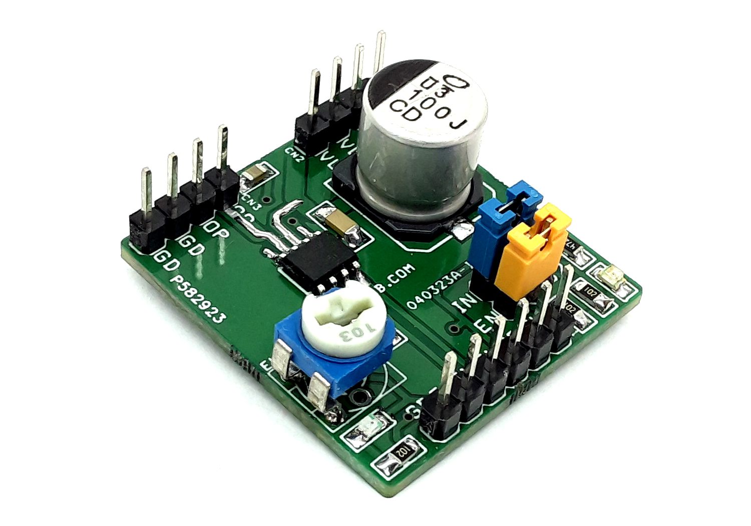

- PCB Dimensions 31.12 x 29.21mm

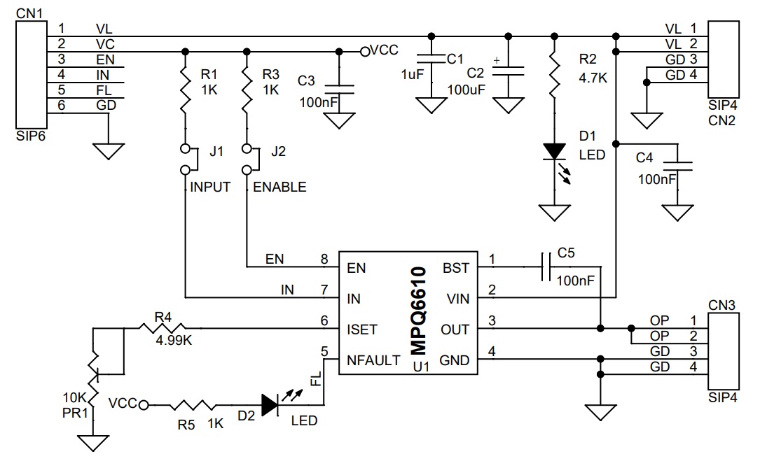

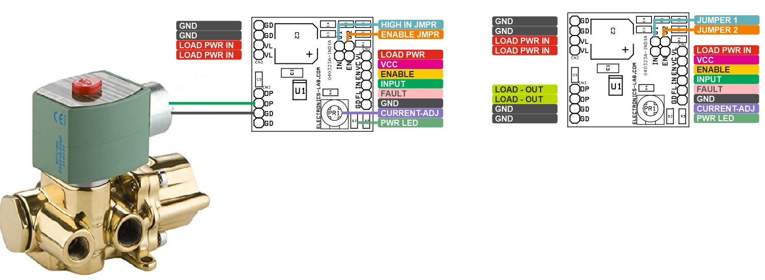

Connections and Other Details
- CN1: Pin 1 = Load Supply, Pin 2 = VCC, Pin 3 = Enable (High=Enable) , Pin 4 = PWM/Logic In, Pin 5 = Fault logic low if a fault condition (e.g. OCP, OTP, or open load occurs, Pin 6 = GND
- CN2: Pin 1 & 2 = Load Supply 5V to 55V DC, Pin 3 & 4 = GND
- CN3: Pin 1 & 2 = Load Output, Pin 3 & 4 = GND
- Jumper J1 = Internal Enable, Don’t Use this Jumper In case External Enable Input CN1 Pin 3 Required
- Jumper J2 = Output Direct Triger, Don’t Use this Jumper In Case External PWM Input CN1 Pin 4 Required
- D1: Power LED
- D2: Fault LED, Glow if a fault condition (e.g. over-current protection [OCP], over-temperature protection [OTP], or open load) occurs
- PR1: Trimmer Potentiometer to Set the Current Limit
Input Logic: Each MOSFET in the MPQ6610 is controlled independently using the IN and EN pins
- Enable Low, In Low Output Hi-Z
- Enable Low, In High Output Hi-Z
- Enable High, In Low Output Low
- Enable High, In High Output High
The input pins are designed such that they can be driven with a logic level voltage even when the main power to the device is inactive.

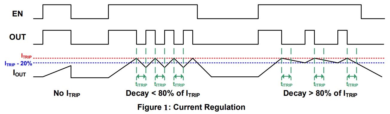

Current Limit and Regulation
The current in the output is limited using constant-off-time (COT) pulse-width modulation (PWM) control circuitry. Figure 1 shows the device’s current regulation system, described below:
- First, a MOSFET turns on and drives current through the load.
- The current increases in the load, which is then sensed by the internal current-sense circuit.
- If the load current reaches the current trip threshold, the output changes its state (if it was driving high, it goes low; if it was driving low, it goes high).
- If the load current has fallen at 80% of the current limit threshold after a fixed off time (tITRIP), the original MOSFET is re-enabled. Then the cycle repeats.
- If the current is still above this level, the off time is extended until the current falls to 80% of the current limit threshold.
The current limit threshold is reached when the ISET pin reaches 1.5V. For example, with a 10kΩ resistor (R4 + PR1) connected from ISET to ground, the ISET pin voltage is 1V/A of output current. Therefore, when the current reaches 1.5A, the ISET pin voltage reaches 1.5V, and a current trip occurs.

Schematic

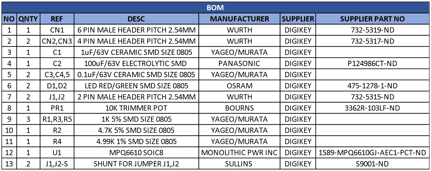

Parts List
| NO | QNTY | REF | DESC | MANUFACTURER | SUPPLIER | SUPPLIER PART NO |
| 1 | 1 | CN1 | 6 PIN MALE HEADER PITCH 2.54MM | WURTH | DIGIKEY | 732-5319-ND |
| 2 | 2 | CN2,CN3 | 4 PIN MALE HEADER PITCH 2.54MM | WURTH | DIGIKEY | 732-5317-ND |
| 3 | 1 | C1 | 1uF/63V CERAMIC SMD SIZE 0805 | YAGEO/MURATA | DIGIKEY | |
| 4 | 1 | C2 | 100uF/63V ELECTROLYTIC SMD | PANASONIC | DIGIKEY | P124986CT-ND |
| 5 | 2 | C3,C4,5 | 0.1uF/63V CERAMIC SMD SIZE 0805 | YAGEO/MURATA | DIGIKEY | |
| 6 | 2 | D1,D2 | LED RED/GREEN SMD SIZE 0805 | OSRAM | DIGIKEY | 475-1278-1-ND |
| 7 | 2 | J1,J2 | 2 PIN MALE HEADER PITCH 2.54MM | WURTH | DIGIKEY | 732-5315-ND |
| 8 | 1 | PR1 | 10K TRIMMER POT | BOURNS | DIGIKEY | 3362R-103LF-ND |
| 9 | 3 | R1,R3,R5 | 1K 5% SMD SIZE 0805 | YAGEO/MURATA | DIGIKEY | |
| 10 | 1 | R2 | 4.7K 5% SMD SIZE 0805 | YAGEO/MURATA | DIGIKEY | |
| 11 | 1 | R4 | 4.99K 1% SMD SIZE 0805 | YAGEO/MURATA | DIGIKEY | |
| 12 | 1 | U1 | MPQ6610 SOIC8 | MONOLITHIC PWR INC | DIGIKEY | 1589-MPQ6610GJ-AEC1-PCT-ND |
| 13 | 2 | J1,J2-S | SHUNT FOR JUMPER J1,J2 | SULLINS | DIGIKEY | S9001-ND |
Connections

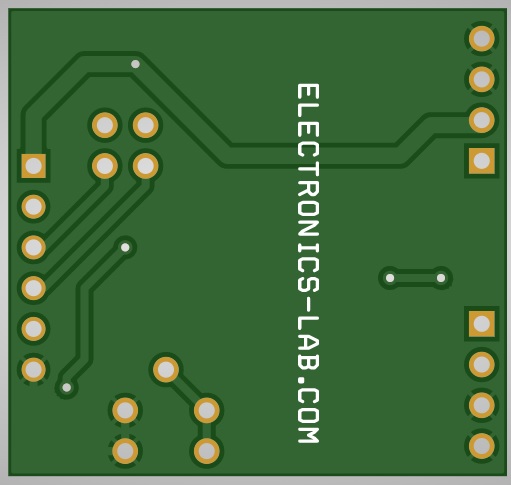

Gerber View
Current Regulation
