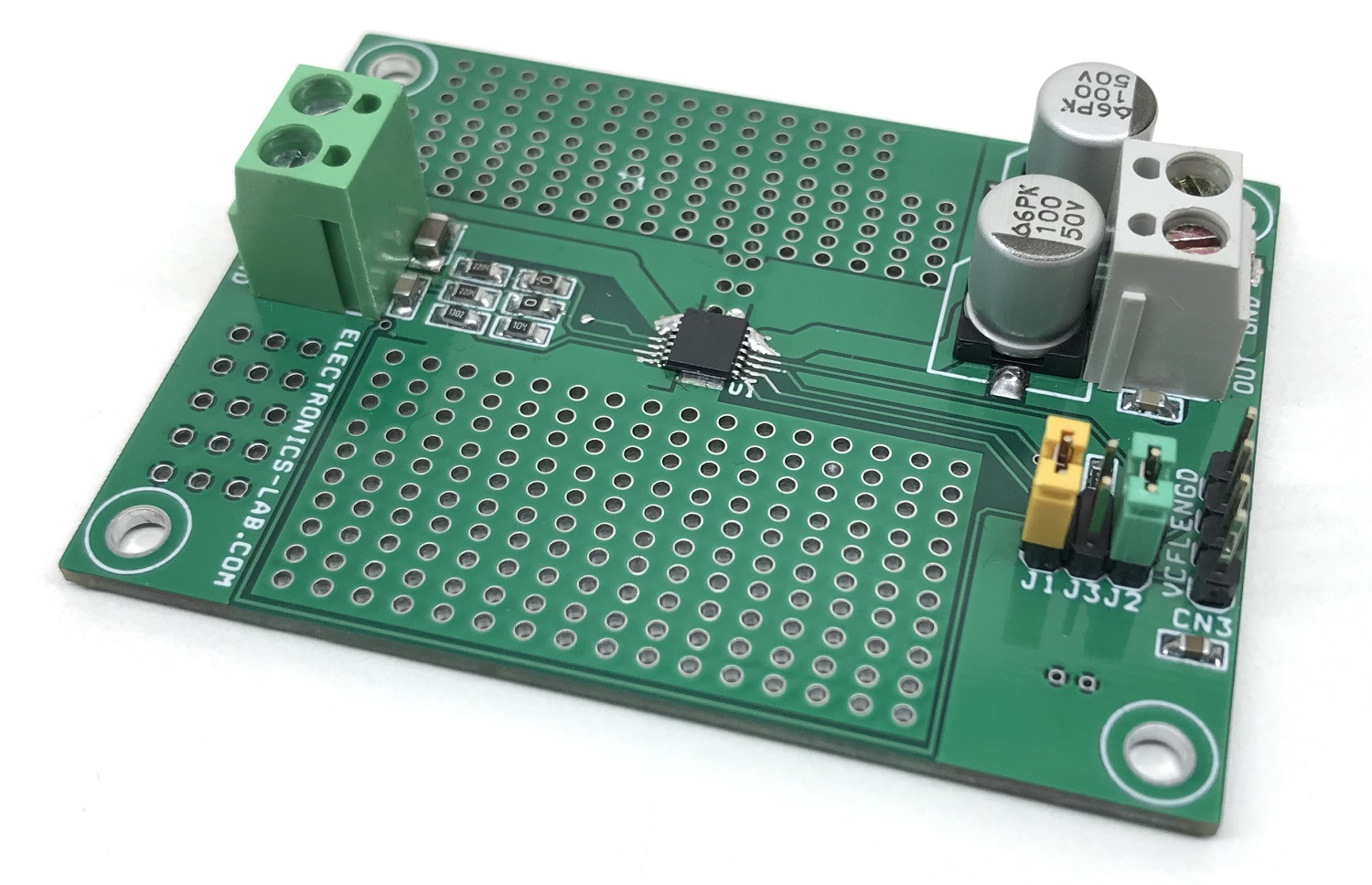

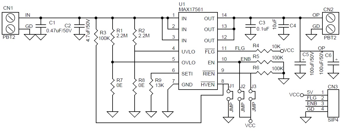

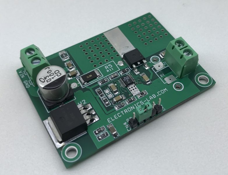

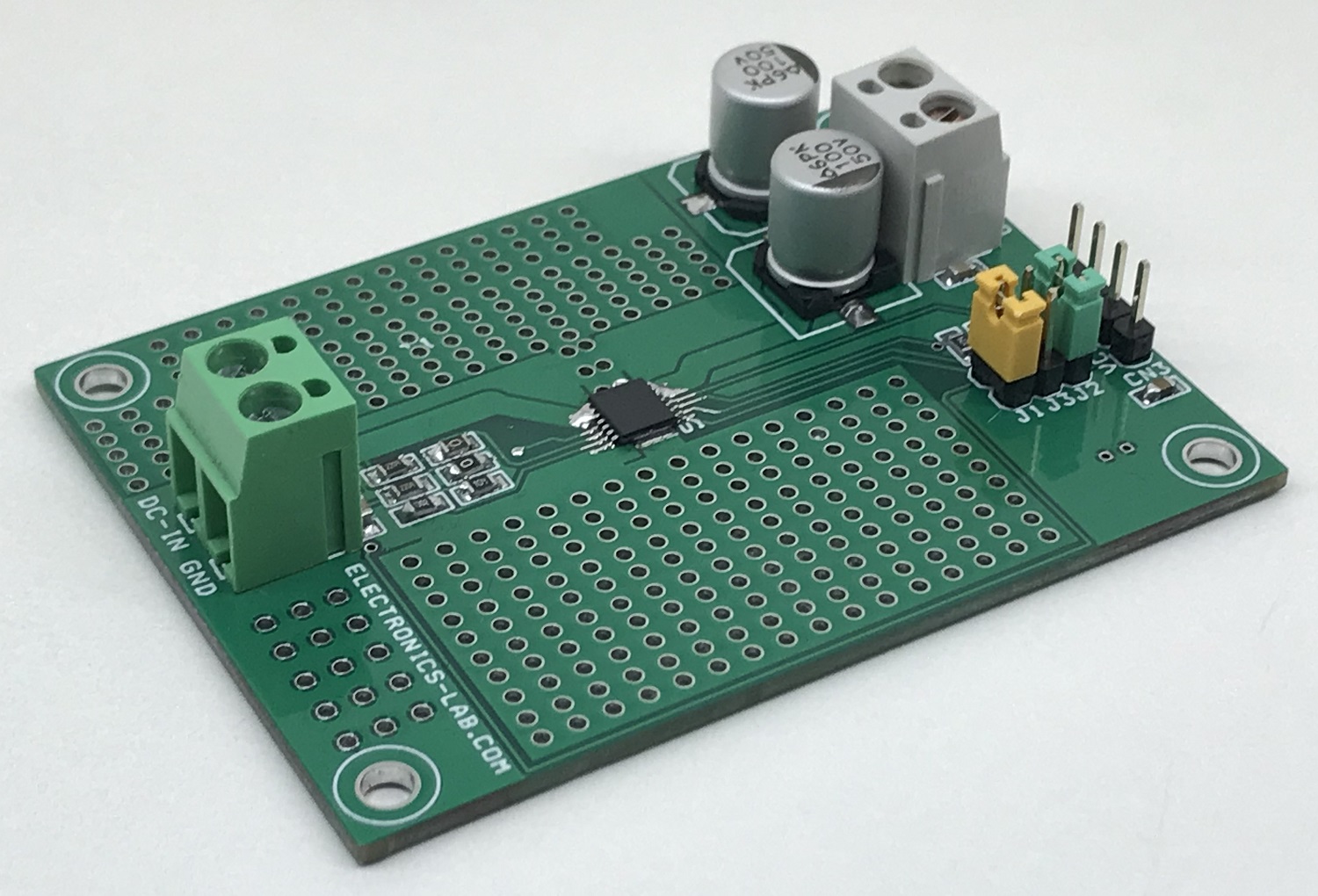

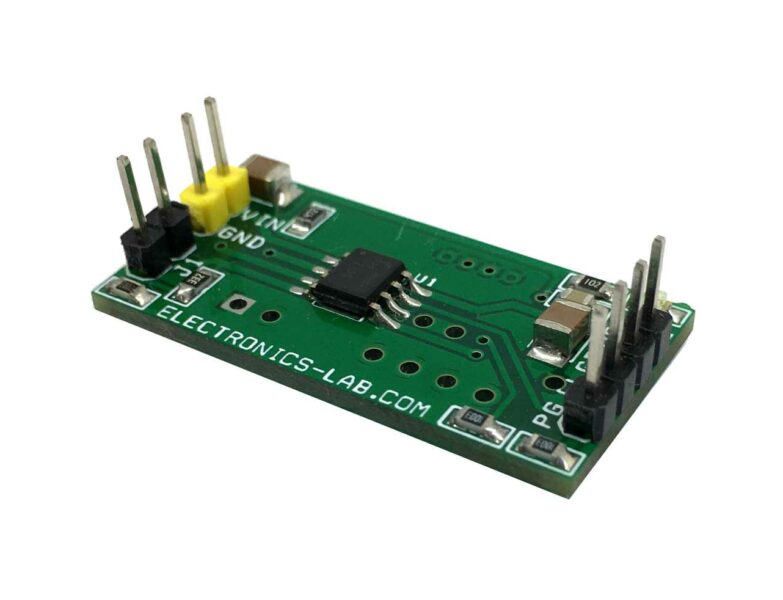

If you need safe power to run your project, then this circuit is a possible solution for you. This project provides protection to your system device against over-current, over-voltage, under-voltage, thermal overload, and reverse current flow control to the system device. Basically, this project can play a key role between the power supply and the sensitive system device, where the system device will be protected against the above conditions. When there is a change other than the set parameters the circuit will disable the output and go in retry mode, until the condition is as per the set value. The project is built using MAX17561 chip. Refer to the datasheet to get further information. Refer to the schematic shown below and have look at some of the panorama of the project explained below.
Important Features:
- Adjustable overvoltage protection range is between 6V and 36V
- Adjustable undervoltage protection range is between 4.5V and 24V

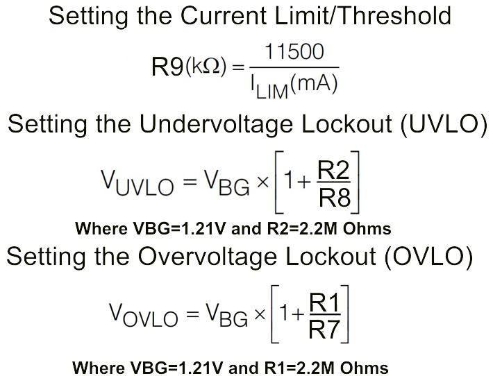

- Overvoltage-lockout (OVLO) thresholds are set using external resistors R1 and R7
- Undervoltage-lockout (UVLO) thresholds are set using external resistors R2 and R8
- Programmable Forward-Current Limit: 0.7A to 4.2A (±15% Accuracy) is set using R9 (R9 13K = Approx. 1Amp)
- Reverse Current Flow Control Input
- Thermal Overload Protection
- Dual Enable Inputs: EN and High Voltage HVEN
- Fault Indicator Output. FLAG goes low when the fault duration exceeds the blanking time, reverse current is detected, the thermal-shutdown mode is active, OVLO threshold is reached, or SET-Current is connected to GND.

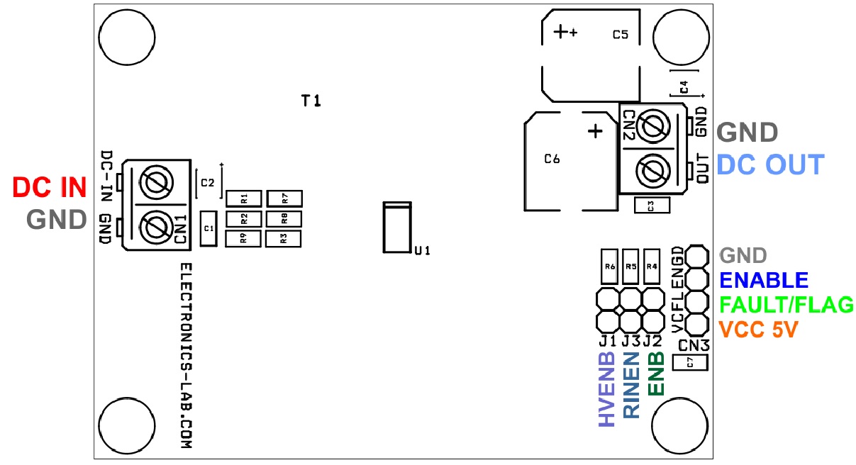

- Reverse-Current Enable Input. Open the Jumper J3 enables reverse-current flow protection. Close the Jumper J3 (RIEN to logic-high) to disable the reverse-current flow protection
- EN: Close the Jumper J2 to enable the input (Active-High Enable Input)
- HVEN: Close the Jumper J1 to activate HVEN High voltage Enable (36V Capable Active-Low Enable Input)

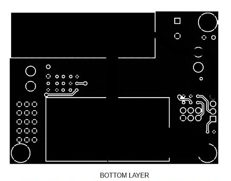

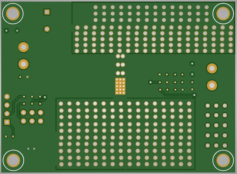

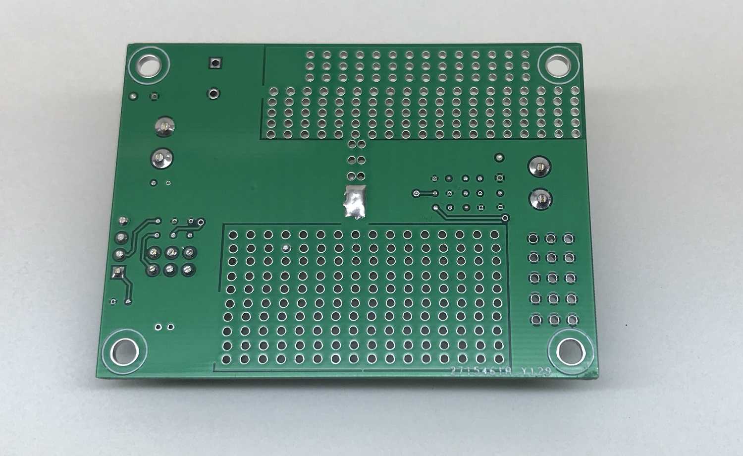

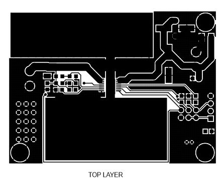

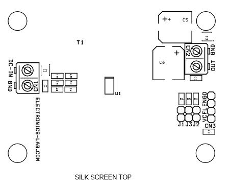

- PCB dimensions: 70.01 x 51.28 mm
Switch Control
There are two independent enable inputs (HVEN and EN) for the devices. HVEN is a high-voltage-capable input. Toggle HVEN or EN to reset the fault condition once a short circuit is detected and the devices shut down.
- Jumper J1 Close, Jumper J2 Open >> Switch Status ON
- Jumper J1 Close, Jumper J2 Close>> Switch Status ON
- Jumper J1 Open, Jumper J2 Close>> Switch Status ON
- Jumper J1 Open, Jumper J2 Open>> Switch Status OFF
- Jumper J3: Open enables reverse-current flow protection. Close the Jumper J3 (RIEN to logic-high) to disable the reverse-current flow protection
Adjusting Parameters
Refer to the figure which explains the formula to set the overvoltage, Under voltage, and Load Curren:

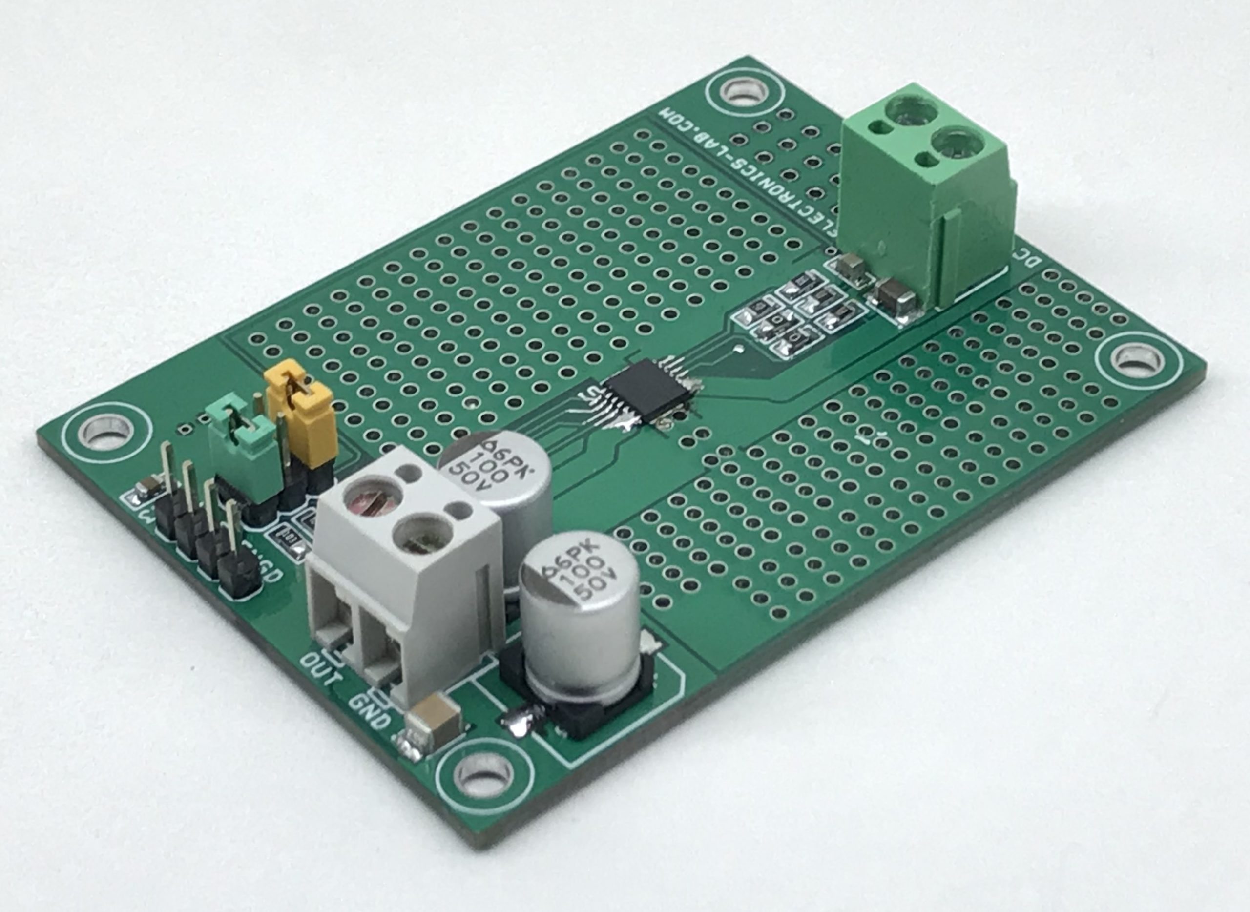

Testing the board
Perform the following steps to test the project, Close Jumper 1 and Jumper 2, connect the voltmeter on output, Connect 5V DC power supply to VCC and GND pin of CN3. Use another variable power supply, adjust the voltage to 19.5V and connect this power supply to input CN1, verify that output is 19.5V DC and Flag pin is high. Gradually increase the DC power supply voltage and verify that OUT voltage goes down and Flag pin is low when input reached approximately 33V. Gradually decrease voltage on the DC power supply and verify that OUT comes back and Flag pin is high again when the input reaches approximately 32V. So the safe range of voltage input is 19.5V to 32V with Load Capacity 1 A. This project can work with a single power supply if Fault/Flag information is not required.
Default internal factory-pre-set internal OVLO threshold is 33V (typ.) and the pre-set internal UVLO threshold is 19.2V (typ.) The current-limit protection is set using R9 to 1A, but current limit protection is programable up to 4.2A, once current reaches the threshold, the MAX17561 turns off the output after the 20.7ms (typ) blanking time and stays off during the retry period.

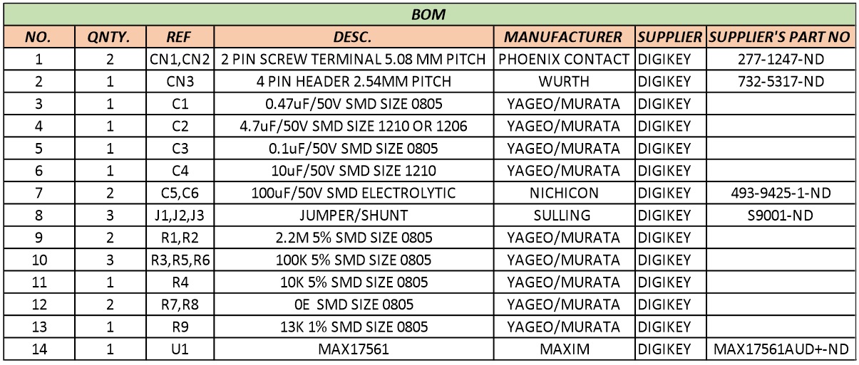

Parts List
| NO. | QNTY. | REF | DESC. | MANUFACTURER | SUPPLIER | SUPPLIER'S PART NO |
| 1 | 2 | CN1,CN2 | 2 PIN SCREW TERMINAL 5.08 MM PITCH | PHOENIX CONTACT | DIGIKEY | 277-1247-ND |
| 2 | 1 | CN3 | 4 PIN HEADER 2.54MM PITCH | WURTH | DIGIKEY | 732-5317-ND |
| 3 | 1 | C1 | 0.47uF/50V SMD SIZE 0805 | YAGEO/MURATA | DIGIKEY | |
| 4 | 1 | C2 | 4.7uF/50V SMD SIZE 1210 OR 1206 | YAGEO/MURATA | DIGIKEY | |
| 5 | 1 | C3 | 0.1uF/50V SMD SIZE 0805 | YAGEO/MURATA | DIGIKEY | |
| 6 | 1 | C4 | 10uF/50V SMD SIZE 1210 | YAGEO/MURATA | DIGIKEY | |
| 7 | 2 | C5,C6 | 100uF/50V SMD ELECTROLYTIC | NICHICON | DIGIKEY | 493-9425-1-ND |
| 8 | 3 | J1,J2,J3 | JUMPER/SHUNT | SULLING | DIGIKEY | S9001-ND |
| 9 | 2 | R1,R2 | 2.2M 5% SMD SIZE 0805 | YAGEO/MURATA | DIGIKEY | |
| 10 | 3 | R3,R5,R6 | 100K 5% SMD SIZE 0805 | YAGEO/MURATA | DIGIKEY | |
| 11 | 1 | R4 | 10K 5% SMD SIZE 0805 | YAGEO/MURATA | DIGIKEY | |
| 12 | 2 | R7,R8 | 0E SMD SIZE 0805 | YAGEO/MURATA | DIGIKEY | |
| 13 | 1 | R9 | 13K 1% SMD SIZE 0805 | YAGEO/MURATA | DIGIKEY | |
| 14 | 1 | U1 | MAX17561 | MAXIM | DIGIKEY | MAX17561AUD+-ND |
| 15 | 1 | C7 | 100nF SMD 0805 (OPTIONAL) | YAGEO/MURATA | DIGIKEY |
