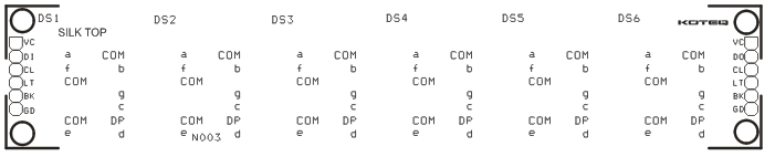

  • 6 Digit 1 inch 7Segment Display
  • Supply Input 3V to 5.5V
  • Serial interface up to 25 MHz clock frequency
  • LED current 20mA (Range from 2 mA to 100)
  • LED current set by external RSET resistor
  • 300 mV LED dropout at 30 mA
  • Thermal shutdown protection
  • R1,R2,R3 Current Set Resistors
LED Current Set Formula
  • LED Current = 50X1.2/Rset ,
  • Rset = R1, R2, R3
CN1 : Connector
  • PIN1 : 3V TO 5.5V (VCC)
  • PIN2 : SIN (DI) Serial Data Input
  • PIN3 : CLK (CL) Serial Clock Input
  • PIN4 : Latch (LT) Latch Data Input
  • PIN5 : Blank (BK) LED Channel enable disable input
  • PIN6 : GND
CN2 : Serial Data Output
  • PIN2 : Sout (Do) Serial Data output
  • PIN3 : CLK (CL) Serial Clock output
  • PIN4 : Latch (LT) Latch Data output
  • PIN6 : GND
