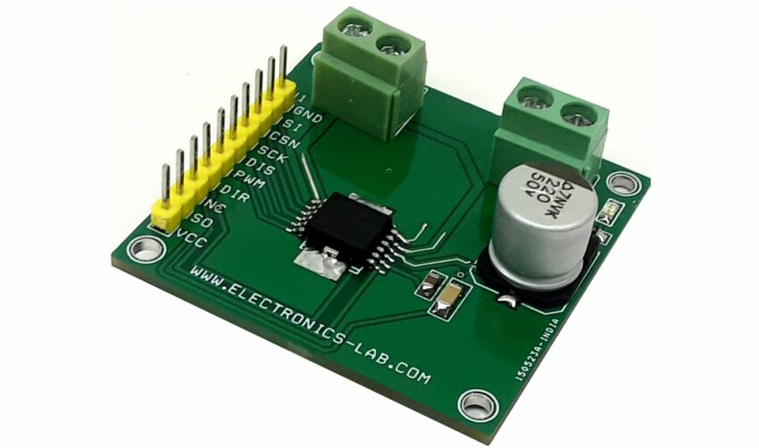

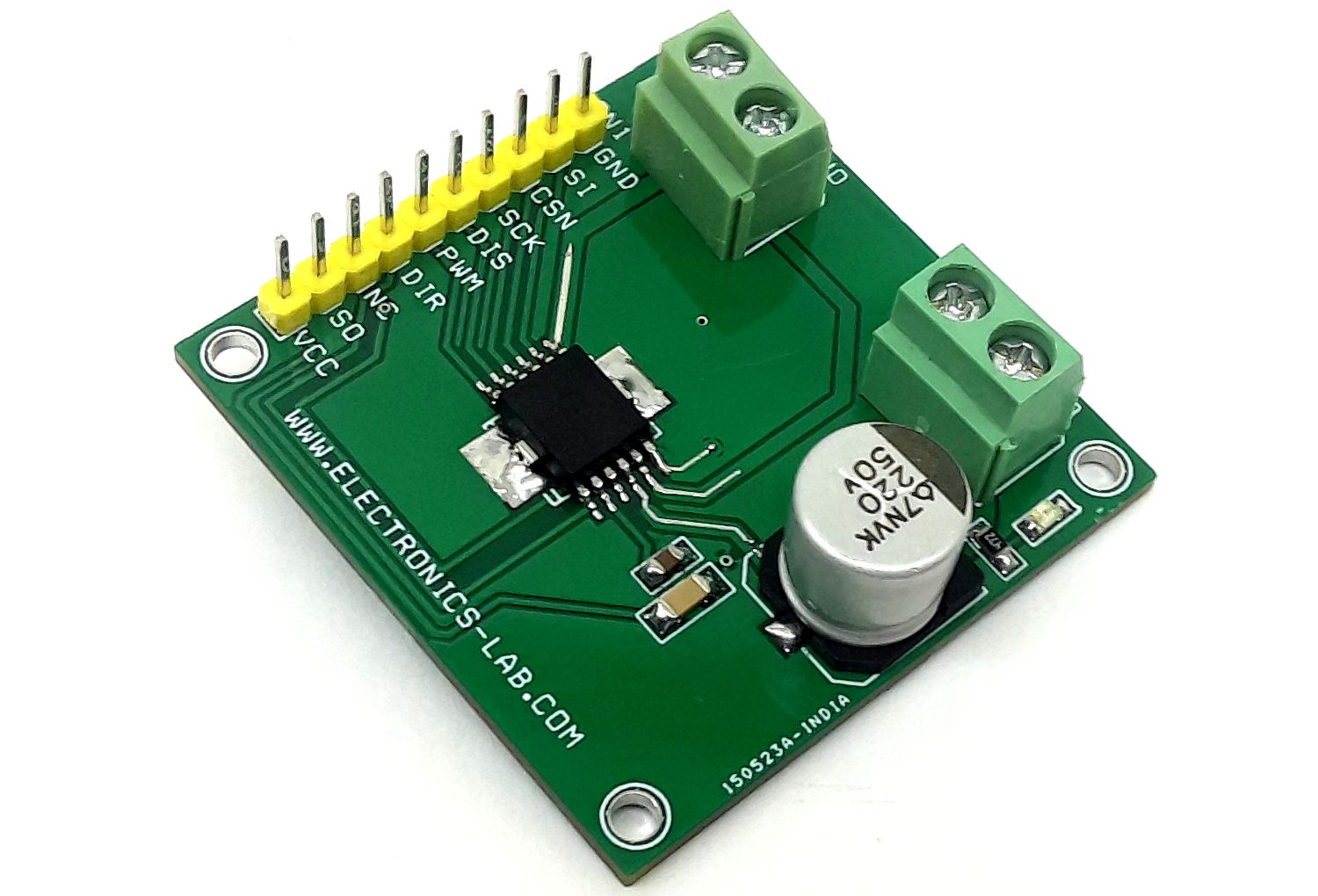

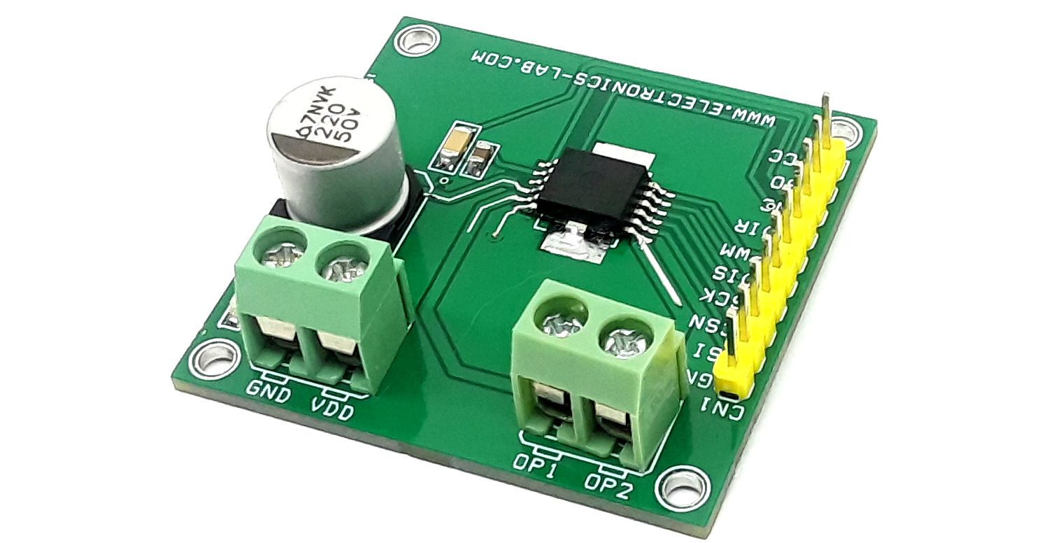

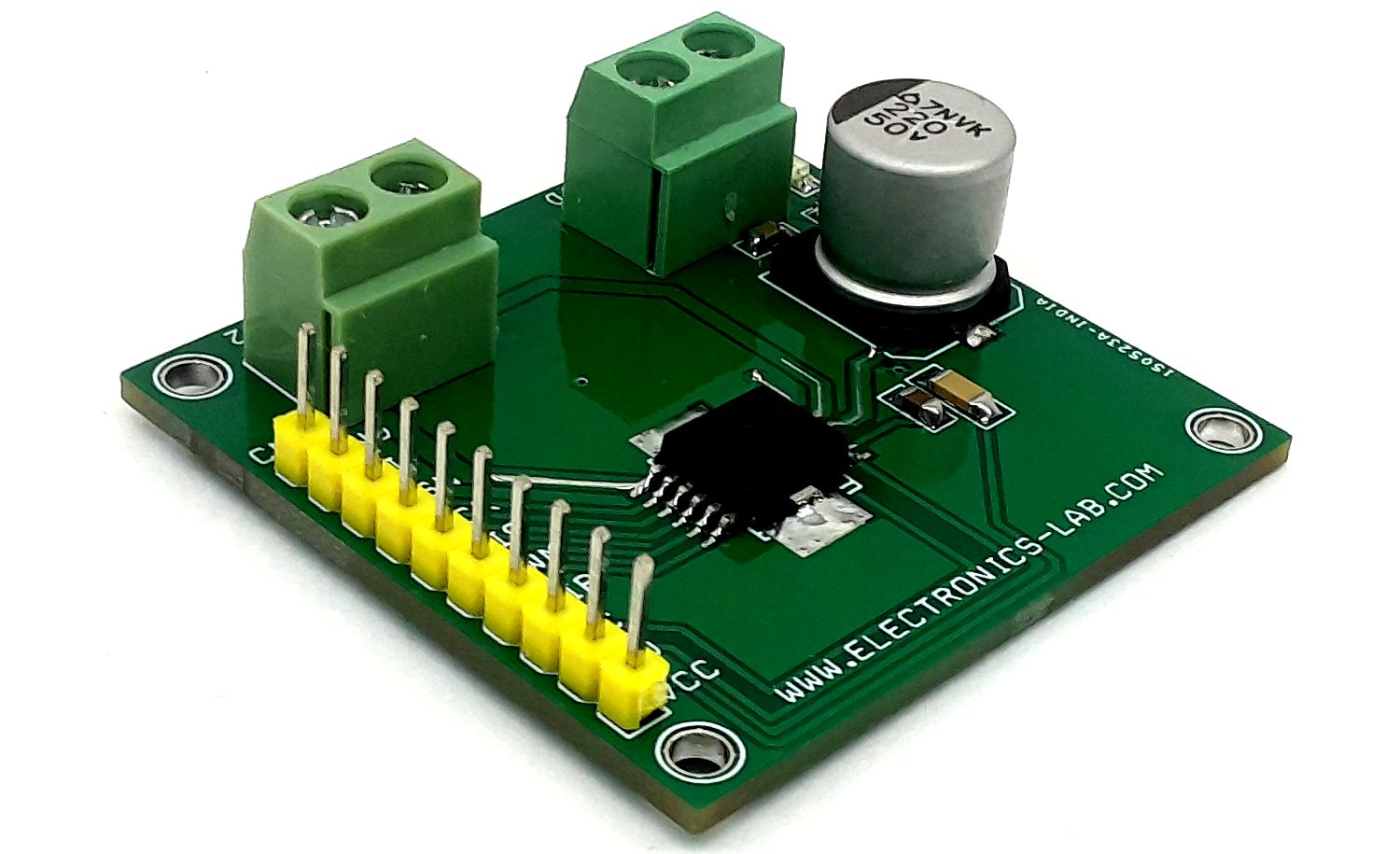

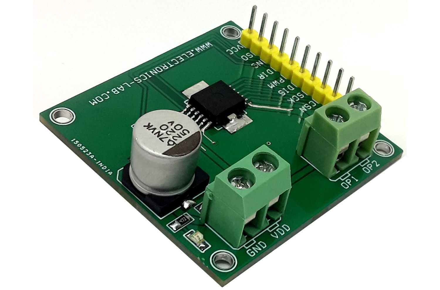

6A H-Bridge with PWM-DIR input and SPI Interface
This 6A H-Bridge is designed for the control of DC motors or other inductive loads. The outputs can be pulse width modulated at frequencies up to 20kHz.

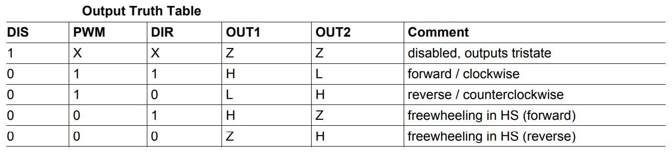

This 6A H-Bridge is designed for the control of DC motors or other inductive loads. The outputs can be pulse width modulated at frequencies up to 20kHz. PWM/DIR control reduces the number of PWM-capable pins needed on the microcontroller side. For load currents above the current limitation threshold (8A typ.) the H-Bridge goes into chopper current limitation mode. It is protected against short circuits and overtemperature and provides extensive diagnosis via SPI or basic feedback via an error flag. An open load can be detected when the bridge is disabled or during the PWM operation of inductive loads. The project is controlled using the inputs PWM and DIR. The signal at DIR is defining the direction of the driven DC motor whereas the PWM signal sets the duty cycle. The outputs can be set tristate (i.e. high side and low side switches are turned off) by setting DIS to high level.
Selecting a DC motor
The board can drive small DC motors with peak currents of up to 6 A. The achievable continuous drive current is lower and depends on supply voltage, switching frequency, and cooling conditions. Realistic continuous drive currents for this project are in the range of 1 A to 2.5 A. Many motors for toys, RC models, or robotics fall in this range.
- Power Supply for the Load 8V to 30V DC (Max 36V)
- RDSon of 100 mΩ per switch typ. at Tj=25 °C
- Logic inputs 3.3 V and 5.0 V TTL/CMOS-compatible
- PWM Frequency up to 20Khz, Duty Cycle 0 to 100%
- PWM and DIR signal 3.3V to 5V Level
- Low standby current
- Chopper current limitation
- Short circuit shut down with latch behavior
- Overtemperature shut down with latch behavior
- VS undervoltage shutdown
- Open load detection in ON and OFF state
- Detailed SPI diagnosis or simple error flag

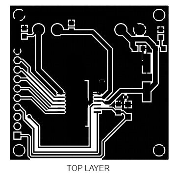

- PCB Dimensions 43.18 x 41.91 mm
- 4 x 2.5 mm Mounting Holes

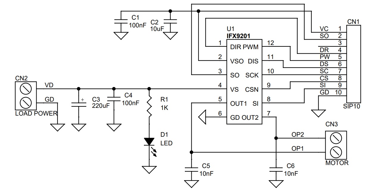

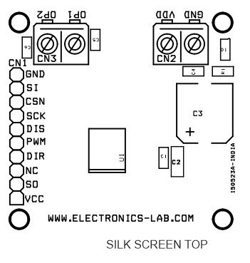

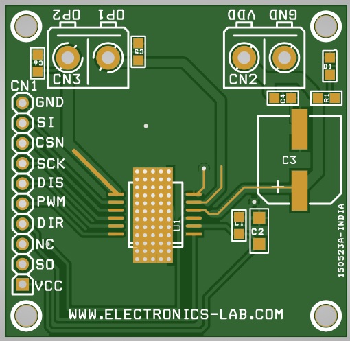

Connections CN1
- Pin 1 VCC 3.3V-5V
- Pin 2 SO SPI Serial Output
- Pin 3 NC (Not Connected)
- Pin 4 Direction Control Input
- Pin 5 PWM Input (For Motor Speed Control), Frequency up to 20Khz, PWM Duty Cycle 0 to 100%
- Pin 6 Disable (Disable the Outputs)
- Pin 7 SPI Clock Input
- Pin 8 SPI Chip Select
- Pin 9 SPI Serial In
CN2: Pin 1 = Load Power Supply Input 8V to 30V DC, Pin 2 = GND
CN3: Pin 1 = Output 1, Pin 2 = Output 2 (DC Motor Connection)
D1: Power LED
Schematic

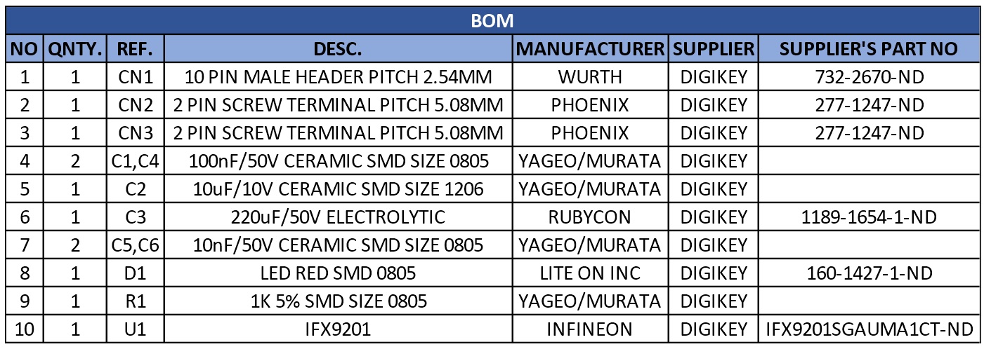

Parts List
| NO | QNTY. | REF. | DESC. | MANUFACTURER | SUPPLIER | PART NO |
| 1 | 1 | CN1 | 10 PIN MALE HEADER PITCH 2.54MM | WURTH | DIGIKEY | 732-2670-ND |
| 2 | 1 | CN2 | 2 PIN SCREW TERMINAL PITCH 5.08MM | PHOENIX | DIGIKEY | 277-1247-ND |
| 3 | 1 | CN3 | 2 PIN SCREW TERMINAL PITCH 5.08MM | PHOENIX | DIGIKEY | 277-1247-ND |
| 4 | 2 | C1,C4 | 100nF/50V CERAMIC SMD SIZE 0805 | YAGEO/MURATA | DIGIKEY | |
| 5 | 1 | C2 | 10uF/10V CERAMIC SMD SIZE 1206 | YAGEO/MURATA | DIGIKEY | |
| 6 | 1 | C3 | 220uF/50V ELECTROLYTIC | RUBYCON | DIGIKEY | 1189-1654-1-ND |
| 7 | 2 | C5,C6 | 10nF/50V CERAMIC SMD SIZE 0805 | YAGEO/MURATA | DIGIKEY | |
| 8 | 1 | D1 | LED RED SMD 0805 | LITE ON INC | DIGIKEY | 160-1427-1-ND |
| 9 | 1 | R1 | 1K 5% SMD SIZE 0805 | YAGEO/MURATA | DIGIKEY | |
| 10 | 1 | U1 | IFX9201 | INFINEON | DIGIKEY | IFX9201SGAUMA1CT-ND |

Truth Table
