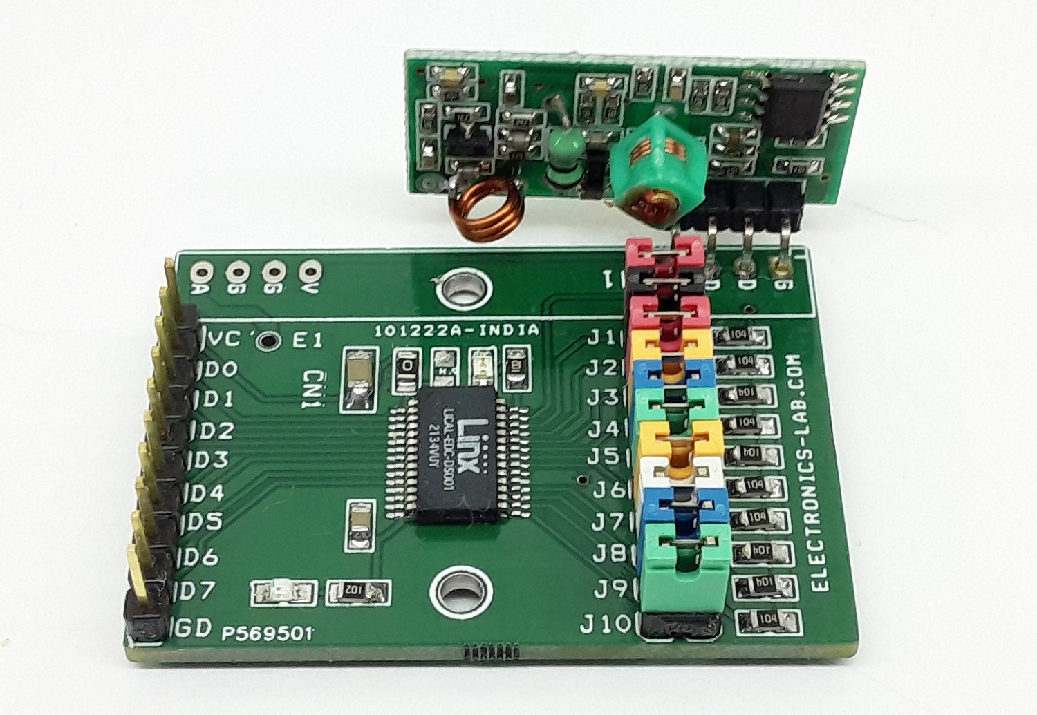

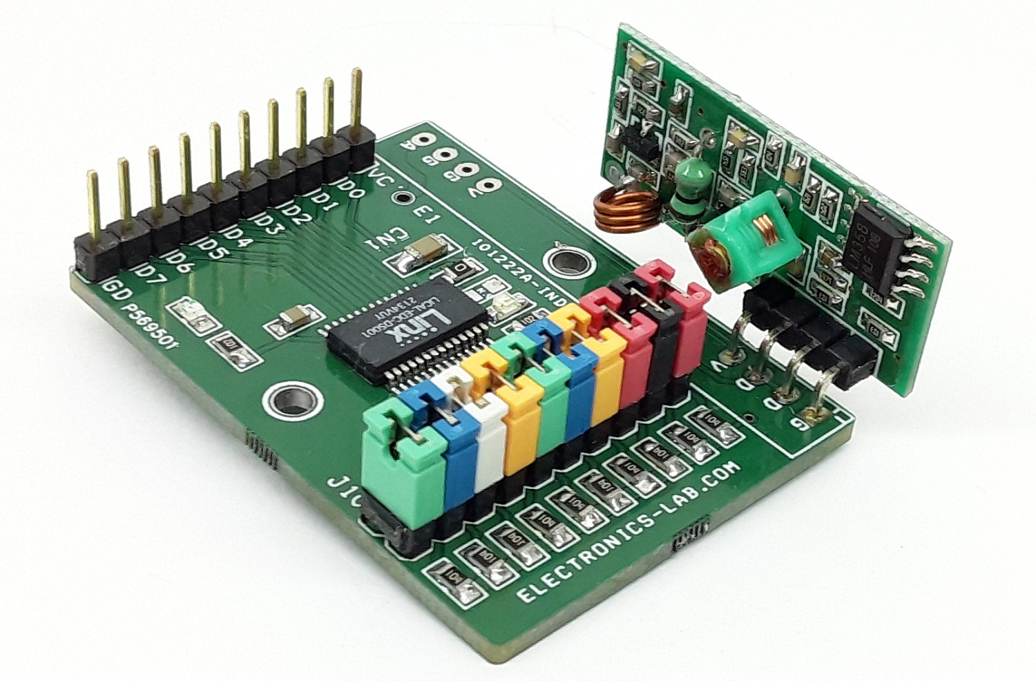

The project described here is 8 Channel RF Remote Receiver (Decoder). This 8-channel decoder is built using LICAL-EDC-DS001 chip from LINX.

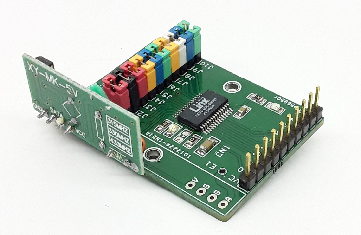

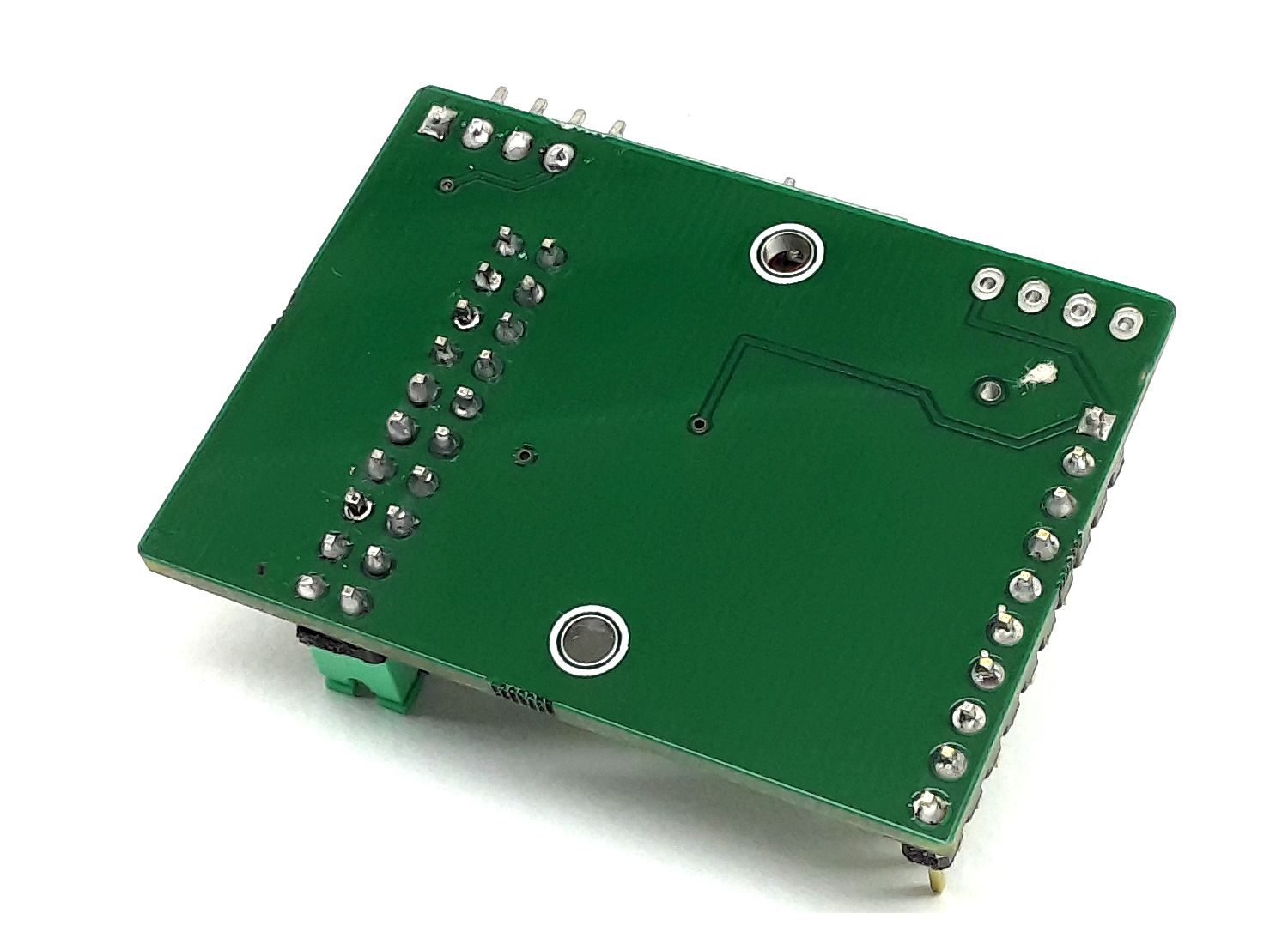

The project described here is 8 Channel RF Remote Receiver (Decoder). This 8-channel decoder is built using LICAL-EDC-DS001 chip from LINX. The board consists of the encoder/Decoder chip, 433Mhz RF Receiver module, and 10 x jumpers to set the address. Also, there is a header connector for data output which is ideal for controlling external devices, for example, relays. All outputs are compatible with TTL logic, normally they are low and go high when a valid signal is received and decoded by the chip. D2 onboard Power LED, D1 LED indicates valid transmission signal. All outputs are momentary (not latching)

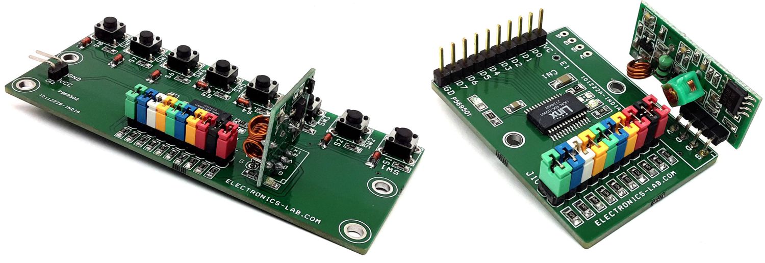

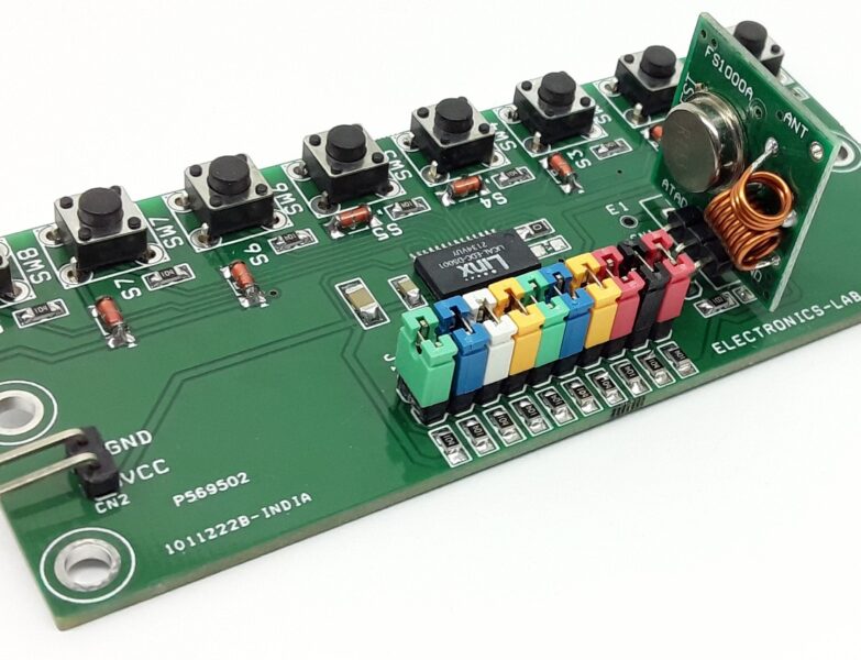

- The project is compatible with the 8 Channel RF Remote Transmitter published on our website.
- Supply 5V DC
- 10 Address Lines Selected through Jumpers J1 to J10
- 8 Data Output TTL Compatible Normally Low (Momentary)
- On Board Power LED
- On Board VT LED (Valid Transmission)

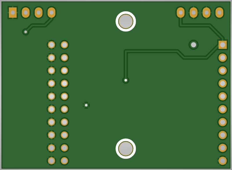

- PCB Dimensions 45.09 x 33.02 mm
- 2 x 2.5mm Mounting Holes

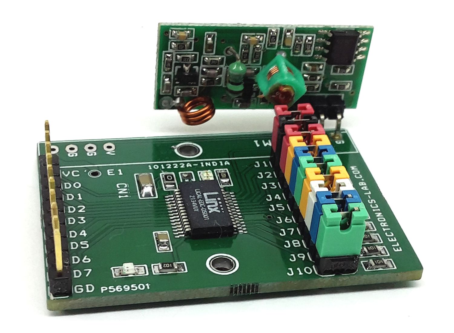

Setting the Address

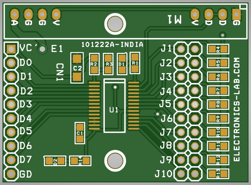

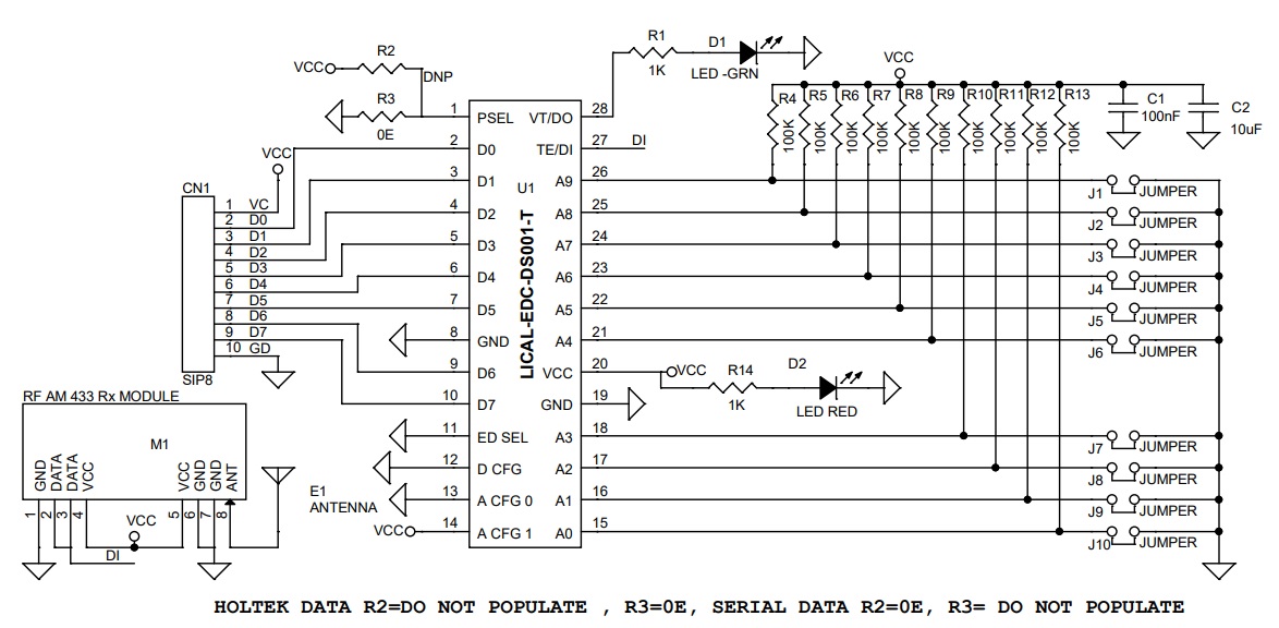

The project has ten address lines. This allows the formation of up to 1,022 (210 – 2) unique transmitter-receiver relationships, Jumper J1 to J10 can be used to set the address, all lines are pulled high. The chip rejects packets with addresses set to all high or all low. At least one address line must be different from the rest. The encoder does transmit all addresses, but the decoder rejects packets with all address lines set the same. The receiver’s address line states must match the transmitter’s exactly for a transmission to be recognized. If the addresses do not match, then the decoder takes no action.

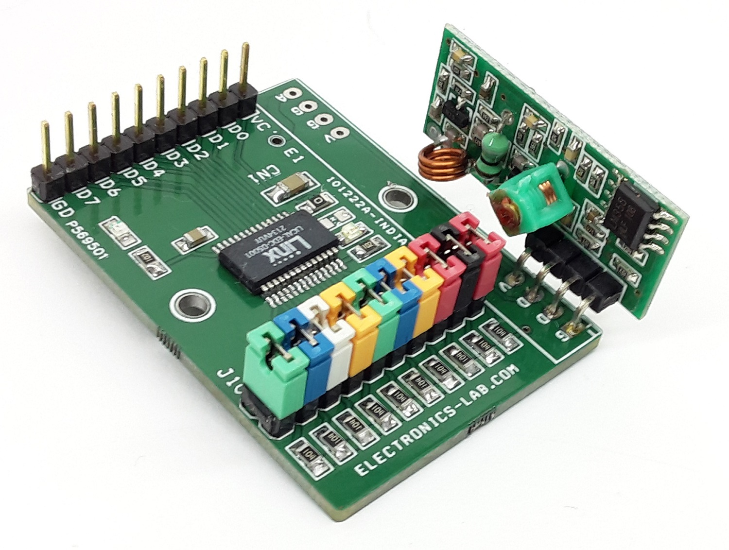

Connections and Other Information

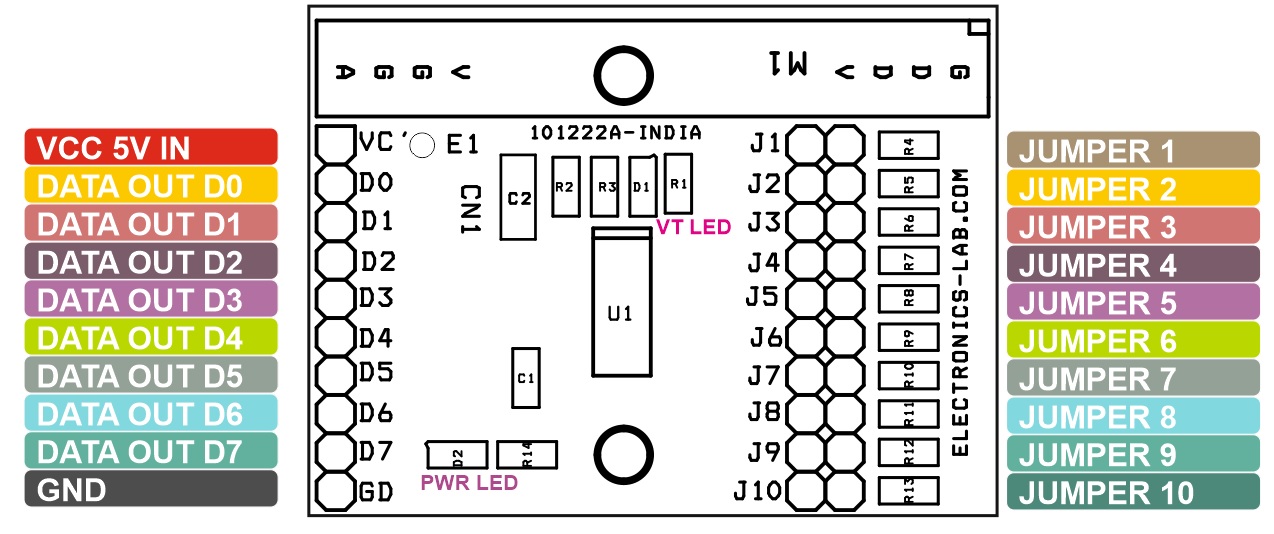

- Connections and Other Details

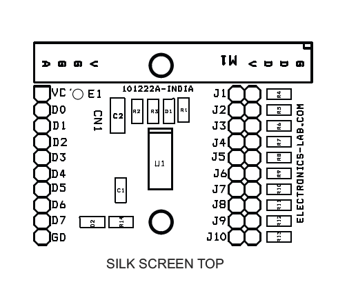

- CN1: Pin 1 = VCC 5V In, Pin 2 = D0, Pin 3 = D1, Pin 4 = D2, Pin 5 = D3, Pin 6 = D4, Pin 7 = D5, Pin 8 = D6, Pin 9 = D7, Pin 10 GND
- D1: Valid Signal LED
- D2: Power LED
- Jumper: J1 to J10 for Address Configuration
- For Serial Protocol R2 = 0 Ohms, R3 Omit, For Holtek Protocol R3= 0 Ohms and R2 Omit (Read Data sheet of chip for Serial/Holtek Protocol)
