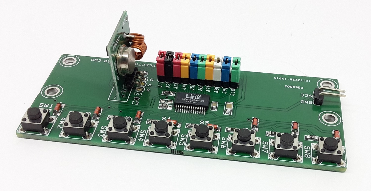

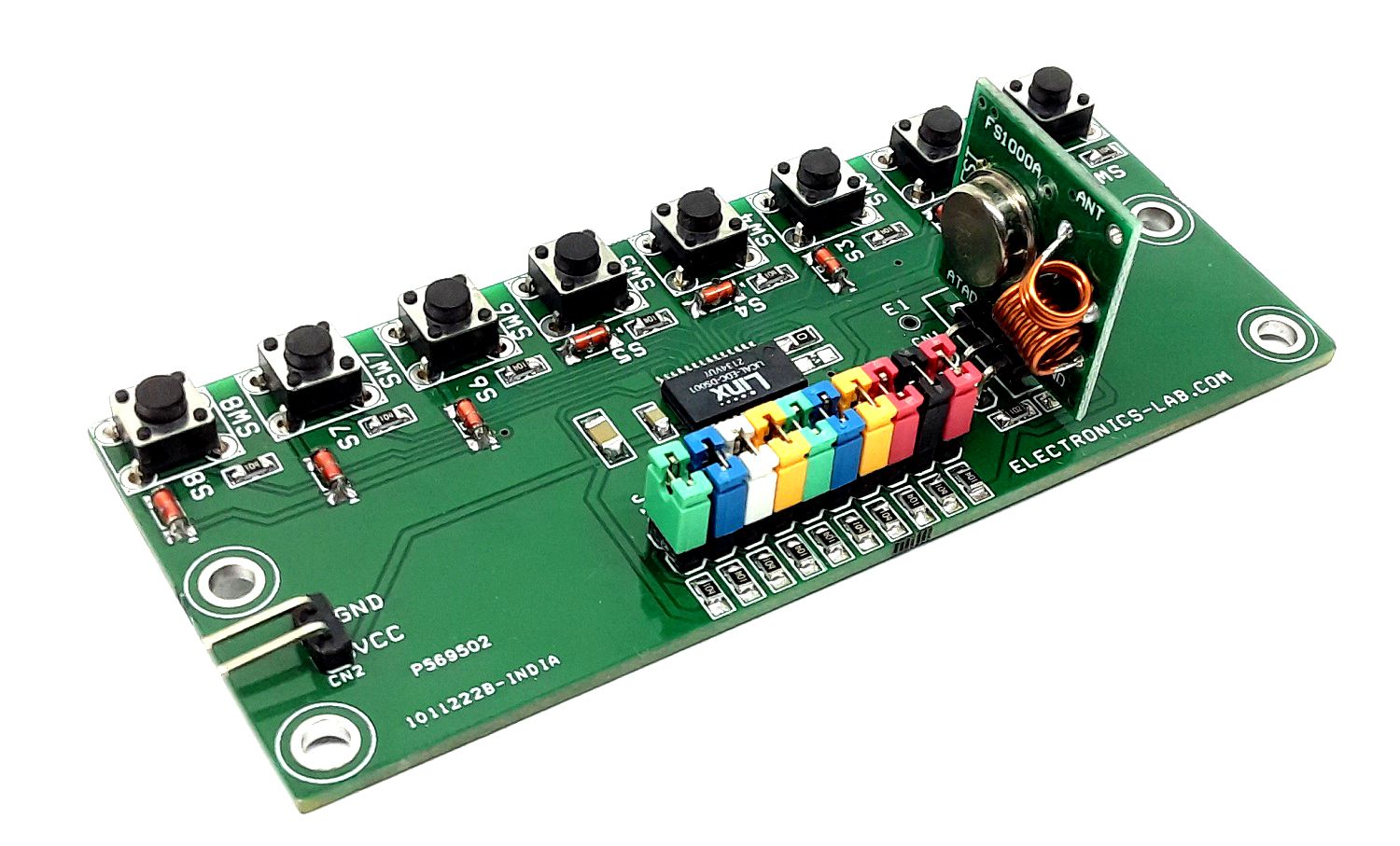

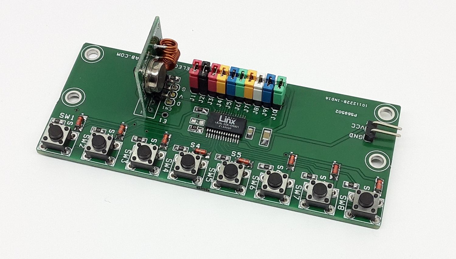

8 Channel RF Remote Transmitter with Holtek and Serial Protocol

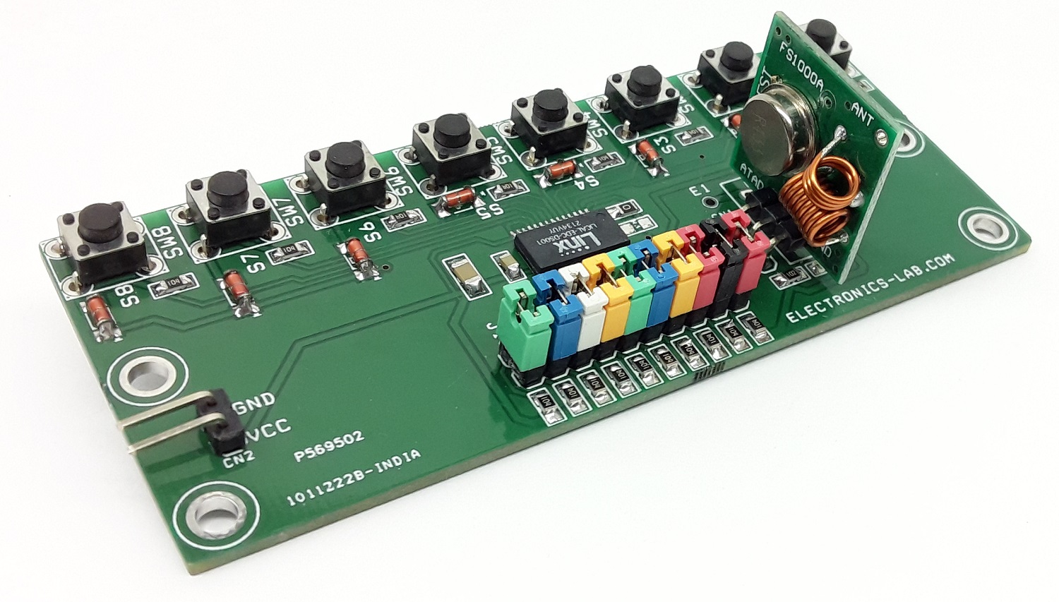

The project described here is an 8 Channel RF remote transmitter This transmitter is built using LICAL-EDC-DS001 chip from LINX. The project consists of the Encoder/Decoder chip, a 433Mhz RF module as a wireless link, 8 x tactile switches for operations, 10 x jumpers to set the transmitter address.
The project described here is an 8 Channel RF remote transmitter This transmitter is built using LICAL-EDC-DS001 chip from LINX. The project consists of the Encoder/Decoder chip, a 433Mhz RF module as a wireless link, 8 x tactile switches for operations, 10 x jumpers to set the transmitter address. This DS series decoder/encoder chip is ideal for remote control applications. It is able to transmit the status of up to 8 buttons across a wireless link. Addressing is accomplished by the logic state of 10 Jumpers J1 to J10.

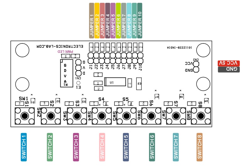

Setting the Address
The project has ten address lines. This allows the formation of up to 1,022 (210 – 2) unique transmitter-receiver relationships, Jumper J1 to J10 can be used to set the address, all lines are pulled high. The chip rejects packets with addresses set to all high or all low. At least one address line must be different from the rest. The encoder does transmit all addresses, but the decoder rejects packets with all address lines set the same. The receiver’s address line states must match the transmitter’s exactly for a transmission to be recognized. If the addresses do not match, then the decoder takes no action.

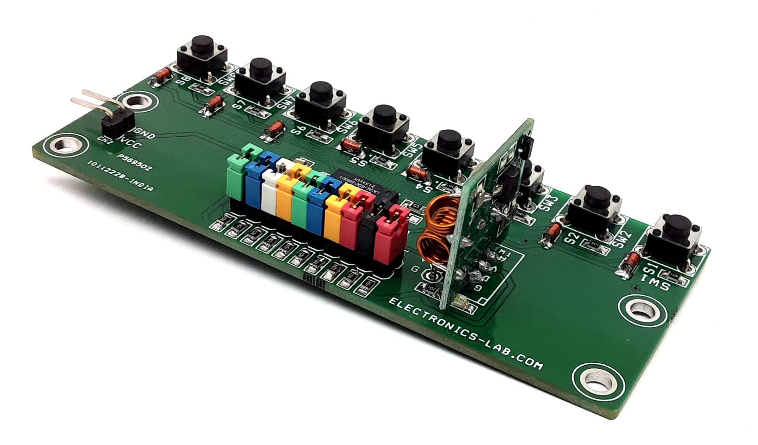

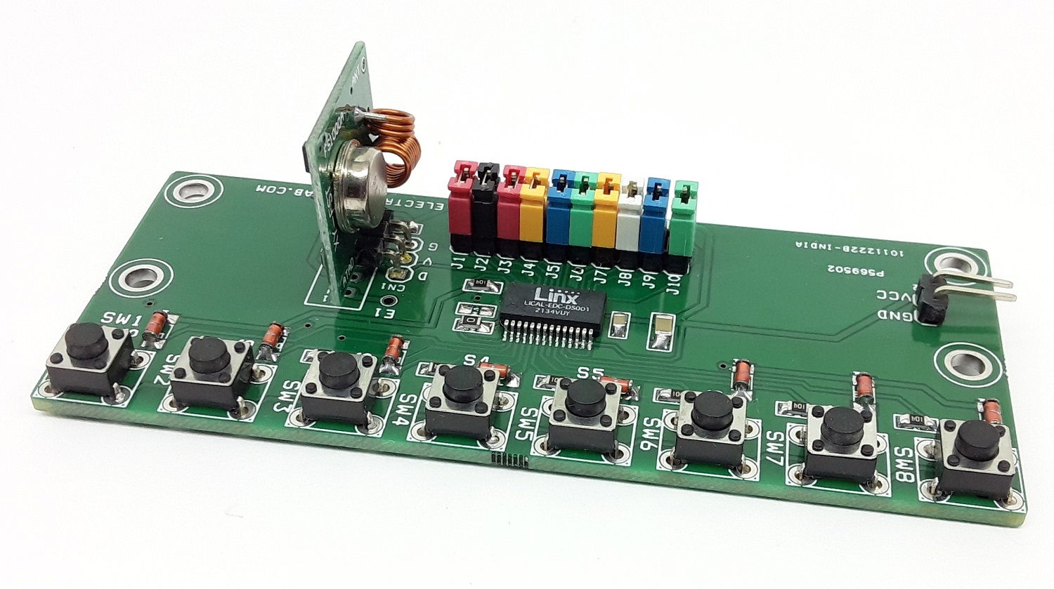

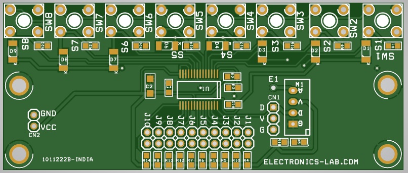

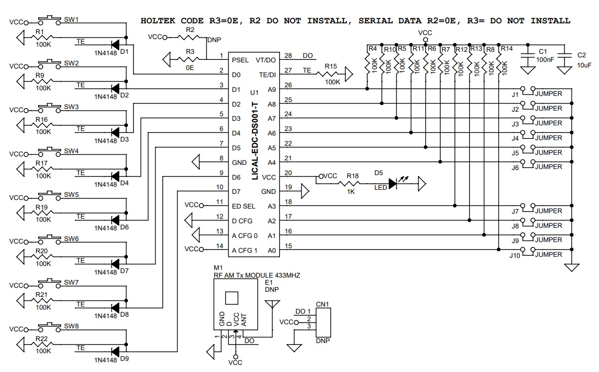

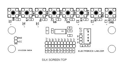

  • Sw1 to Sw8 = Function Switches
  • CN2= PIN 1 = VCC 5V DC, PIN 2 = GND
  • Jumper J1 to J10 = For Address Configuration (should be the same for Transmitter and Receiver)
  • D5 Power LED
  • Transmitter PCB can accommodate 2 Types of RF Modules: 3 Pins CN1 or M1 4 Pin Module.
  • For Serial Protocol R2 = 0 Ohms, R3 Omit, For Holtek Protocol R3= 0 Ohms and R2 Omit (Read the datasheet of the chip for Serial/Holtek Protocol)
  • Supply 5V DC
  • 10 Address Lines Selected through Jumpers J1 to J10
  • 8 X Tactile Switches (8 Data Lines)
  • On Board Power LED

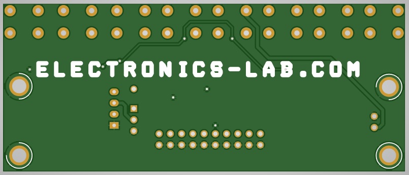

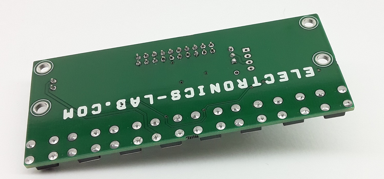

  • PCB Dimensions 90.81 x 38.10 mm
  • 4 x 2.5MM Mounting Holes
Schematic

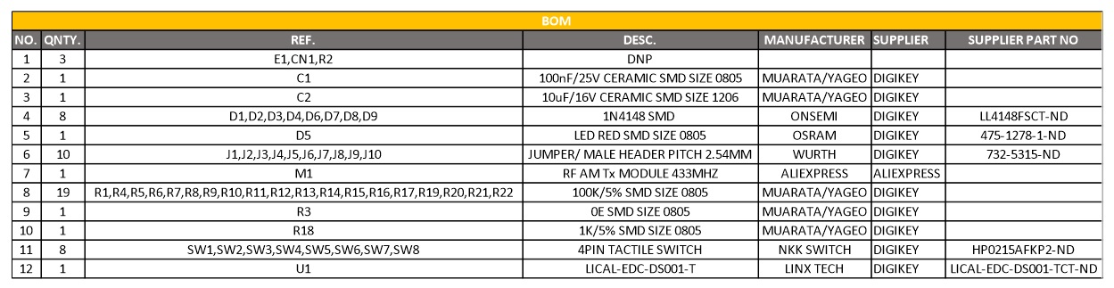

Parts List
NO.QNTY.REF.DESC.MANUFACTURERSUPPLIERSUPPLIER PART NO
13E1,CN1,R2DNP
21C1100nF/25V CERAMIC SMD SIZE 0805MUARATA/YAGEODIGIKEY
31C210uF/16V CERAMIC SMD SIZE 1206MUARATA/YAGEODIGIKEY
48D1 to D91N4148 SMD ONSEMIDIGIKEYLL4148FSCT-ND
51D5LED RED SMD SIZE 0805OSRAMDIGIKEY475-1278-1-ND
610J1 to J10JUMPER/ MALE HEADER PITCH 2.54MMWURTHDIGIKEY732-5315-ND
71M1RF AM Tx MODULE 433MHZALIEXPRESSALIEXPRESS
819R1,R4 to R22100K/5% SMD SIZE 0805MUARATA/YAGEODIGIKEY
91R30E SMD SIZE 0805MUARATA/YAGEODIGIKEY
101R181K/5% SMD SIZE 0805MUARATA/YAGEODIGIKEY
118SW1 to SW84PIN TACTILE SWITCHNKK SWITCHDIGIKEYHP0215AFKP2-ND
121U1LICAL-EDC-DS001-TLINX TECHDIGIKEYLICAL-EDC-DS001-TCT-ND
