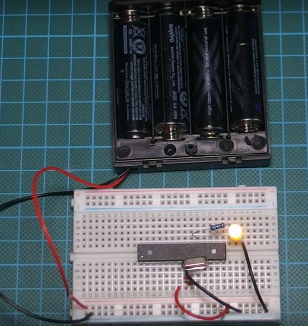

Schematics
Connect the components of the Arduino on breadboard as shown in the schematic below.
Schematics
To make it easy to connect the components to the microcontroller, A sticker which translates the pins of the microcontroller to the equivalent pin on the Arduino is pasted on top of the microcontroller. This sticker is included in the zip file attached at the end of this tutorial and can be used to make the connections easy for you.
Sticker placed for easy connection
While plugging the microcontroller to the breadboard, take note of the notch at the top left which signifies the first pin (RST) of the microcontroller. Numbering of the microcontroller’s pin should start from there to prevent connecting the components wrongly.
With the circuit and power connected, you should see the led start blinking.
Notch which Marks pin 1

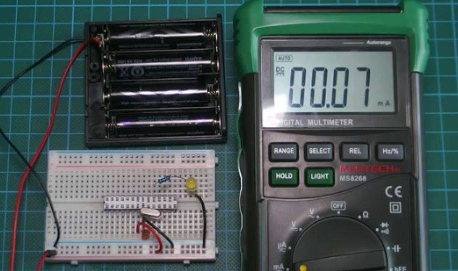

As a proof of the low power consumption rate of the microcontroller when in idle mode, we used the maestech meter to measure the current consumption and got 0.07mA in idle mode. This is far less than any of the Arduino boards with Arduino pro mini consuming around 3mA and Uno, 30mA in Idle Mode. This shows that you can have an Arduino project like a weather station for example, that could last for years running on batteries and this increases the potential of what you can do with the Arduino platform drastically.
