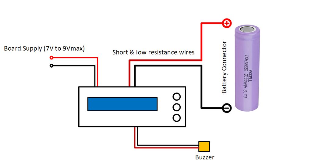

Schematics
As earlier mentioned, the project was implemented using a PCB to make it portable. The PCB was designed using Altium and all the files are attached under the download section of the tutorial. The components are connected as shown in the schematics below;

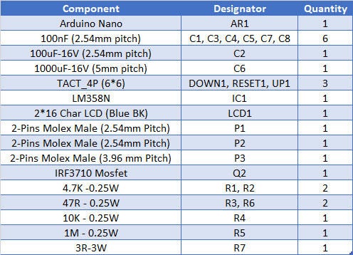

A comprehensive BOM showing how each component fits into the schematics above is shown in the table below:
