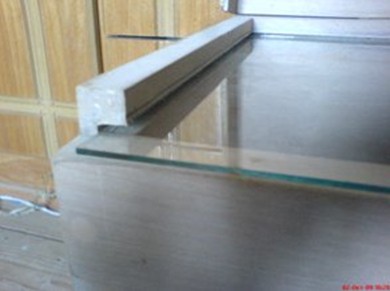

All things above are housed in a wooden box. You can design the box by yourself however I had it done by a technician.
There are 3 distinctive parts that constitute your PCB Exposure Box; the Box the Lamp System and the Counter System along with the display.
The Box
photo_3
You are gonna need a wooden box with dimensions aproximately 50x30x60 cm3. The box must have an extra room for hosting the countdown board and the two ballasts. The height of that room, that is the distance between the bottom of the box and the shelf, can be 5-8 cm. On the one side of the shelf will be installed the four starter bases and on the other side the four lamps along with their G13 bases.
Here is a very detailed description on how to build your own box, upon which I relied to decide the dimensions of my box. However the final design I used is the same as Papanikolaou’s box in his Darkroom Timer project. Many thanks to both of them!

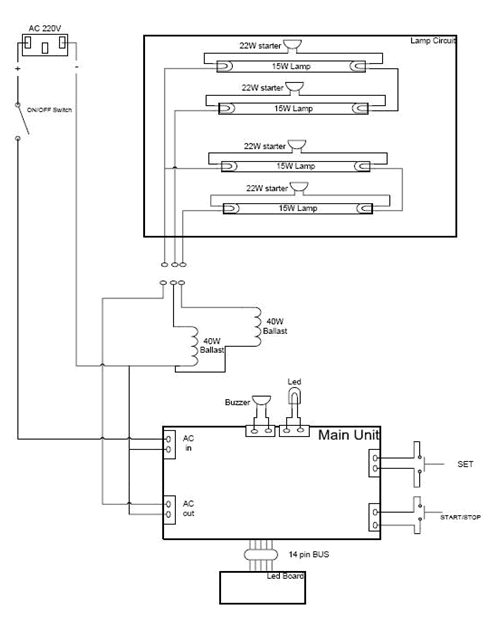

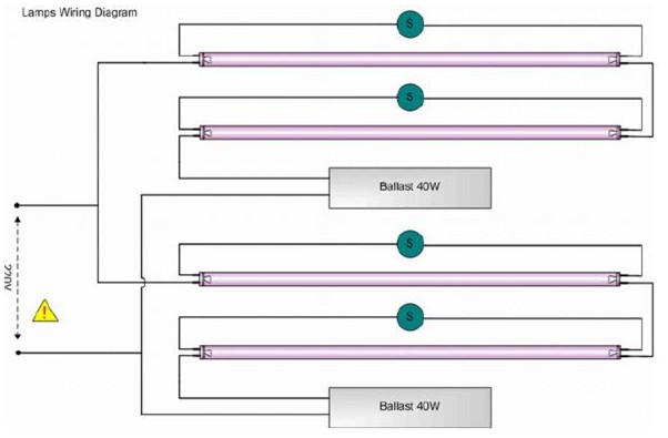

The connections you have to make for the lamps are as in the next image.
This is a very popular connection for two low wattage fluorescent lamps connected in series.
There are two identical modules connected in parallel. In each module, initially, the AC current flows through the two starters and the ballast. After a while, one of the starters goes open-circuited and the current in the circuit is halted. This brings the ballast inductor in an extremely uncomfortable situation and it reacts violently developing a great voltage across its terminals. The value of the voltage can be as large as some kV and that is exactly what the fluorescent lamps need in order to be turned on. After that transition effect, the voltage across each lamp gets stabilized around the 50~60V which is the lamp’s operation voltage shown in the manuals.

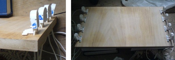

As for the construction details, I put the lamps and the starters on the two sides of the wooden shelf and the two ballasts on the bottom of the box.

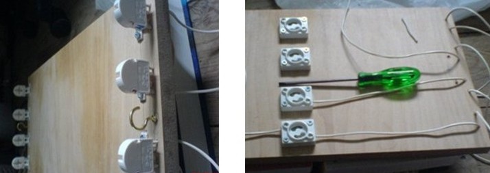

So, as far as the shelf is concerned. First, I screwed the starters’ bases on the I made the following connections one side of the shelf
photo_5

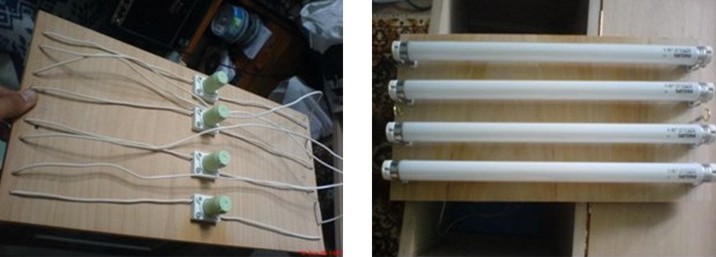

Second, on the other side of the shelf, I screwed the eight G13 lamp holders, having first, drilled the holes needed by the wires to join the lamp bases with the starter bases
photo_6
also don’t forget to screw some shelve holders so that you can put and get out the shelf from the box, next do the wire connections
photo_8
and finish the shelf by populating it with the starters and the lamps
photo_7

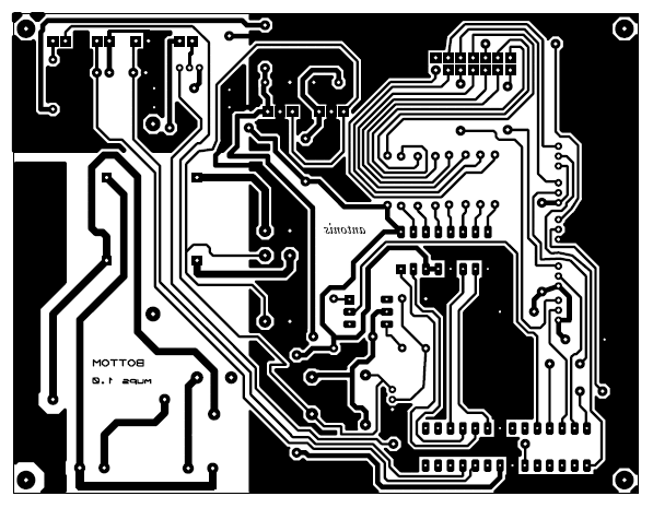

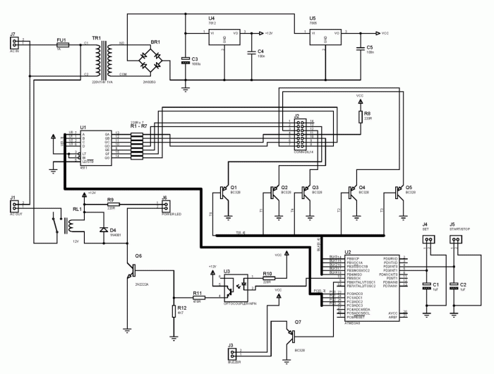

As for the hardware, there has been a lot talk about how to do it. The Darkroom Timer of Vassilis Papanikolaou contains quite apprehensive schematics plus PCBs. My schematic contains all the variations required for the substitution of the PIC with the AVR mega8. In addition I use only two buttons and I put the regulators in parallel instead of in series.
The schematic of the main unit which contains the microcontroller and the power supply is the following:
main_schematic

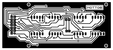

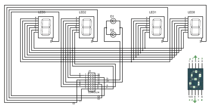

LED BOARD SCHEMATIC
led_display_schematic_th
QTY PART-REFS VALUE
Diodes
2 D1,D2 LED-GREEN
Miscellaneous
1 J1 CONN-DIL14 for the connection with the main unit
4 LED0-LED3 Common Cathode 7segment displays
I tested the schematic virtually and in real-time. And by “virtually” I mean I used an Electronics Systems Simulation Software like Proteus VSM… and like nothing else (…coz as far as I know there is no competitor so far!). I am not doing any advertisement but Proteus VSM is amazing and for those who haven’t heard about it yet, I recommend that they try, at least, a demo version from www.labcenter.co.uk
Only after Proteus said I was right, did I try the circuit in a breadboard and that fact saved me a lot of time, especially in the code development and debugging. So saying “I tested the circuit in real time” I mean I put every component on the breadboard and there I fixed any problems that Proteus didn’t find.

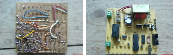

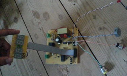

So, after ensuring everything was right it was time to design my last wire-soldered circuit!

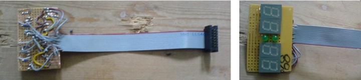

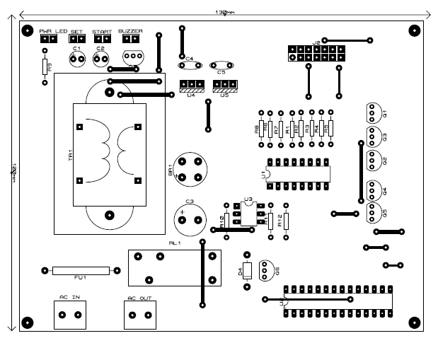

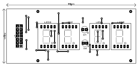

I started from the led board
photo_10
and the corresponding main unit
photo_11
Connecting the modules together
photo_12

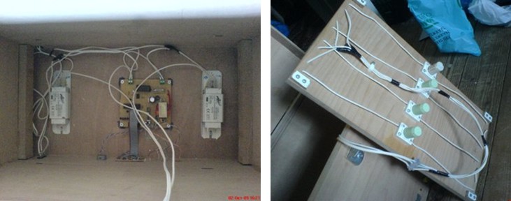

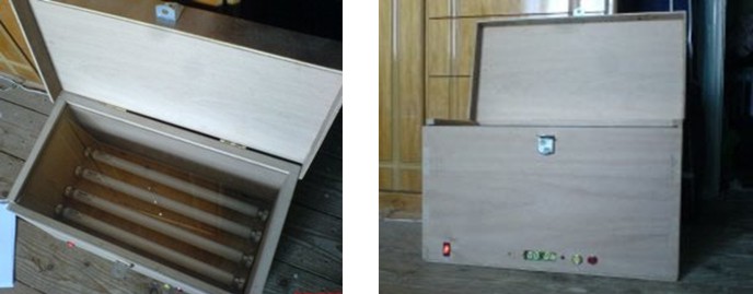

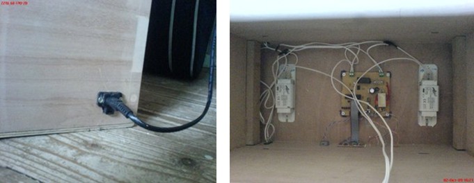

So far so good! Everything works fine and it is time to enclose the Lamp System and the Countdown System in the Box. A general diagram helps to identify the place of each module.
overal_schematic
first a socket at the back of the box is installed, next the ballasts, the main board, the led board and the switches
photo_13
PCB Exposure Box is ready, and after the shelf is set
photo_14
