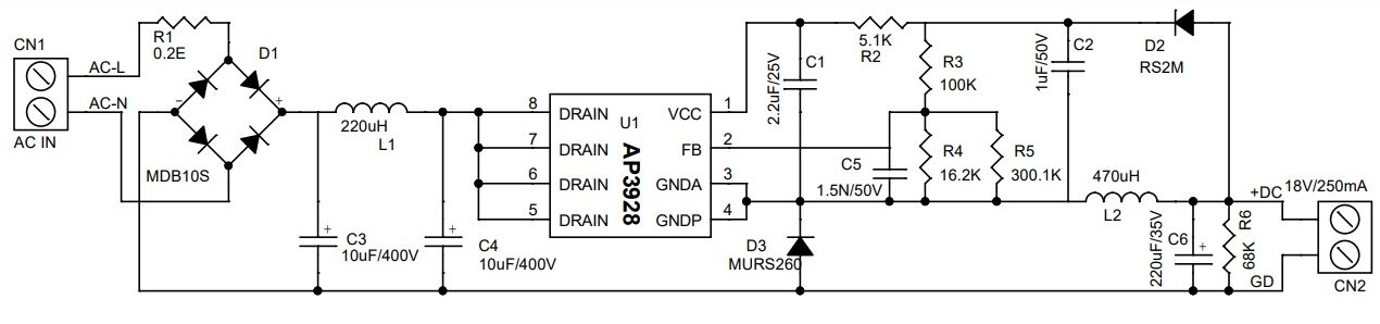

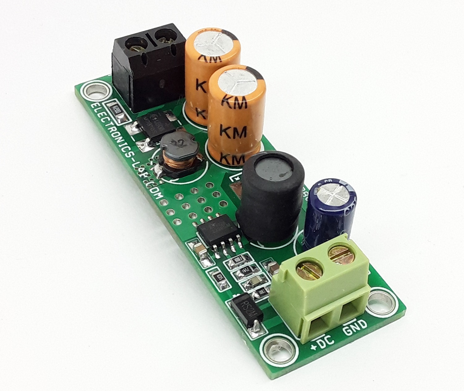

The project described here is an off-line universal AC Voltage input step-down regulator that provides accurate constant voltage (CV) output, outstanding low standby power, high efficiency at light load, and excellent dynamic response based on non-isolated buck topology. The project is built using the AP3928 chip.
The project described here is an off-line universal AC Voltage input step-down regulator that provides accurate constant voltage (CV) output, outstanding low standby power, high efficiency at light load, and excellent dynamic response based on non-isolated buck topology. The project is built using the AP3928 chip. The project provides 18Vdc output @ 250mA from AC input 85V to 265V AC. The project can be used for many applications such as home appliances, IoT applications, industrial controls, standby power, and auxiliary power.
The AP3928 is a universal AC voltage step-down power switcher, specially designed for home appliances and IoT applications with non-isolated buck solution. The device integrates a 700V high-performance power MOSFET. Coordinating with a single-winding inductor, it uses fewer external components and provides a low bill of materials (BOM) cost solution. The AP3928 can achieve high output current, excellent constant voltage regulation, and high conversion efficiency. The peak current and switching frequency continuously reduce as the load decreases, so the device can achieve excellent efficiency performance at light load and improve overall system efficiency. The AP3928 has multiple protection features to enhance the system’s safety and reliability. The device has overtemperature protection, under-voltage lock function, output short protection, overload protection, and open-loop protection. The AP3928 is available in the SO-8 (Standard) package.

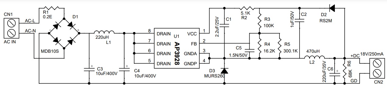

When the FB voltage drops below the open-loop detection threshold voltage VOLD, the AP3928 stops working and begins a restart cycle. The open-loop detection is blanked for 64 switching cycles during start-up process. Moreover, if FB pin was floating, output voltage will be fixed to 12V typically. Overshoot Improvement In general, there is no capacitor between FB pin and GNDA (GNDP) pin. But in some cases where strict overshoot is required, we recommend a ceramic capacitor C6 (390pF to 2.2nF) in Figure 6. In addition, adding a C6 can improve output voltage ripple as well.

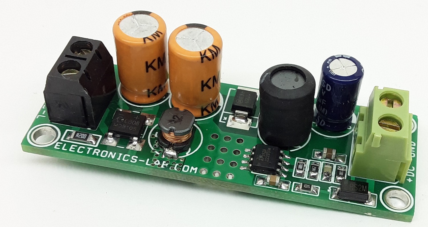

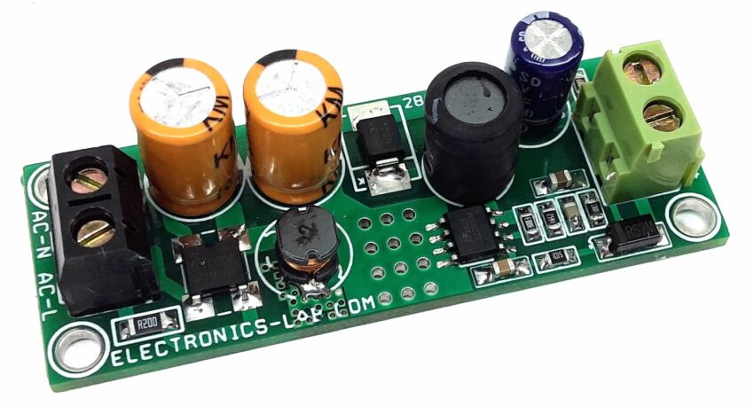

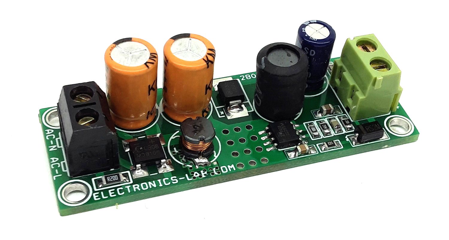

- Universal 85V to 265V VAC Input
- Output 18V DC
- 250mA Output Current (Rated Up to 500mA)
- Low Standby Power Consumption (<30mW at no load)
- High Light-Loading and Average efficiency can meet DOE and CoC requirement
- Frequency Modulation to suppress EMI to meet EN55022 class B
- Rich Protection including OTP, OLP, OLD, SCP
- Extremely low system component counts small size

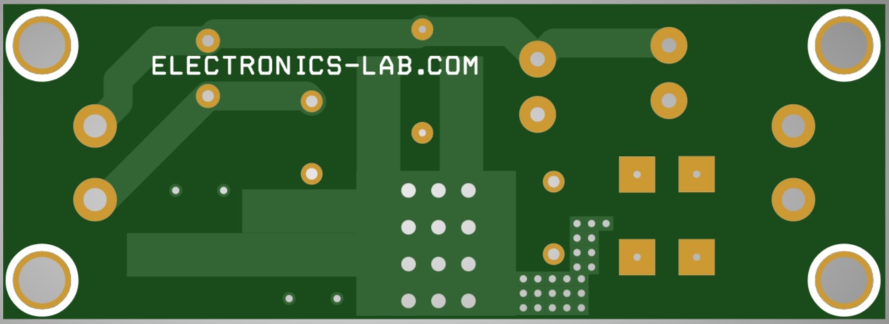

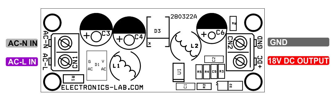

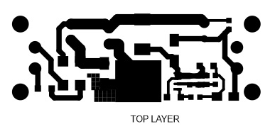

- PCB Dimensions 60.80 x 21.75 mm
- 4 x 3mm Mounting Holes
Schematic

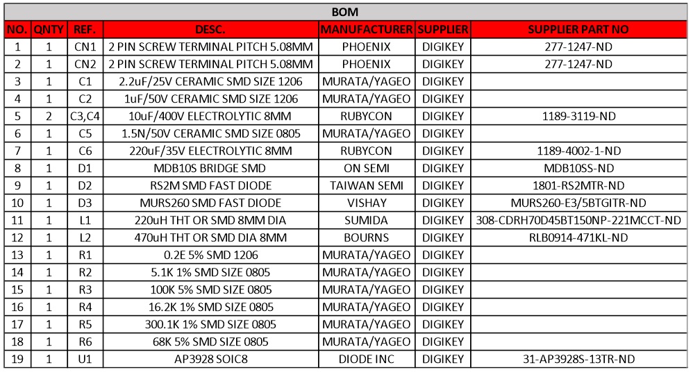

Parts List
| NO | QNTY | REF. | DESC. | MANUFACTURER | SUPPLIER | PART NO |
| 1 | 1 | CN1 | 2 PIN SCREW TERMINAL PITCH 5.08MM | PHOENIX | DIGIKEY | 277-1247-ND |
| 2 | 1 | CN2 | 2 PIN SCREW TERMINAL PITCH 5.08MM | PHOENIX | DIGIKEY | 277-1247-ND |
| 3 | 1 | C1 | 2.2uF/25V CERAMIC SMD SIZE 1206 | MURATA/YAGEO | DIGIKEY | |
| 4 | 1 | C2 | 1uF/50V CERAMIC SMD SIZE 1206 | MURATA/YAGEO | DIGIKEY | |
| 5 | 2 | C3,C4 | 10uF/400V ELECTROLYTIC 8MM | RUBYCON | DIGIKEY | 1189-3119-ND |
| 6 | 1 | C5 | 1.5N/50V CERAMIC SMD SIZE 0805 | MURATA/YAGEO | DIGIKEY | |
| 7 | 1 | C6 | 220uF/35V ELECTROLYTIC 8MM | RUBYCON | DIGIKEY | 1189-4002-1-ND |
| 8 | 1 | D1 | MDB10S BRIDGE SMD | ON SEMI | DIGIKEY | MDB10SS-ND |
| 9 | 1 | D2 | RS2M SMD FAST DIODE | TAIWAN SEMI | DIGIKEY | 1801-RS2MTR-ND |
| 10 | 1 | D3 | MURS260 SMD FAST DIODE | VISHAY | DIGIKEY | MURS260-E3/5BTGITR-ND |
| 11 | 1 | L1 | 220uH THT OR SMD 8MM DIA | SUMIDA | DIGIKEY | 308-CDRH70D45BT150NP-221MCCT-ND |
| 12 | 1 | L2 | 470uH THT OR SMD DIA 8MM | BOURNS | DIGIKEY | RLB0914-471KL-ND |
| 13 | 1 | R1 | 0.2E 5% SMD 1206 | MURATA/YAGEO | DIGIKEY | |
| 14 | 1 | R2 | 5.1K 1% SMD SIZE 0805 | MURATA/YAGEO | DIGIKEY | |
| 15 | 1 | R3 | 100K 5% SMD SIZE 0805 | MURATA/YAGEO | DIGIKEY | |
| 16 | 1 | R4 | 16.2K 1% SMD SIZE 0805 | MURATA/YAGEO | DIGIKEY | |
| 17 | 1 | R5 | 300.1K 1% SMD SIZE 0805 | MURATA/YAGEO | DIGIKEY | |
| 18 | 1 | R6 | 68K 5% SMD SIZE 0805 | MURATA/YAGEO | DIGIKEY | |
| 19 | 1 | U1 | AP3928 SOIC8 | DIODE INC | DIGIKEY | 31-AP3928S-13TR-ND |
Connections
