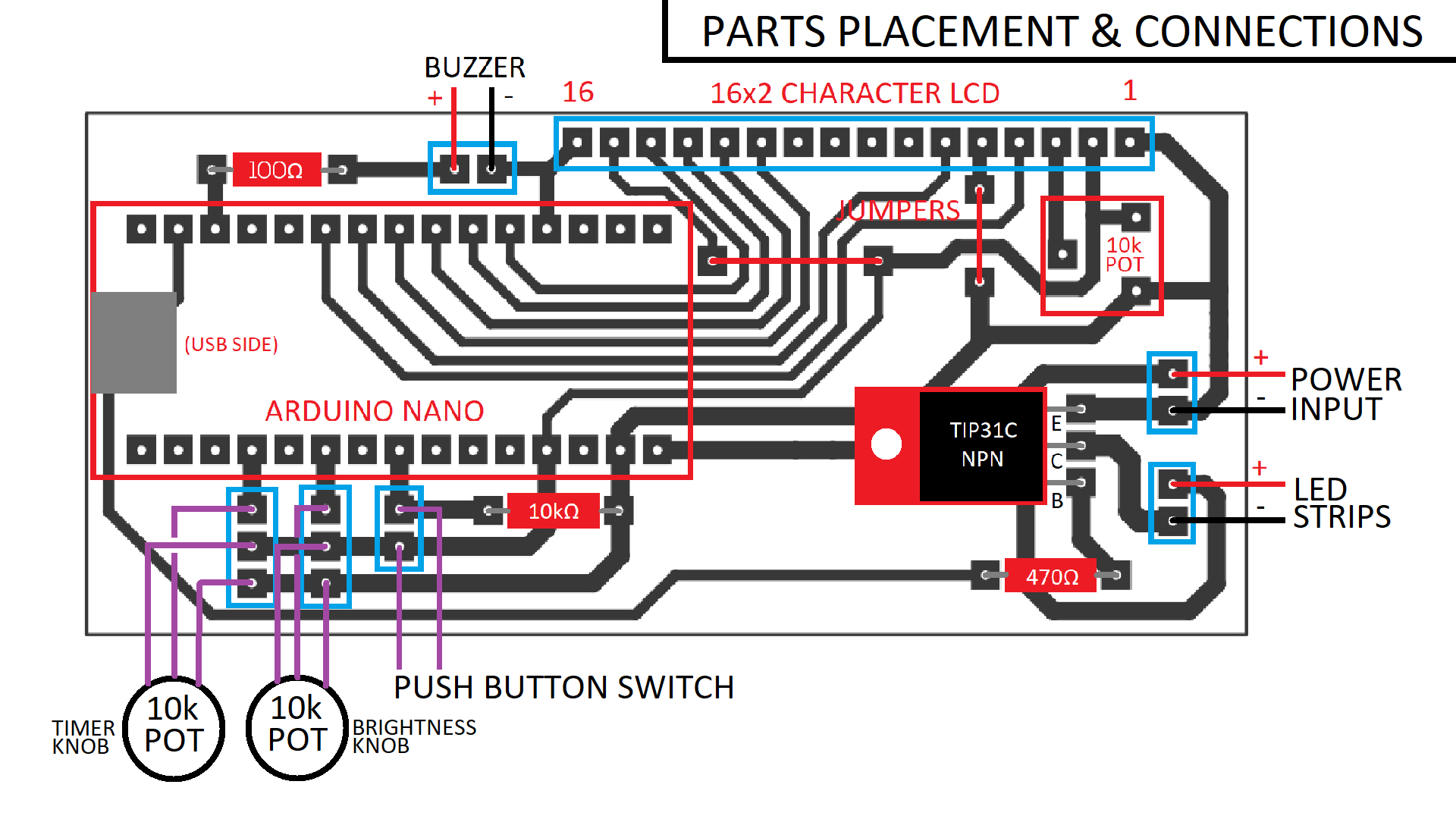

Schematics
The schematics for the project is provided in the image below. The project was implemented on a PCB to make it more compact and easy to mount on the enclosure, but by carefully following the schematics below, you should be able to replicate the project on a veroboard or breadboard.
The schematics and PCB were created using Proteus and the project file with the schematics and PCB is attached under the download section to make it easy to replicate.

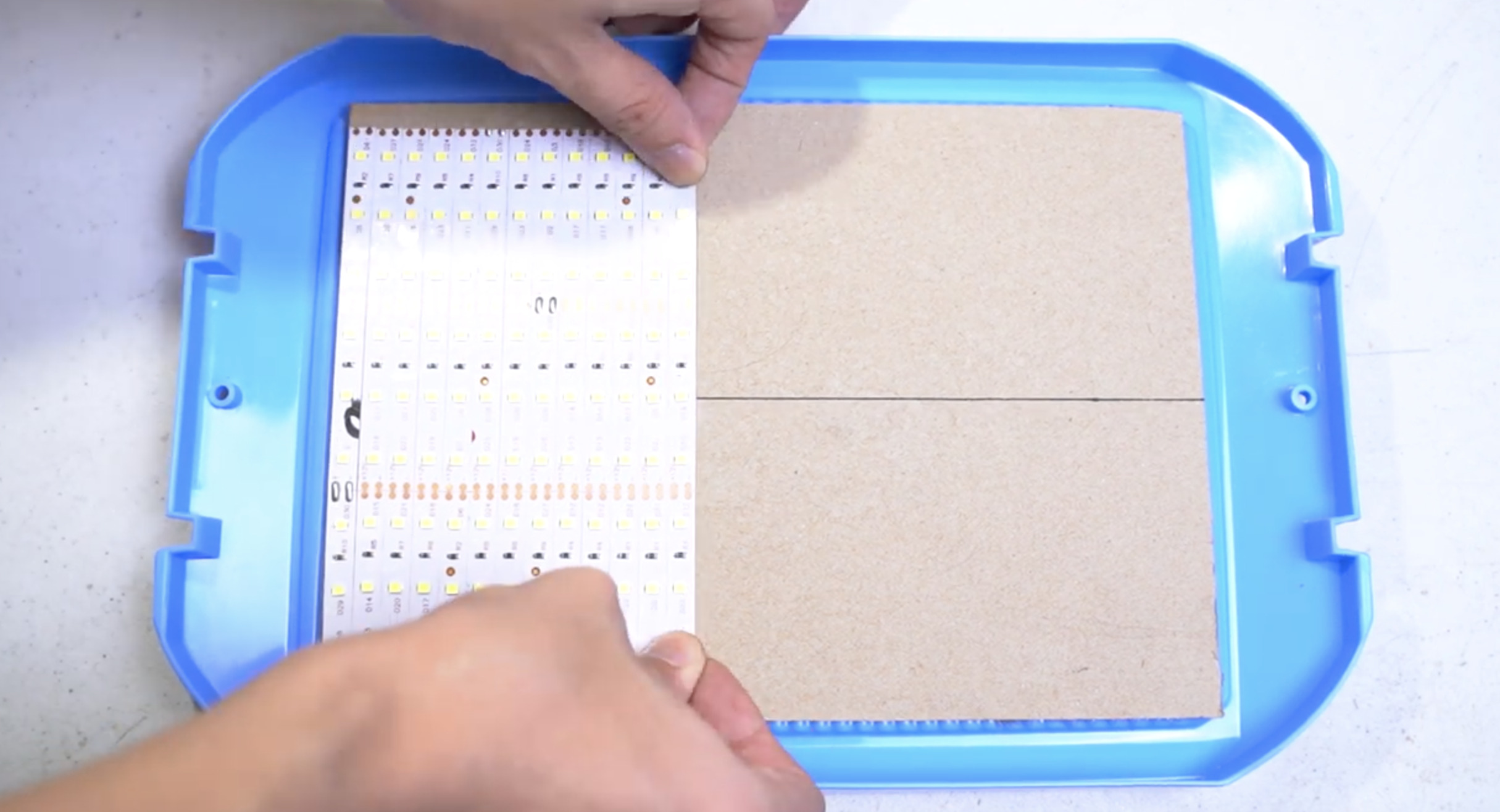

1. Prepare the top/cover of the enclosure. If the surface is not perfectly flat, you can put a layer of cardboard or any other material to make it flat.
2. Based on the width (or length, depending on the orientation you prefer) of the lid, cut the LED strips into pieces with equal length. Peel the cover off the back of the LED strips to expose the sticky side of the strips and gently mount the strips on the lid of your enclosure, ensuring there is little or no space between the strips.
3. Next solder the positive leads of the strips together on one side and the negative terminals together on the other side of the box. Soldering on different sides reduces the chances of shorts.
With this done, power the LEDs up with a 12VDC/2A supply to be sure there are no shorts. If your connections have been properly soldered, all LEDs should come on.

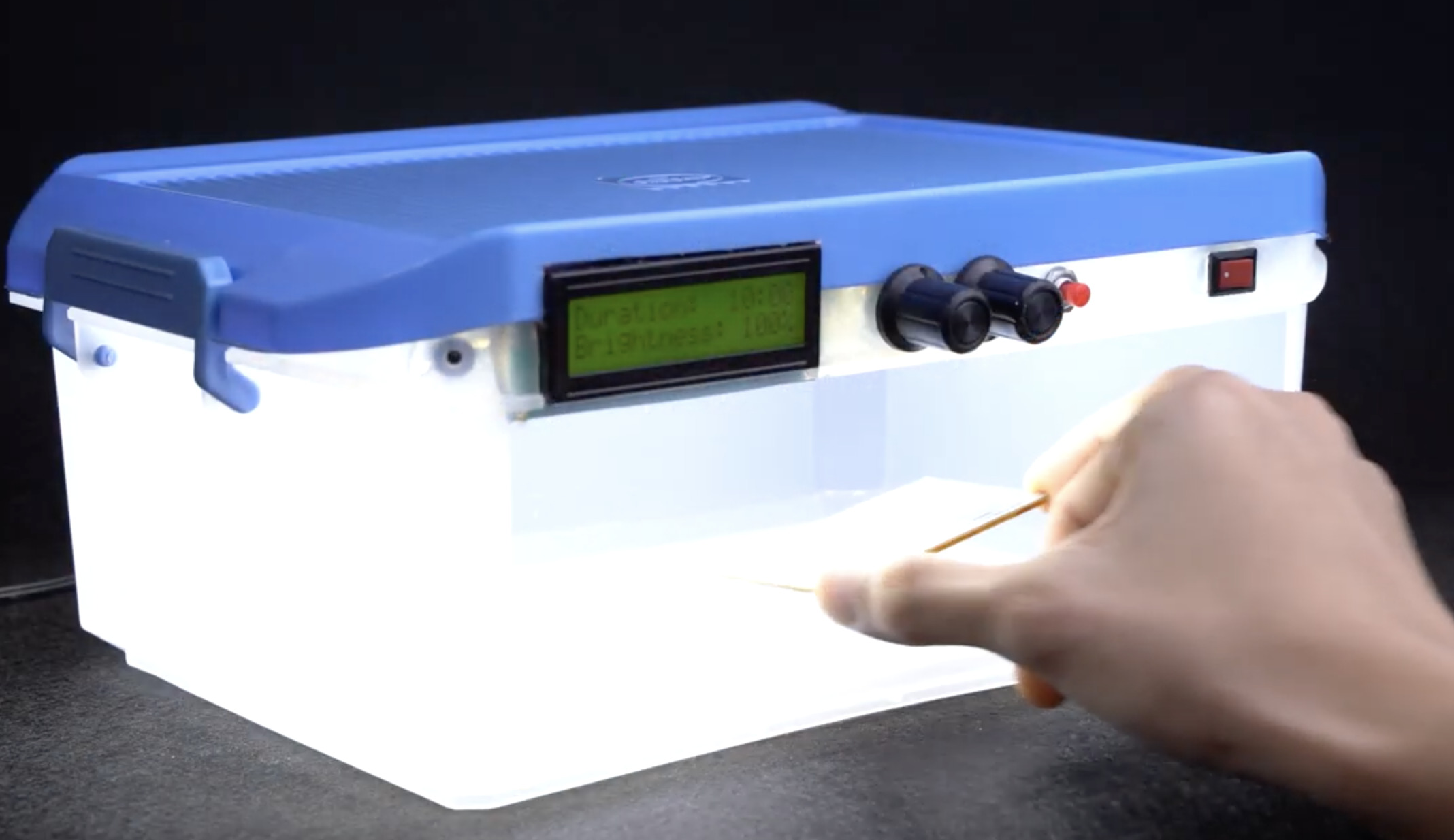

4. Next, you need to cut out holes for the screens, switch, and other elements that the users will interact with. You can do this with a CNC machine or a combination of drills, files, Dremel tools, and hot glue.
5. Connect all components and mount the external components in the holes made. feel free to use Hot glue to secure things in place where necessary.
With all this in place, your enclosure should now be ready and look like the image below.

Demo
With the code complete, connect the Arduino nano board to your computer and upload the code to it. Ensure to select the right board type and COM port as the case may be.
After the upload, power up your device. You should see the LCD come up with the initialization messages being displayed.  Feel free to test things out with any design, you should see more efficient design transfer than with heat or any other method.
That’s it. Your very own PCB Exposure BOX. Feel free to reach out via the comment section if you have any questions about this build.
Project credit goes to Techbuilder, and a video version of the tutorial is available on youtube here.
