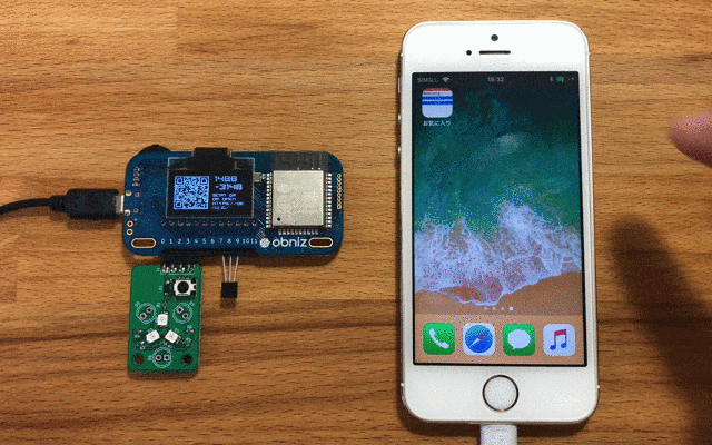

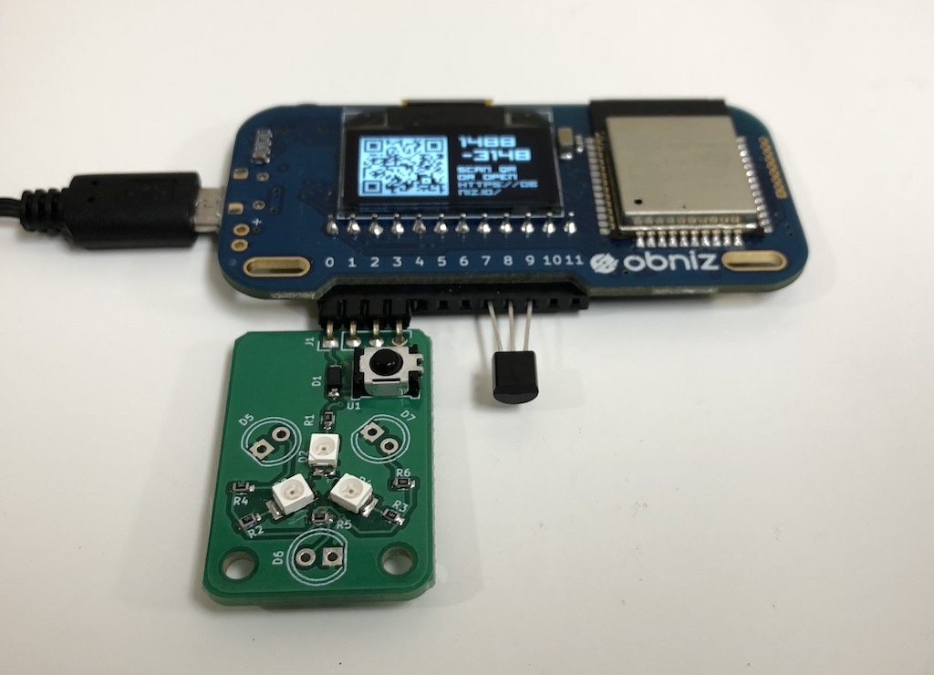

Connect IR module and LM32DZ to obniz as below and place it in your house.

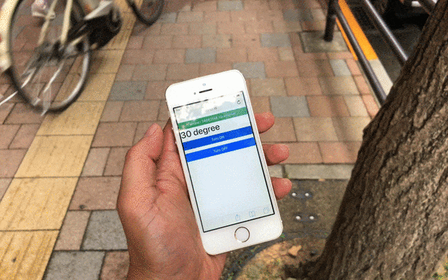

Just open the HTML with your smartphone. You can control your air conditioner from everywhere in the world!
