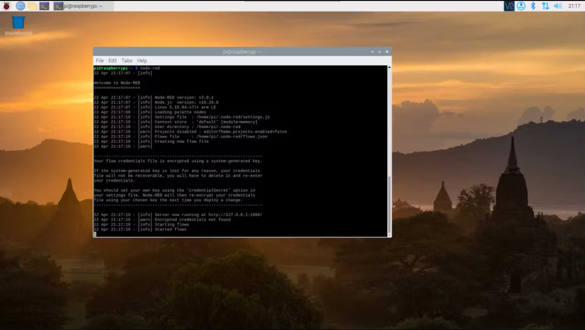

Now just start the Node-Red in Raspberry Pi by using this command.
node-red

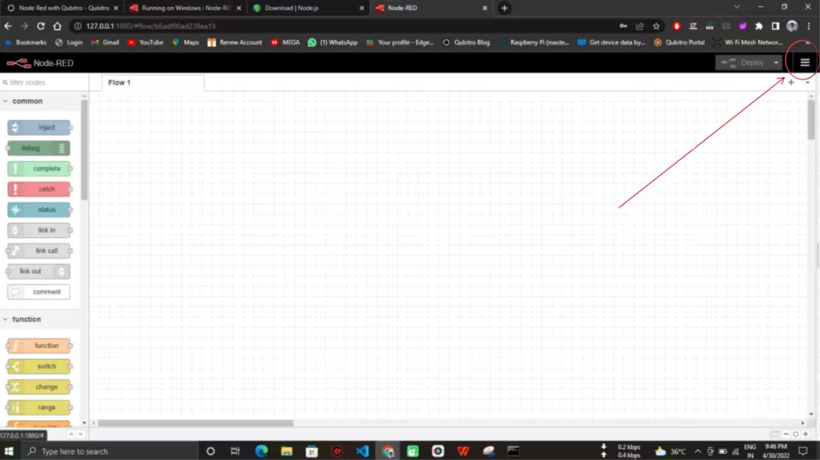

Next, in your browser, go to the URL mentioned above. The Node-RED dashboard is now visible.
This is how the Node-RED Dashboard page appears.

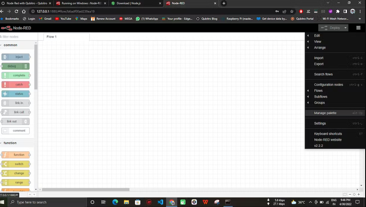

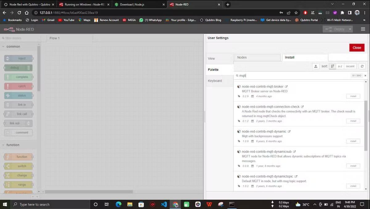

First, we must install the MQTT Plugin for Node-RED. To do so, go to the menu option.
Choose “Manage Palette” from the drop-down menu.
Install MQTT Plugin by going to Palette and searching for it.

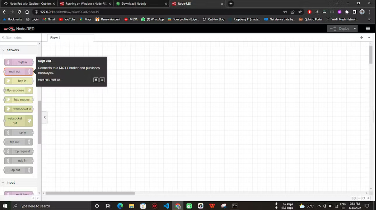

After successful installation, the MQTT In and MQTT Out menus appear in the network section.

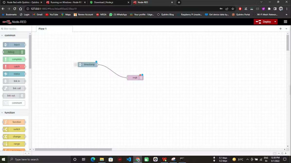

Select MQTT Out and add it to the flow, then select Injection Palette and add it to the flow, making a connection between MQTT Out and Injection Palette.
The next stage is to connect the Node-Red to the cloud. For this, we have to use MQTT nodes. You can see those nodes in the node pallets.

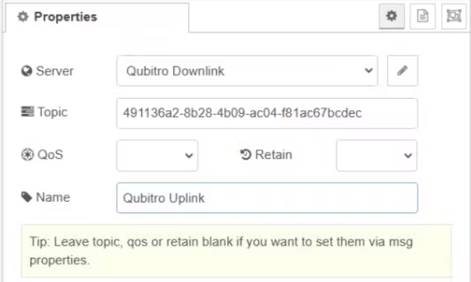

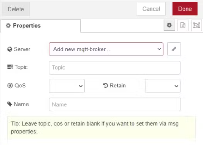

We can use the MQTT out node to send our data to the cloud. Open the MQTT out node’s properties. We have to add our MQTT broker’s credentials.
And click on the edit new MQTT broker.
Now we have to add our server details.

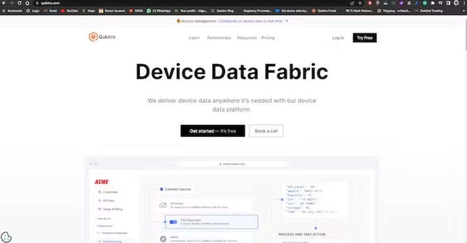

Qubitro Cloud Setup
In this, we are going to use Qubitro as a cloud service to store and transfer data.

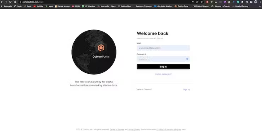

Login to Qubitro by creating a new account and opening the portal.

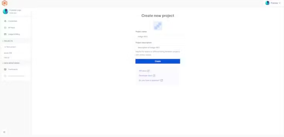

Next, create a new project with all your details.

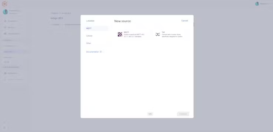

Once you create the project, and add the data source point, you can see multiple data routes. In this, we are going to use MQTT so, select the MQTT as a data point.

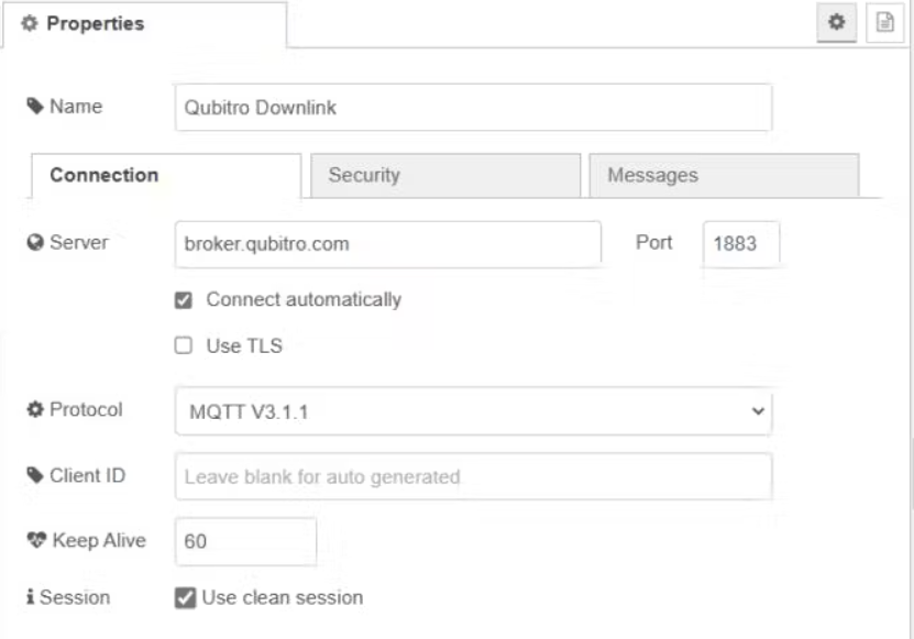

Node-Red MQTT Setup
Use these configurations with the MQTT Out node.

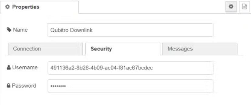

Next, navigate to the security tab and enter the Device ID and token.
That’s all. Now we are all good. Again, go back to the MQTT Out node and there you can see the topic. Use the Qubitro Device-ID as mqtt topic here.

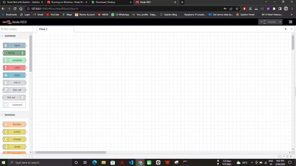

Finally, deploy the nodes. You can see the connected notification.

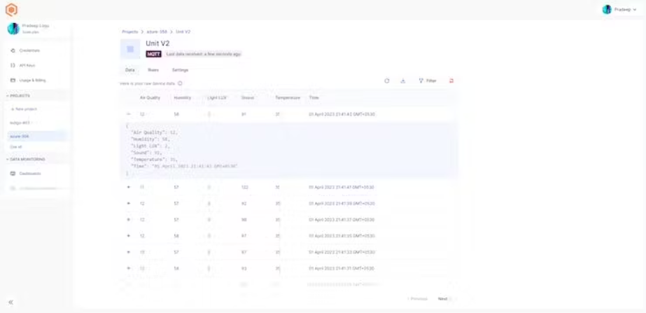

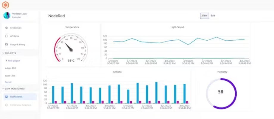

Navigate to the Qubitro portal and look at the device page, it will show you the whole node-red data.

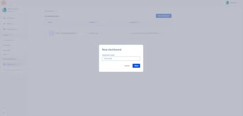

Also, Qubitro supports a good dashboard to visualize our data. Navigate to the Qubitro Dashboard and create a new dashboard.

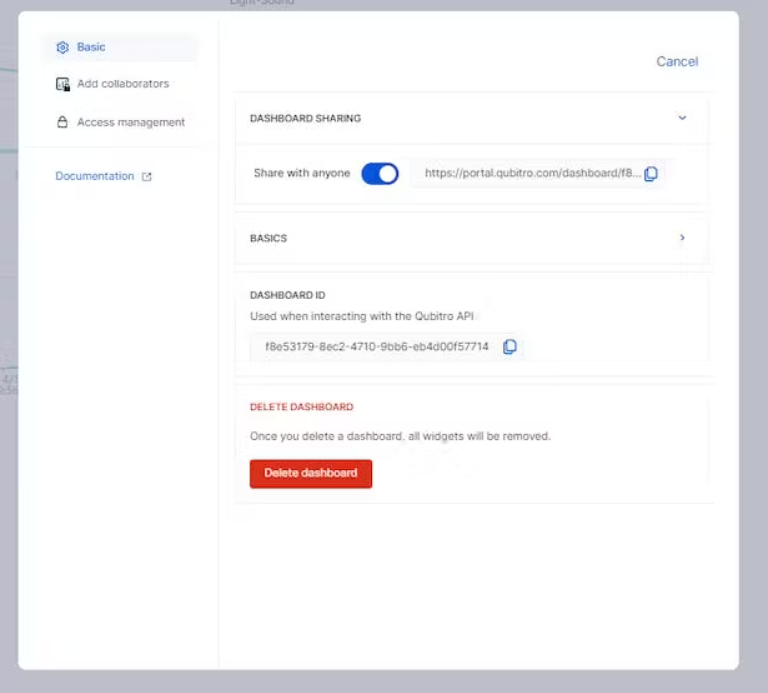

Finally, if you want to share your data with the public means you can share via the public dashboard option in Qubitro.
Here is my sample demo dashboard.
