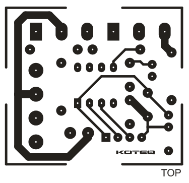

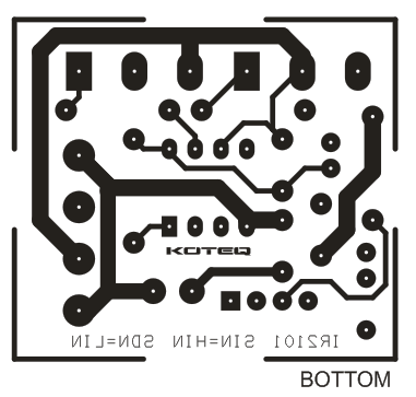

This is a discrete Half-bridge driver based on IR2104 gate driver IC and low impedance high current N channel IRFP4368 MOSFETS. The IR2104 is a high voltage, high speed power MOSFET driver with independent high and low side referenced output channels.
Half-Bridge-Based-on-IR2104-PIC
This is a discrete Half-bridge driver based on IR2104 gate driver IC and low impedance high current N channel IRFP4368 MOSFETS. The IR2104 is a high voltage, high speed power MOSFET driver with independent high and low side referenced output channels. HVIC and latch immune CMOS technologies enable ruggedized monolithic construction. The logic input is compatible with standard CMOS or LSTTL output, down to 3.3V logic. A gate IR2104 driver is a power amplifier that accepts a low-power input from a controller IC and produces a high-current drive input for the gate of a high-power transistor such as a power MOSFET. In essence, a gate driver consists of a level shifter in combination with an amplifier.
This drive has many applications, ranging from DC-DC power supply for high power density and efficiency. This project simplifies the design of control systems for a wide range of motor applications such as home appliances, industrial drives, DC brushed motors , Brushless motors, fans, Tesla Coil driver, Induction coil driver, LED driver, Halogen Lamp driver.
Note: This board has provision to use IR2101 IC for dual signal Low/High input. For continious 30A load PCB track thickness should be 70 microns.

Discrete means individual components. To say you have a “discrete half bridge driver” means you built this from discrete components, transistors, diodes, resistors, etc… You do not have a discrete driver, you have a gate driver IC. BIG BIG difference, if you don’t believe me go and design build and test a true discrete half bridge driver. Good luck
Jens Overby
What was the specific reason for using the IRFP4368 mosfet? You have quite a large bootstrap capacitor, 10uF? It’s probably necessary, but why? To avoid Vgs going above 20V? Is this something you have seen during testing? Sorry about all these questions, but I have a circuit much like this that keeps blowing my IRFZ44n mosfets – I only use 1uF bootstrap capacitor.
