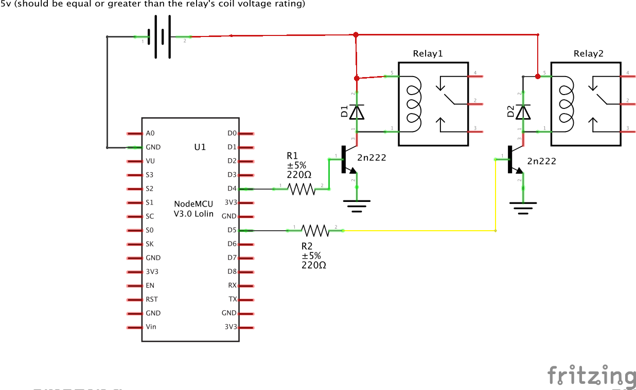

Schematics
The schematics for this project is quite simple. Connect the components as shown in the diagram below.
Schematics
To make the connections easy to follow, here is a pin map of the connection between NodeMCU and the relay module.
NodeMCU – Relay Module
3.3V - VCC
GND - GND
D1 - D1
D2 - D2
D3 - D3
D4 - D4
If you are using the ordinary relays without the module supporting circuit, connect the relays to the NodeMCU as shown below. Ensure the relay’s coils are rated 5v or change the 5v supply to match your relay’s rated coil voltage.
Schematics 2

Upload the code to the NodeMCU. Ensure everything is connected as described under the schematics section. After uploading the code, you should see the IP address of your web server displayed in the serial monitor as shown below.
Arduino Serial Terminal Output
Copy the IP address and paste it in a web browser on any device (Mobile or PC) connected to the same network as the NodeMCU. You should see the web page and be able to toggle the connected appliances by clicking the buttons.
Web Server interface

Circuitify
bro your pins in circuit diagram and code doesnt match in code its D1 and D2 but in ckt its D4 and GND

Hani
Hi
There isn’t such “2N222” transistor, google it and no result.
Is that “2N2222” ?
mixos
Yes, this was a typo error, thanks for noticing.
