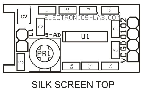

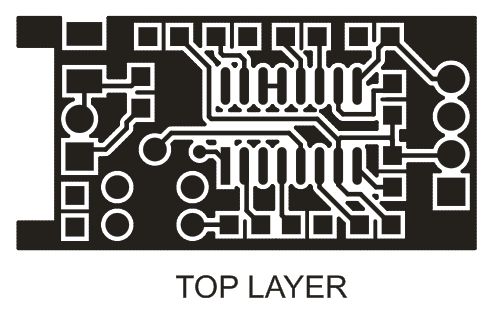

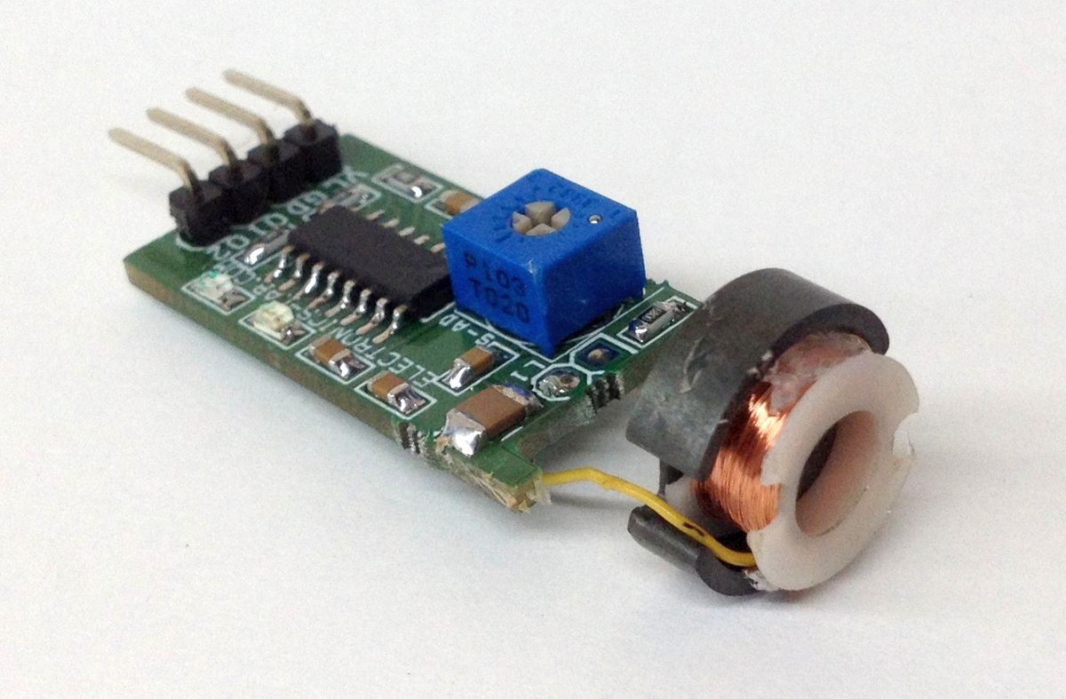

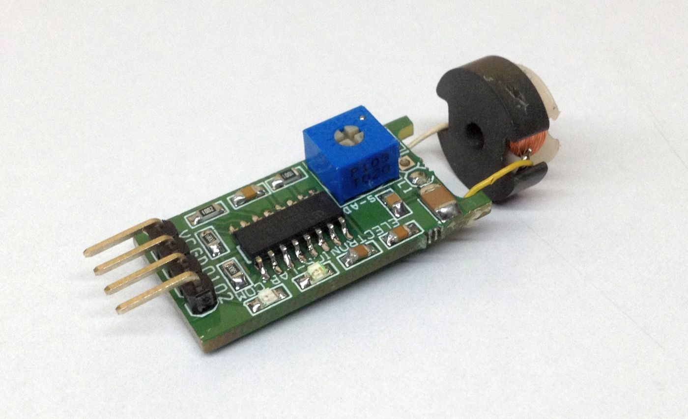

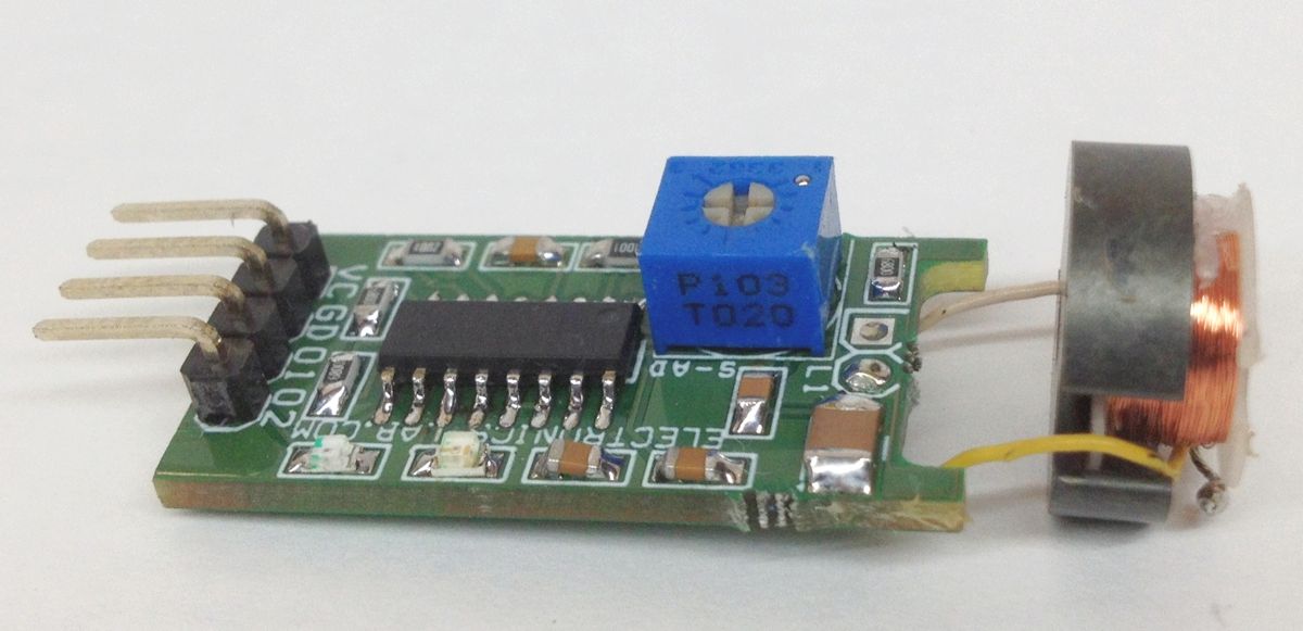

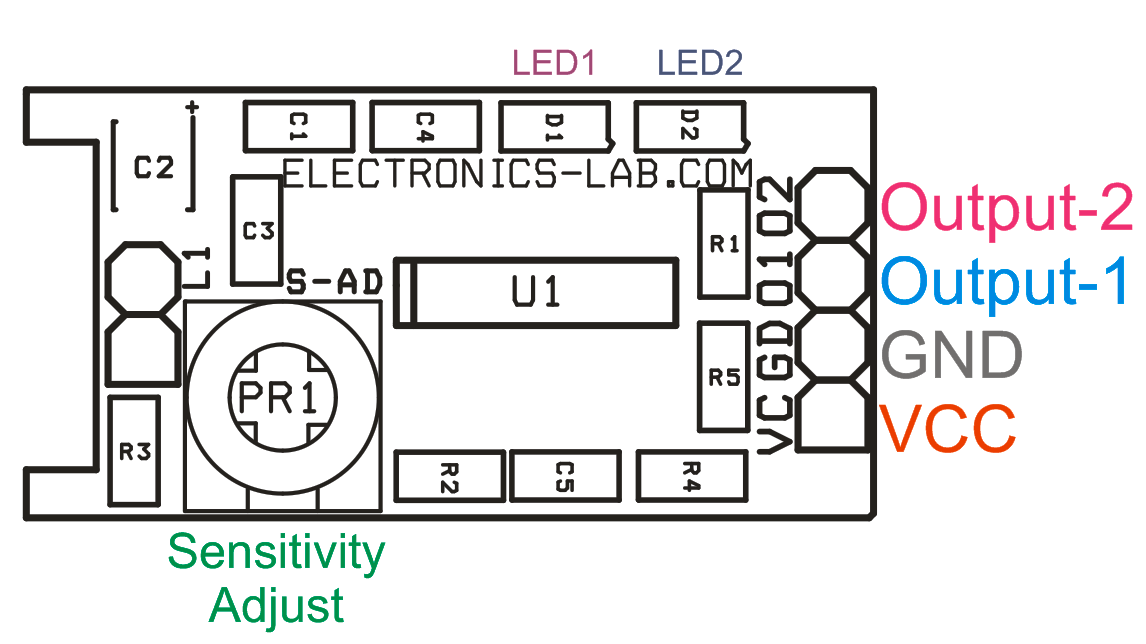

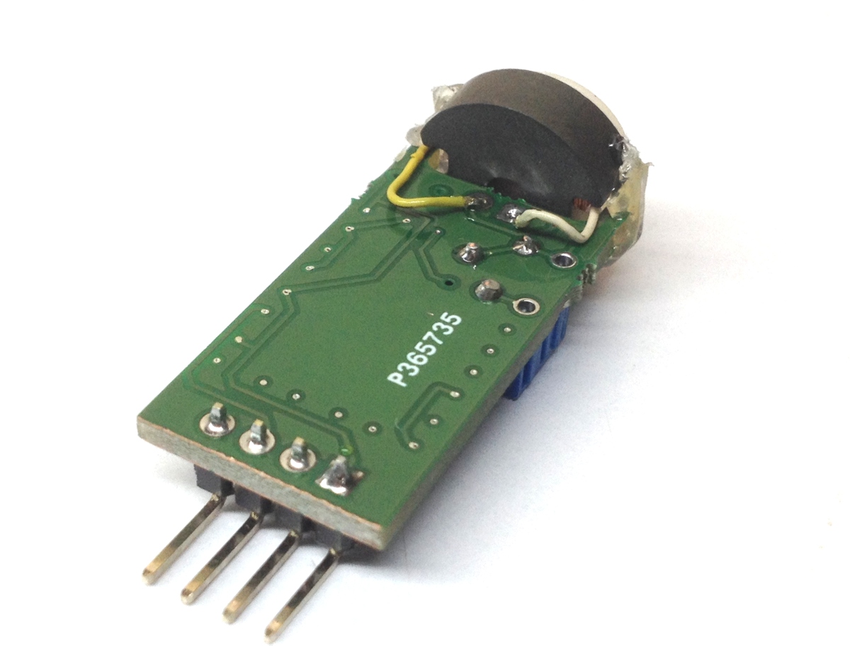

The circuit published here is an Inductive Proximity Sensor, which is used for non-contact detection of metallic objects. The circuit can be used for the detection of metal objects or as a positioning sensor. The TCA505 is used to design an inductive proximity switch that can detect a metal object from 5-10mm range. The resonant circuit of the LC oscillator is implemented with an open half-pot ferrite and a capacitor in parallel (pin LC). If a metallic target is moved closer to the open side of the half-pot ferrite, energy is drawn from the resonant circuit and the amplitude of the oscillation is reduced accordingly. This change in amplitude is transmitted to a threshold switch by means of a demodulator and triggers the outputs. I have tested the circuit with 12V DC however the circuit can also work with higher supply voltage, up to 42V with few components values changes, refer to datasheet for more info. Normally D2 LED is on, when the coil detects the metal object D2-LED goes off and D1 LED turns on, so normally Out-2 provides the low output and Out-1 provides High output when the metal object detected. Q3 Output goes high and Q1 goes Low, both outputs are open collector. PR1 Trimmer potentiometer helps to adjust the sensor sensitivity distance. The output of each transistor can directly drive a small relay as each output has the capacity of handling 50mA of current.

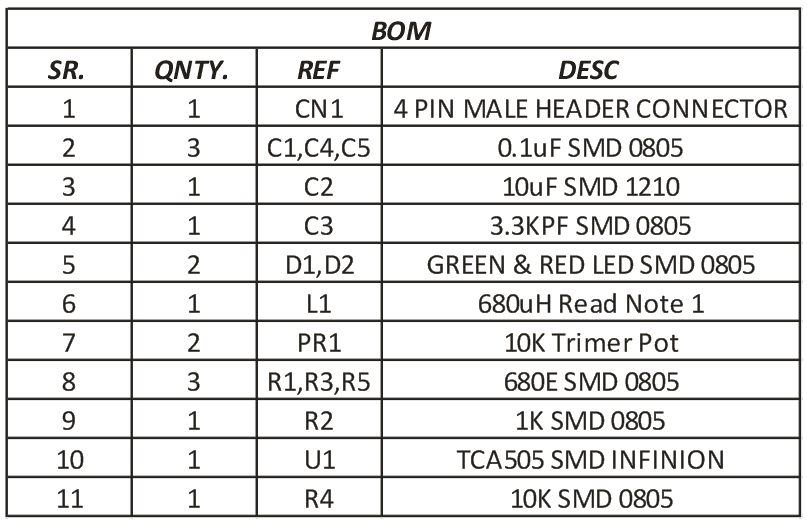

Note : Sensor Coil Can be made using half part of 14MM Pot iron Core, inductance has to be 540uH to 640uH
  • Supply 12V DC
  • Dual Output (Both Open Collector)
  • Detection Range 5-10mm
  • Dual LED operation
  • D2-LED ON Normally Goes OFF When Sensor Detects the Object
  • D1-LED OFF Normally Goes ON When Sensor Detects the Object
  • PR1 – Sensitivity Adjust
  • Both Outputs are Short Circuit Protected
  • High Noise Immunity

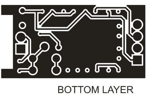

  • PCB Dimensions 30.77mm x 15.54mm
