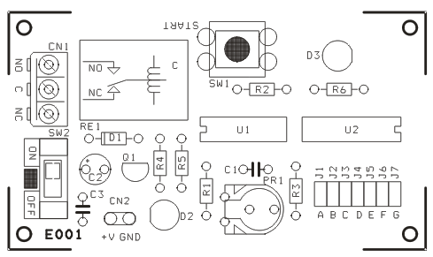

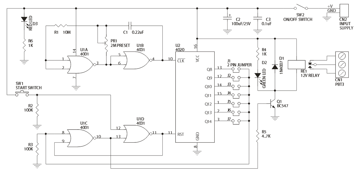

Project has been designed around two CMOS IC CD4001 and CD4020.  Two gates of CD4001 make the oscillator and rest has been configured as flip-flop, BC547 transistor is to drive the Relay. Circuit is pretty simple, has jumpers to set the required time duration, Preset is to set the 1Hz oscillator. SW1 is to start the timer, SW2 Power on/off project. Relay output switch contacts can handle 230V AC @ 5Amps
Applications: TV, Audio Equipment’s, Radio, Fan, Pump, DC Motor, Electronic Projects ON/OFF
Specifications
  • Operation Supply: 12V DC Current
  • Consumption: 60mA
  • D3: Power Indicator
  • D2: Timer Operation Indicator

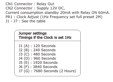

  • CN2: Supply Input
  • J1-J7: Time Set (Please see Schematic for Time Duration)
  • CN1: Relay Switch Connection Normally Open or Normally Closed
  • SW1: Timer Start
  • SW2: Timer Supply On/Off
  • PR1: 1Hz Frequency Set
