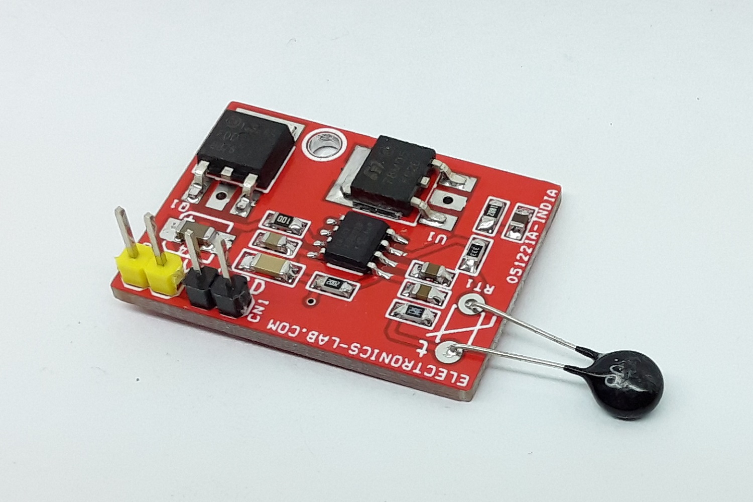

PWM Temperature Controlled FAN using TC648 and NTC sensor
The project described here is a switch mode fan speed controller for use with brushed or brushless DC motors. Temperature proportional speed control is accomplished using pulse width modulation (PWM).
Motor Control by mixos

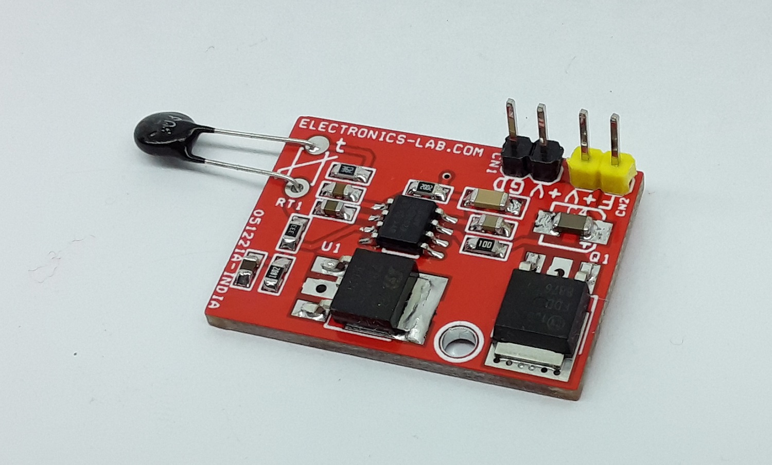

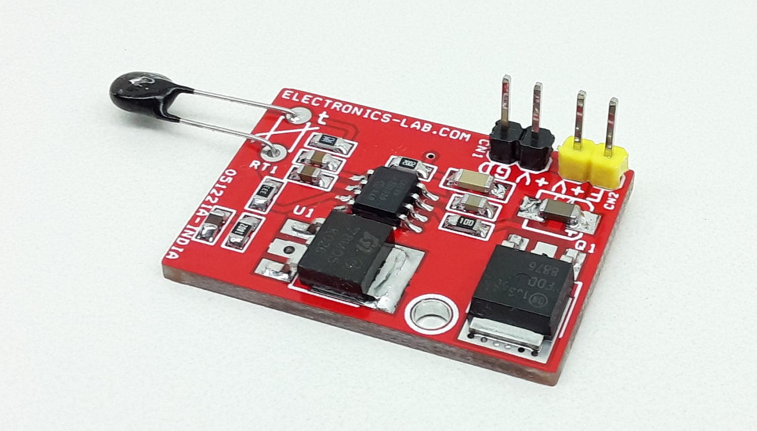

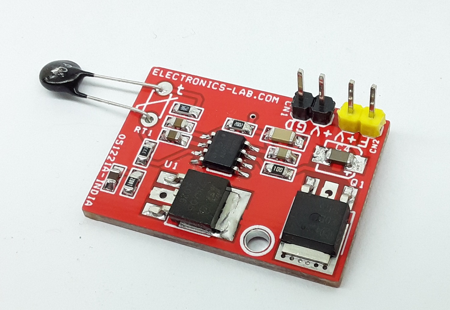

The project described here is a switch mode fan speed controller for use with brushed or brushless DC motors. Temperature proportional speed control is accomplished using pulse width modulation (PWM). 10K Ohms NTC is used to sense the temperature. The project is built using TC648 chip and configured with auto-shutdown mode. In Auto-Shutdown mode, fan operation is automatically suspended when the measured temperature is lower than 25 degrees centigrade. The fan is automatically restarted and proportional speed control is restored when the temperature exceeds 25 degrees centigrade. An integrated Start-Up Timer ensures reliable motor start-up at turn-on, or when coming out of Shutdown mode. MOSFET Q1 is provided to drive the Fan up to 3A of load. A few fans require a PWM signal to work. Use gate of MOSFET to take out the direct PWM signal.

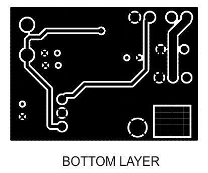

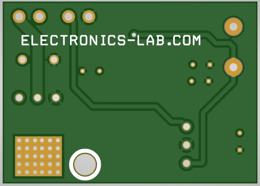

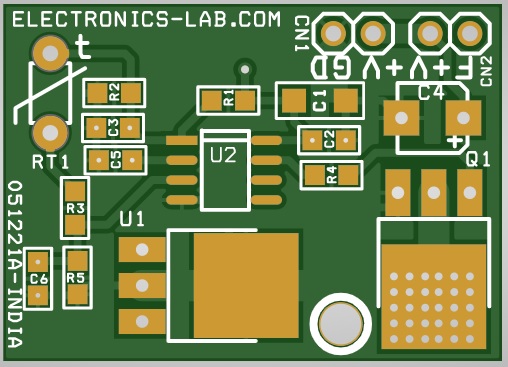

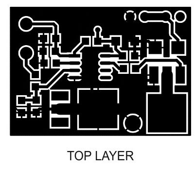

  • PCB dimensions: 31.91 x 22.86 mm

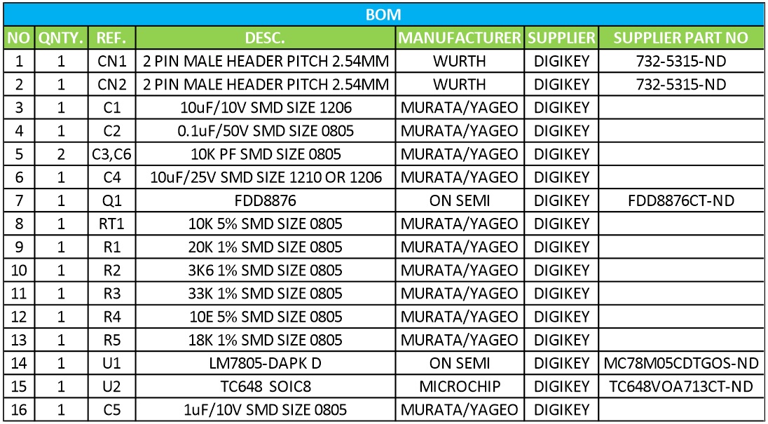

Parts List
NOQNTY.REF.DESC.MANUFACTURERSUPPLIERPART NO
11CN12 PIN MALE HEADER PITCH 2.54MMWURTHDIGIKEY732-5315-ND
21CN22 PIN MALE HEADER PITCH 2.54MMWURTHDIGIKEY732-5315-ND
31C110uF/10V SMD SIZE 1206MURATA/YAGEODIGIKEY
41C20.1uF/50V SMD SIZE 0805MURATA/YAGEODIGIKEY
52C3,C610K PF SMD SIZE 0805MURATA/YAGEODIGIKEY
61C410uF/25V SMD SIZE 1210 OR 1206MURATA/YAGEODIGIKEY
71Q1FDD8876ON SEMIDIGIKEYFDD8876CT-ND
81RT110K 5% SMD SIZE 0805MURATA/YAGEODIGIKEY
91R120K 1% SMD SIZE 0805MURATA/YAGEODIGIKEY
101R23K6 1% SMD SIZE 0805MURATA/YAGEODIGIKEY
111R333K 1% SMD SIZE 0805MURATA/YAGEODIGIKEY
121R410E 5% SMD SIZE 0805MURATA/YAGEODIGIKEY
131R518K 1% SMD SIZE 0805MURATA/YAGEODIGIKEY
141U1LM7805-DAPK DON SEMIDIGIKEYMC78M05CDTGOS-ND
151U2TC648 SOIC8MICROCHIPDIGIKEYTC648VOA713CT-ND
161C51uF/10V SMD SIZE 0805MURATA/YAGEODIGIKEY

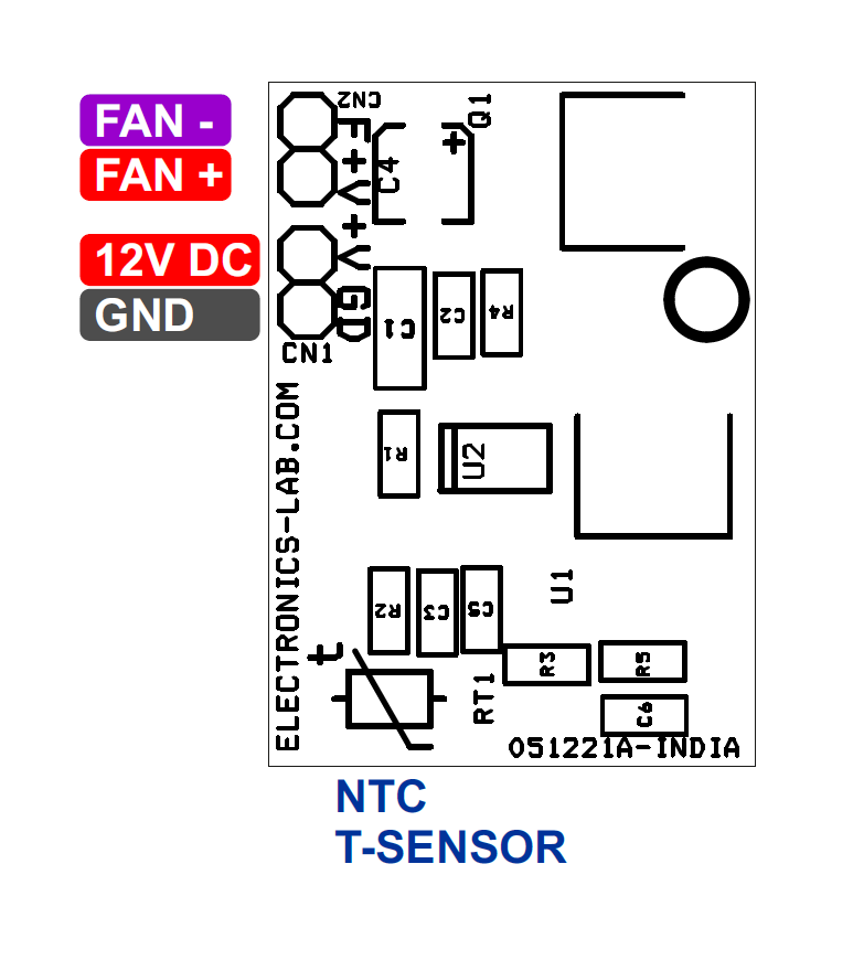

Connections
