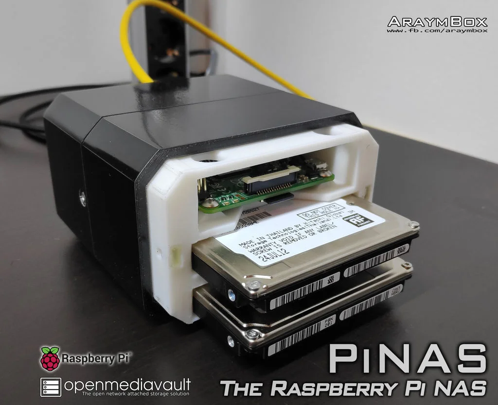

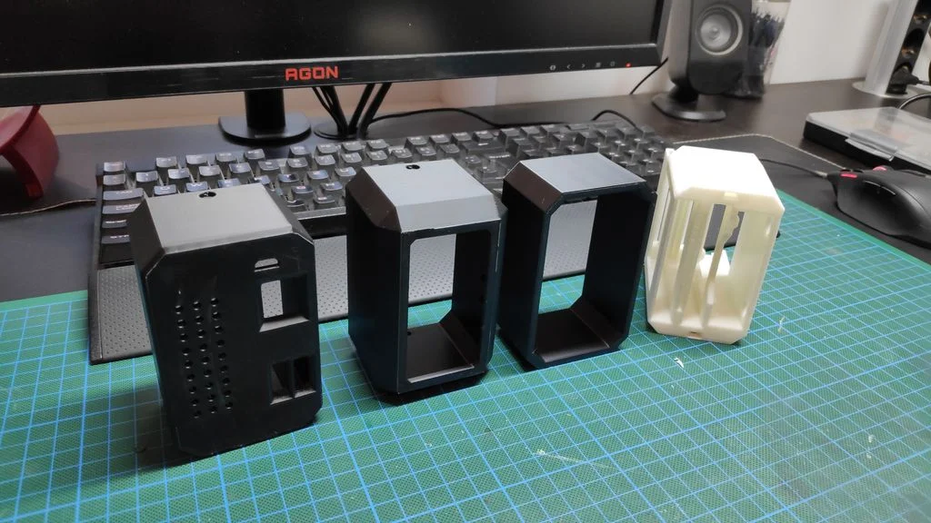

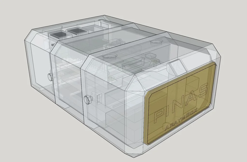

Enclosure Design
One of the best things about this project is the interesting enclosure that was designed for it. The enclosure which was 3D Printed comprises of only 4 parts and it was designed in such a way that it can be held together by just 4 bolts and can be opened easily to switch the drives or perform other maintenance.
To make the enclosure easy for people to replicate, the STL files are attached in the download section at the bottom of the page. You can also access the design files via project’s page on Thingiverse.
For printing materials, Aramybox used PLA for the inner part and ABS for the three outer shells. To improve the outlook of the enclosures and remove some of the imperfections due to 3D printing, a couple of Sanding paper, and painting actions were carried out.

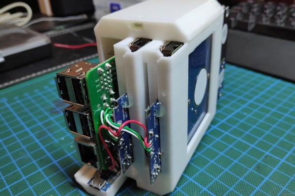

To make the project compact, “Aramybox” opened up the SATA to USB Adapters and desoldered the wires that go from the HDD end to the USB end. With the aid of jumper wires, the salvaged HDD end of the adapter is then soldered directly to corresponding pins on the USB ports of the Pi. Enough care should be taken at this point to ensure the Pi is not damaged and the existing connections on the board are not bridged. Asides the SATA connectors, “Aramybox” also connected a female MicroUSB power board to the Pi. It will provide an easy way to Power the Pi and other components like the SATA connectors, all at once.
A schematics showing the described connections is provided below.
Schematics
In place of soldering the wires directly on the SATA connector, you can choose to use male/female header pins. Just to make things neat and presentable.
The setup with all the components connected should look like the image below.

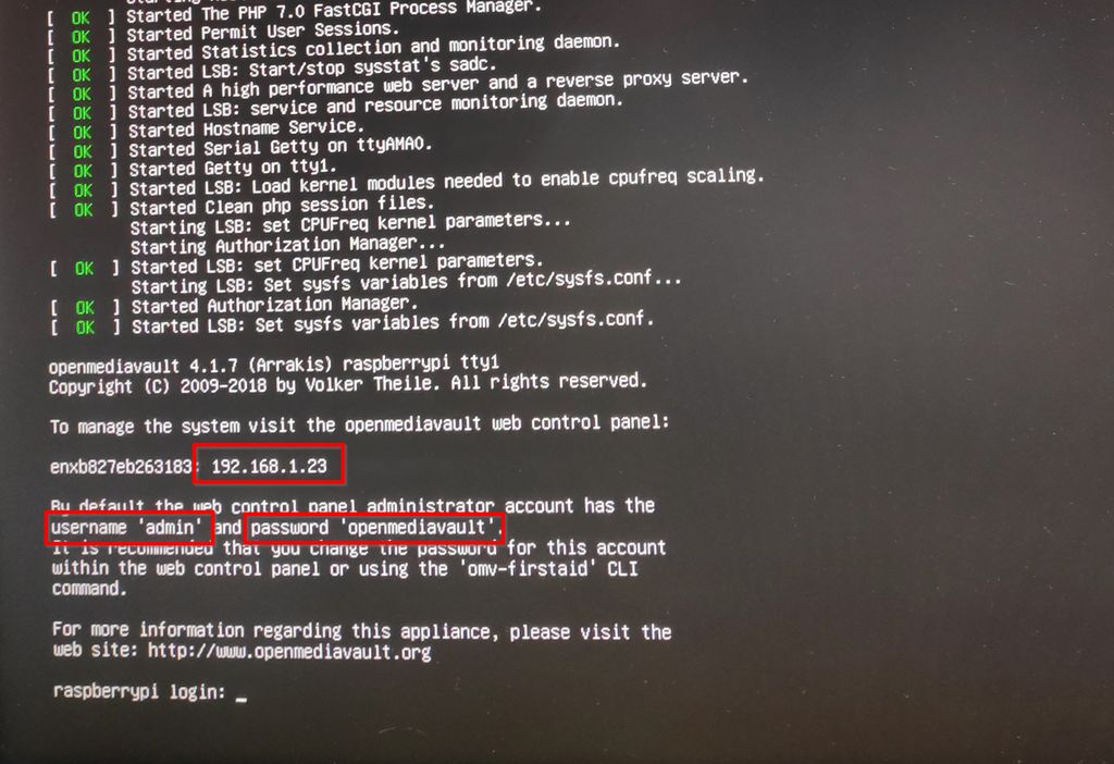

With the SD card successfully flashed with the OS, install the card into its slot on the Pi, connect the Pi to your network via an Ethernet cable, and power up the system. Powering up the setup for the first time, it is advisable to have a monitor connected to the Pi. This will allow you to access important information like the IP Address, along with Username and Password
With this info obtained, you can now disconnect the Pi from the monitor and proceed to configure Open Media Vault. 5 main sections of the Open Media Vault needs to be configured are:

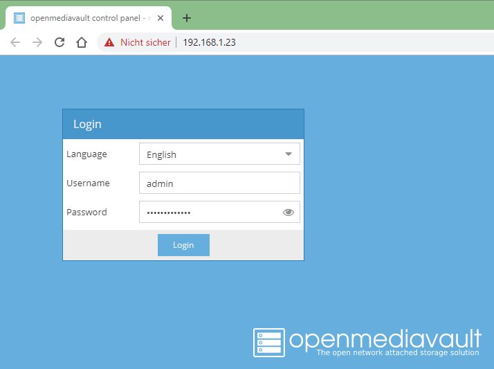

1. With the IP Address, Username, and Password all at hand, launch your favorite internet browser (firefox, chrome, ie, etc.) on a device (PC, smartphone, etc.) that is on the same network as the Pi.2.
2. Type in the IP-address of the PiNAS into the address bar of the browser.
3. You should now see the authentication screen of Open Media Vault.
4. Enter the username, password and click Login.

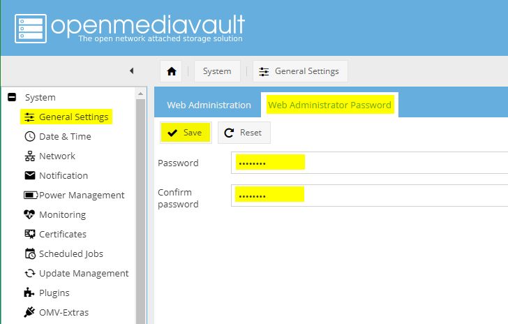

6. For the system configurations, we start with security. To ensure security, it is important to reset the password and username to one you can remember. To do this, click on the general settings tab. on the resulting page, click on the Web Administrator Password panel and fill in the new password. Click on the Save button.

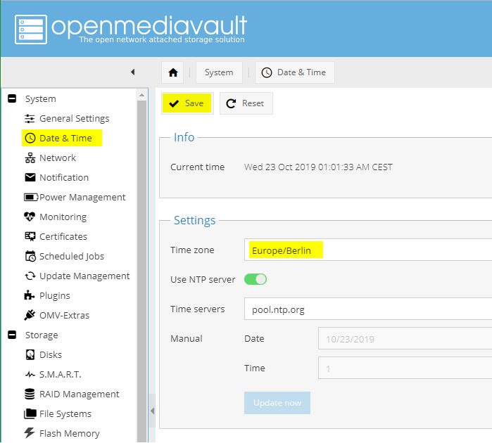

7.  Next, we set the time and date of the system. Do this by clicking on the time and date tab. On the resulting window, select your time zone, enable the NTP (Network Time Protocol) feature, and set a time server. Click the save button to save this setting.

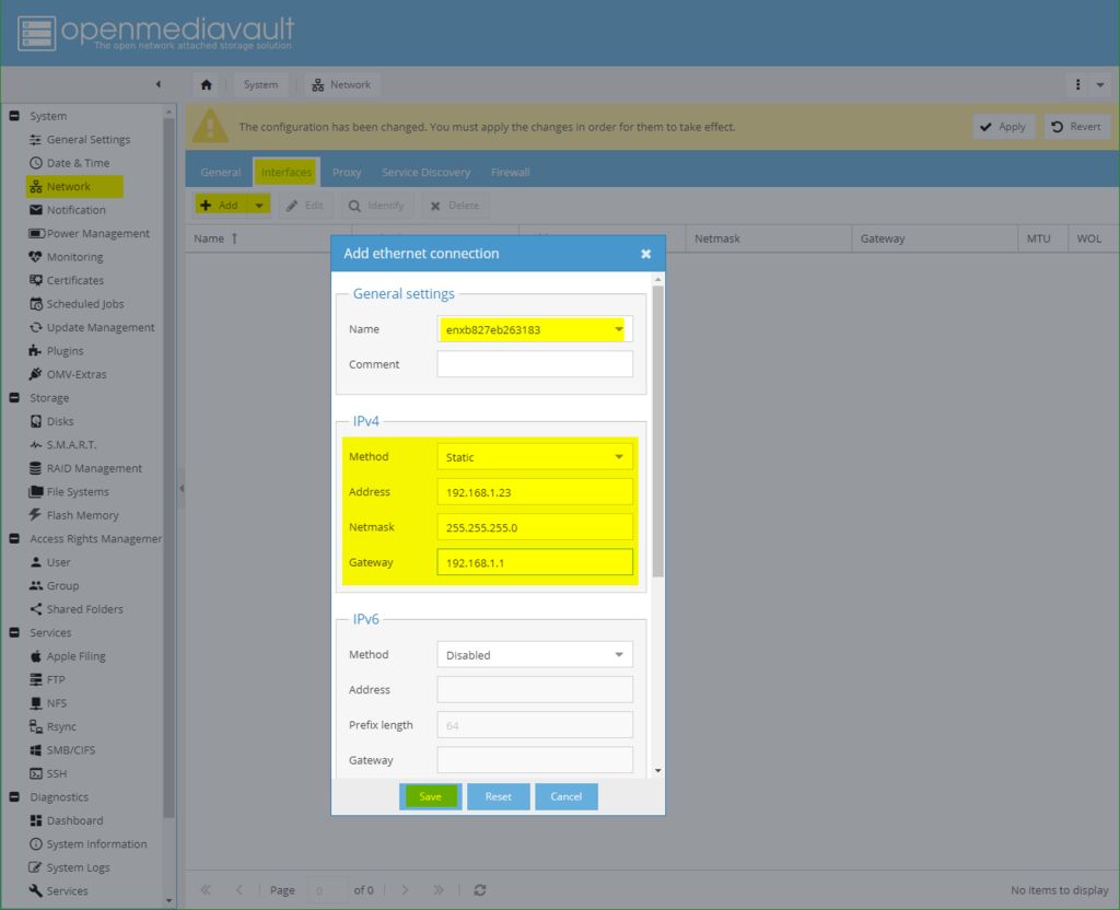

8. Next, we configure the network identity. Click on Network and go through each of the tabs giving your PiNAS a hostname, Set a Static IPv4 address so it does not change after reboot, and activate the services you desire in the Service discovery tab.

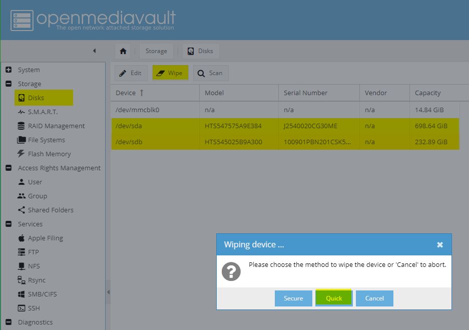

Disks
  1. Click on the Disks button
  2. Make sure both hard drives were identified and listed on the resulting page
  3. Run through the following steps for both disks:
    i. select the disk, click Edit and enable write cache.
    ii. Select the disk, click Wipe, and click on the quick button to wipe all data from the disk and give the system a clean slate to work with.

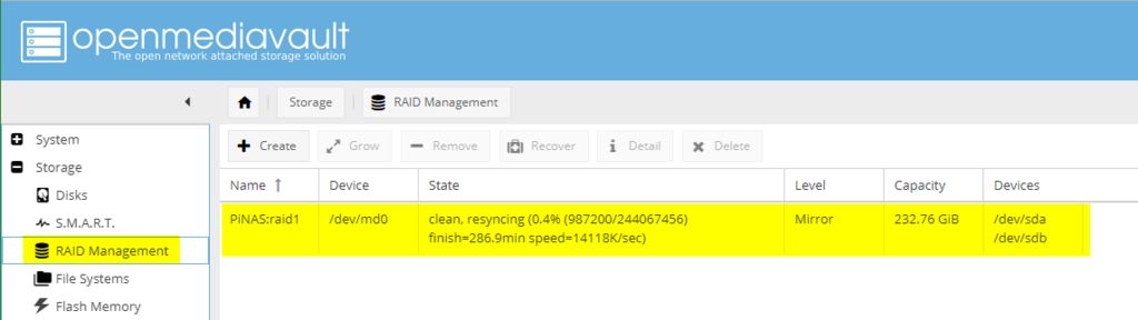

RAID Management
1. Select RAID() management in the dropdown on the right and click on the create button.
2. On the resulting window, fill In parameters like the name of your RAID e.g. raid1, the RAID Level e.g Mirror (RAID Level 1), Select devices you want to add to the RAID (select both your disks).
3. With the above done, Click Create to create the RAID using the selected disks. The RAID should take some time to re-sync. After syncing, the state of the raid would change to clean.

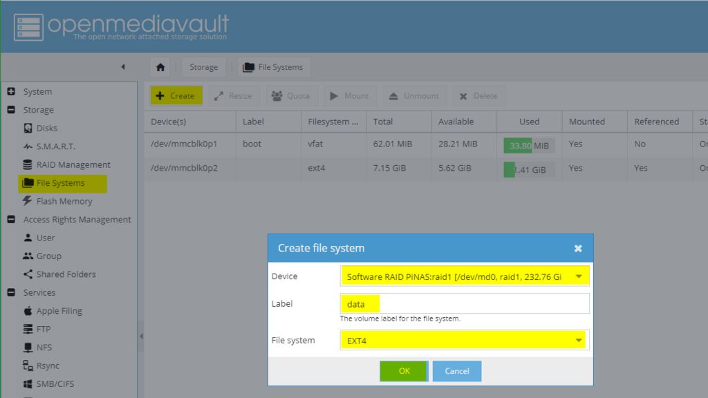

File System
  1. Select File Systems in the dropdown on the right and click on the create button.
  2. Select your Device which in this case should be the previously created “raid1”(or whatever name you gave it)
  3. Give your file system a Label to identify it easily
  4. Select your desired file system type
  5. Click OK to create the file system
  6. Wait for your file system to finish initializing (Status has to be Online)
  7. Select your initialized file system and press Mount to make it available

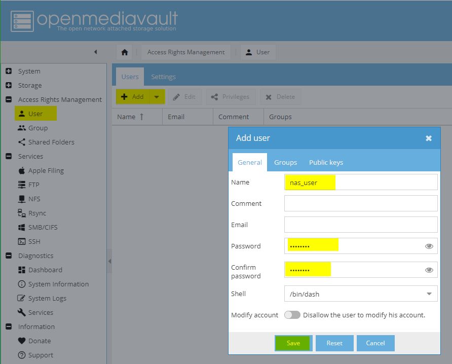

Create Users
User accounts are necessary for file system access.
  1. Expand the Access Rights Management dropdown and click on the user’s tab.
  2. Click “Add” to create a new user and in the resulting window, fill in the Name, and password, and hit the “Save” button when done.

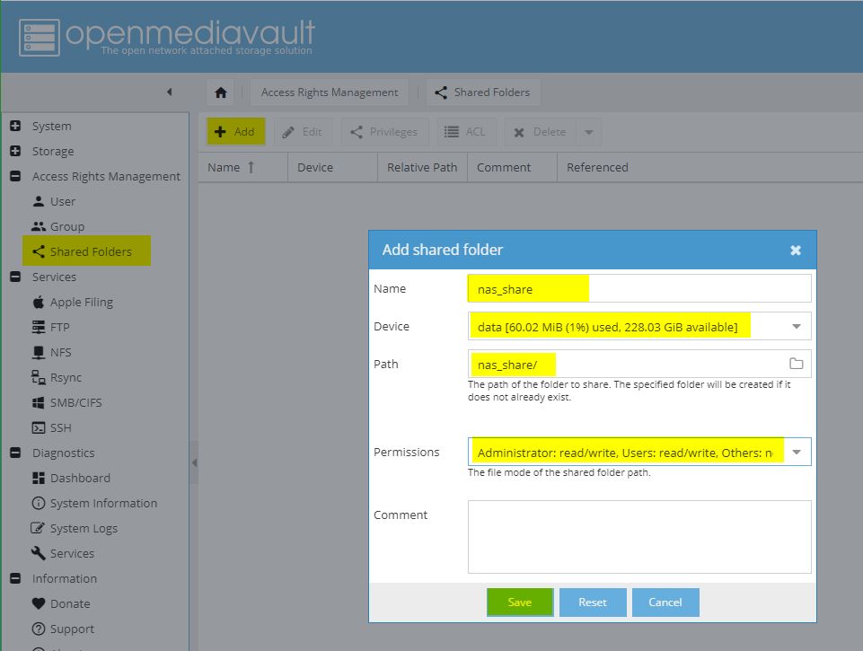

Create Shared Folders
  1. Click on the shared folder under Access Right Management Window.
  2. On the resulting window, click ”Add to create a new shared folder
  3. Enter a Name for the new share folder (this name will be connected to other machines)
  4. Select the Device (your previously created file system) where the shared folder will be created on
  5. Select or enter the Path of your shared folder
  6. Set your desired Permissions for this shared folder (more permissions will be set in the next steps)
  7. Click Save to create the shared folder

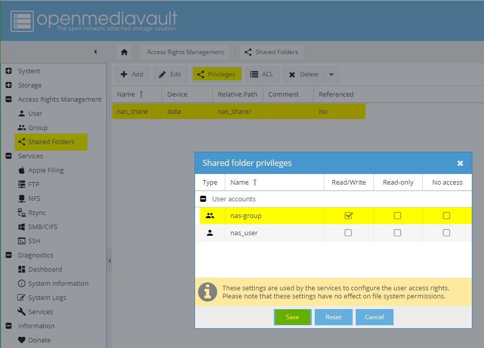

  8. Click Privileges to set them for users or user groups
  9. Set your desired privileges to your users or/and groups
  10. Click Save to save your settings

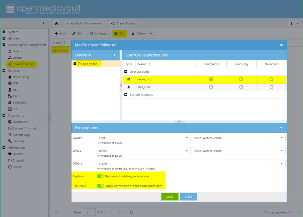

  11. Click ACL to create a new Access Control List for your shared folder
  12. Set your desired User/Group permissions (e.g. Read/Write) for your users and groups
  13. Enable “Replace all existing permission” and “Apply permissions to files and subfolders”
  14. Click “Apply” to create and apply the ACL

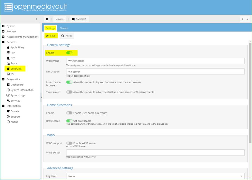

SMB/CIFS
Under the services section, we will only be configuring the SMB/CIFS section.
  1. Expand the Services tab and select SMB/CIFS
  2. On the resulting page, click the settings tab and enable SMB/CIFS
  3. Open tab Settings

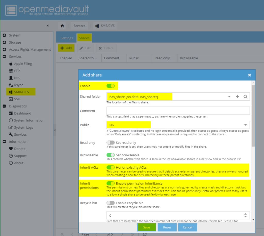

  4. Next, click on the “Shares” tab and  click on the “Add” button to create a new SMB share
  5. Enable the new share
  6. Select a shared folder (the one you created before)
  7. Select if the share will be Public (visibly listed by PiNAS)
  8. Enable Honor existing ACLs (inherit ACLs)
  9. Enable permission inheritance
  10. Finally, click “Save” to create the new SMB share

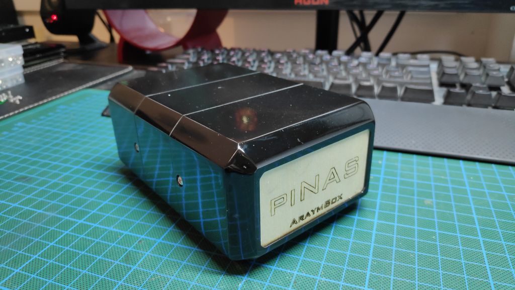

After the configurations, you can now go ahead and fully enclose the PiNAS. It should look like the image below.
