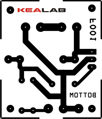

– PCB dimensions 40 mm x 34 mm

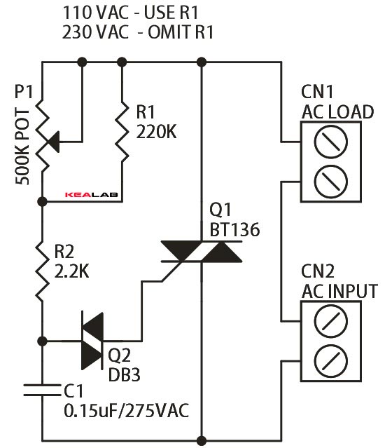

Schematic
Circuit description

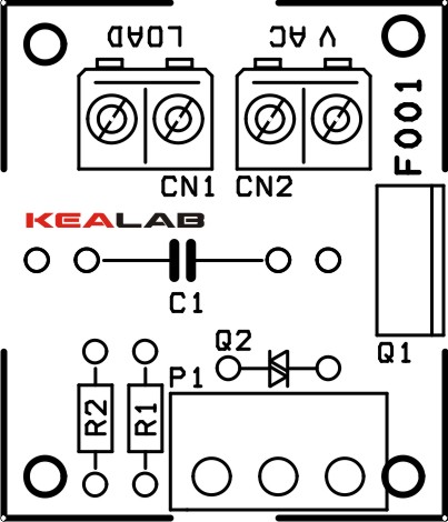

This kit consists of BT 136 Triac, resistors and capacitor. CN1 connector is for Load connections and CN2 connector for power supply connections.
BT136: It is a sensitive gate Triac, used in general purpose bidirectional switching and phase control applications where high sensitivity is required.
DB3: It is a DIAC that functions as a trigger diode with a fixed voltage reference. It can be used in conjunction with Triac for simplified gate control circuits or as a starting element in fluorescent lamp ballasts.

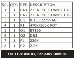

Parts List

And now, seriously, take care about the P1 (470k pot.). Must have at least 0.25W power dissipation.
Potentiometer has parallel resistor for power dissipation. So its POT + Resistor
you can leave out R1 (220K) for 220v 120v supplies , and you can connect a 470k or 500k pot, you can use either one, it doesn’t really matter, R3 needs to be at least 3 watts and can be 2k2 to 4k7…ok? hope that helps you?
use the 470k or 500k pot, and DO NOT install the fixed 220k resistor, as it will have NO effect on the circuit, it will probably give more headaches than solving the problem, by the way…the 2k2 resistor should be at least 3 watts (or above) ,IF the 2k2 resistor doesn’t give you the desired effect? increase resistance to either 4k7 or 5k1, ok? hope that helps you?

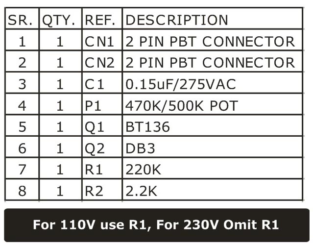

Thank you for responding. I’ve another question: Is POT 470K or 500K which one is it and why?
If you can’t find a 500k pot you can try to use a 470k, it will work just fine.
