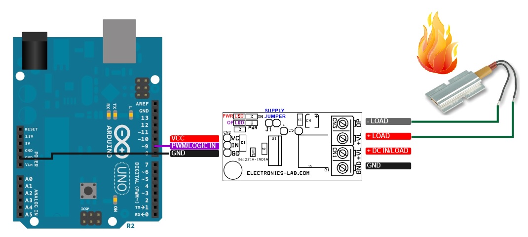

Arduino Interface
Sample Arduino code is provided below to drive and test the board with a PWM signal. Connections are as follows.
MOSFET FDB0300N1007L – N-Channel Power Trench 100V, 200Amps
  • VGS 10V = 3 mΩ ID 26 Amps
  • VGS 6V = 4.5 mΩ ID 20 Amps
Operating Power Supply – 5V to 12V
  • Close Jumper J1
  • CN2: Pin 2 PWM or Logic In, Pin 3 GND
  • CN1: Load Supply 5V to 12V
  • CN3: Load

Operating Power Supply – 12V to 60V
  • Open Jumper J1
  • CN2: Pin 1 Apply 12V VCC, Pin 2 PWM or Logic In, Pin 3 GND
  • CN1: Load Supply 12V to 60V
  • CN3: Load

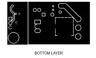

Gerber View
