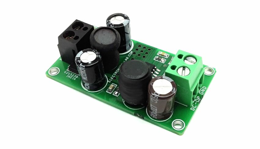

The project presented here is a universal input AC/DC switching buck regulator with ultra-low standby power that is capable of delivering up to 2.5W output power. The RAA223012 chip is the heart of the project which combines constant off-time control for heavy load and Pulse Frequency Modulation (PFM) for light-load operation.
Power by mixos
The project presented here is a universal input AC/DC switching buck regulator with ultra-low standby power that is capable of delivering up to 2.5W output power. The RAA223012 chip is the heart of the project which combines constant off-time control for heavy load and Pulse Frequency Modulation (PFM) for light-load operation. Constant off-time controls switching frequency above the audible frequency of approximately 50kHz. PFM eliminates any potential audible noises while offering superior light-load efficiency and ultra-low power consumption (<10mW at no load). Efficiency is achieved up to 75%. The built-in frequency dithering further reduces the EMI noise spectrum.  The RAA223012 also features input brownout protection that prevents input circuitry from the overcurrent at low input voltage, and hiccup protections for output fault conditions such as short-circuit, overload, and open feedback.

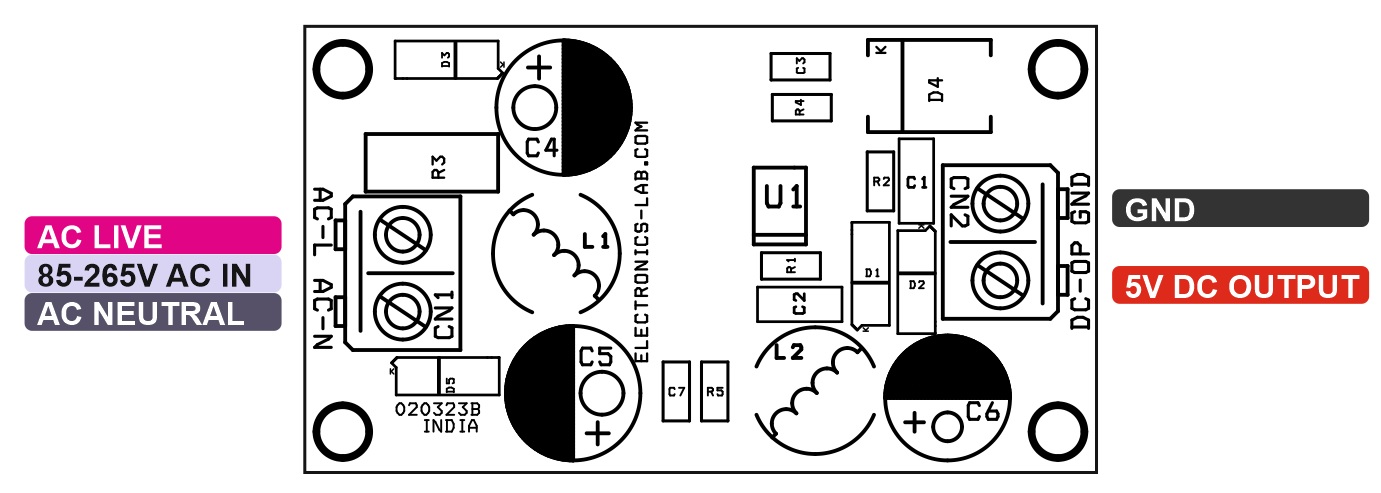

  • 4 x 2.5mm Mounting Holes
  • PCB dimensions 52.07 x 28.58 mm

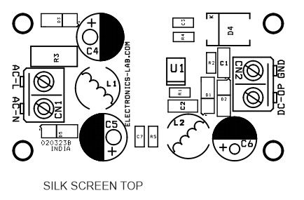

Connections And Other Details
  • CN1: Pin 1 = AC Live Input, Pin 2 = AC Neutral Input (85V to 265V AC Range)
  • CN2: Pin 1 = +5V DC Output, Pin 2 = GND
HIGH VOLTAGE: Dangerous voltage exists until the power is OFF. This power supply uses hazardous voltage. The PCB must be installed in an enclosure that prevents accidental contact. Use Plastic screws to mount the PCB. Wait for a few minutes after the input power is disconnected before touching the board. Make sure the bulk capacitor fully discharges.

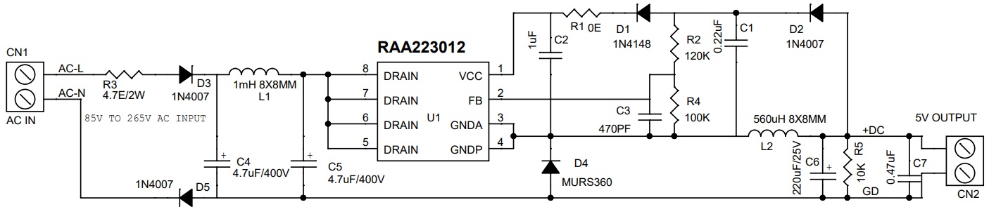

When the output is shorted, VOUT = 0, VFB drops to zero because of the feedback network, introducing a delay. Before VFB drops to VFB_TOFFMIN, the RAA223012 operates with TONMAX and TOFFMIN, which quickly builds up a high current (>IPK) because the inductor peak current does not get reset. When the current reaches ISC_TH, a timer is started. If the inductor current reaches ISC_TH for four consecutive cycles, the RAA223012 determines that a short-circuit is present and immediately shuts off the switching. The IC then quickly charges VCC up to 5.9V and discharges it with a 19µA current source to 3.4V. When VCC drops to 3.4V, a 1.6mA current source charges VCC back to 5.9V where the IC resumes switching.  When the RAA223012 resumes switching, assuming VFB drops to zero, the IC operates with the increased TOFFMIN_MAX so the inductor current can fully reset below the maximum peak limit. The RAA223012 operates in  CCM with the inductor peak current being limited at IPK, with an average current around 240mA during the short.  The part remains in hiccup mode until the short is removed. When the short is removed, VOUT returns to normal.
Schematic

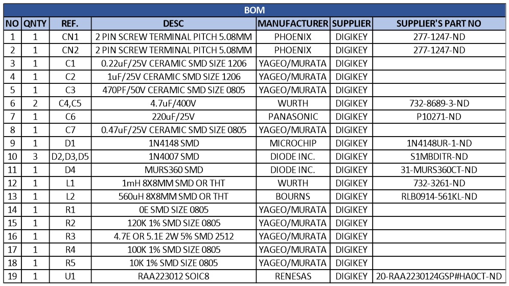

Parts List
NOQNTYREF.DESCMANUFACTURERSUPPLIERSUPPLIER'S PART NO
11CN12 PIN SCREW TERMINAL PITCH 5.08MMPHOENIXDIGIKEY277-1247-ND
21CN22 PIN SCREW TERMINAL PITCH 5.08MMPHOENIXDIGIKEY277-1247-ND
31C10.22uF/25V CERAMIC SMD SIZE 1206YAGEO/MURATADIGIKEY
41C21uF/25V CERAMIC SMD SIZE 1206YAGEO/MURATADIGIKEY
51C3470PF/50V CERAMIC SMD SIZE 0805YAGEO/MURATADIGIKEY
62C4,C54.7uF/400VWURTHDIGIKEY732-8689-3-ND
71C6220uF/25VPANASONICDIGIKEYP10271-ND
81C70.47uF/25V CERAMIC SMD SIZE 0805YAGEO/MURATADIGIKEY
91D11N4148 SMDMICROCHIPDIGIKEY1N4148UR-1-ND
103D2,D3,D51N4007 SMDDIODE INC.DIGIKEYS1MBDITR-ND
111D4MURS360 SMDDIODE INC.DIGIKEY31-MURS360CT-ND
121L11mH 8X8MM SMD OR THTWURTHDIGIKEY732-3261-ND
131L2560uH 8X8MM SMD OR THTBOURNSDIGIKEYRLB0914-561KL-ND
141R10E SMD SIZE 0805YAGEO/MURATADIGIKEY
151R2120K 1% SMD SIZE 0805YAGEO/MURATADIGIKEY
161R34.7E OR 5.1E 2W 5% SMD 2512YAGEO/MURATADIGIKEY
171R4100K 1% SMD SIZE 0805YAGEO/MURATADIGIKEY
181R510K 1% SMD SIZE 0805YAGEO/MURATADIGIKEY
191U1RAA223012 SOIC8RENESASDIGIKEY20-RAA2230124GSP#HA0CT-ND

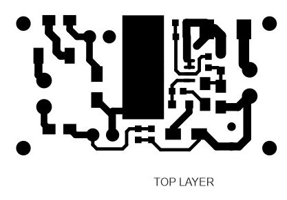

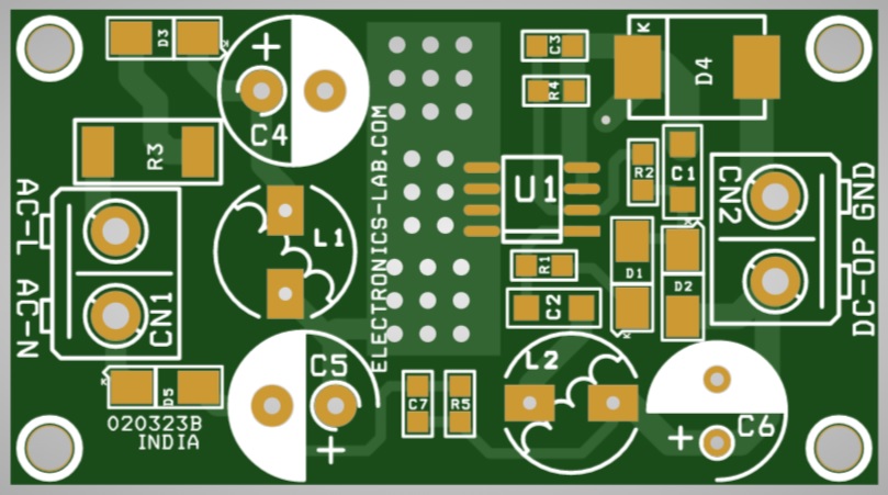

Gerber View

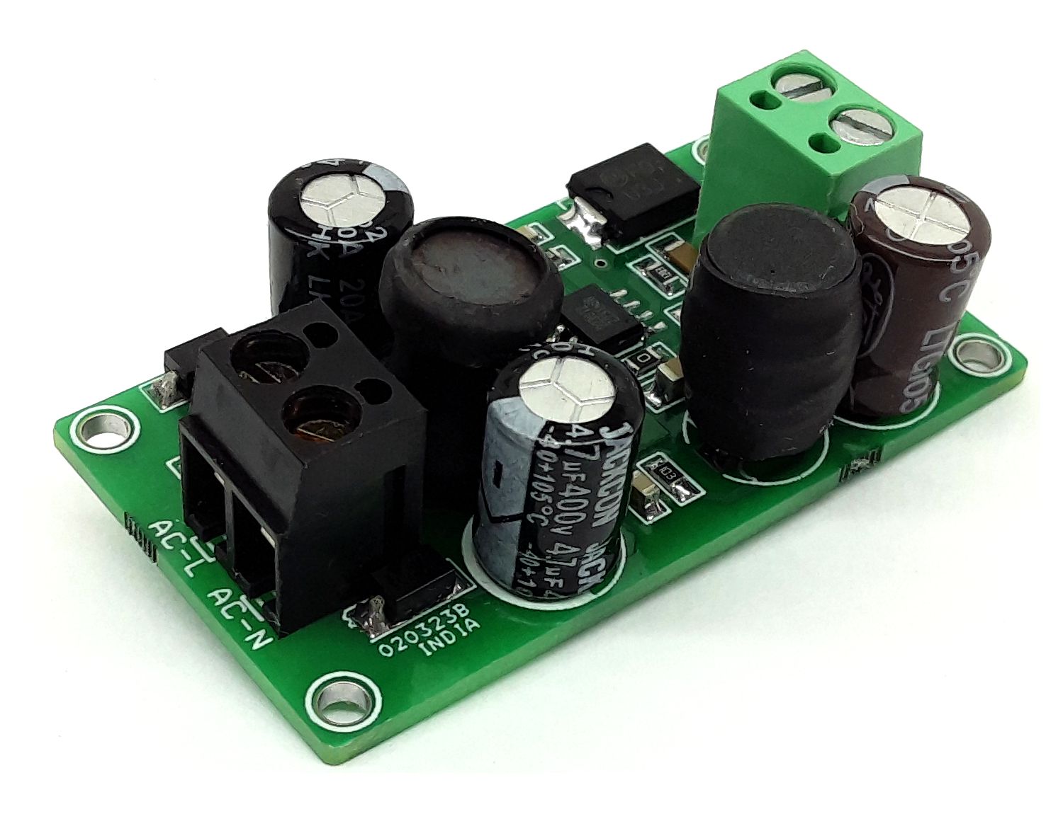

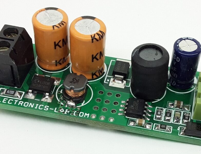

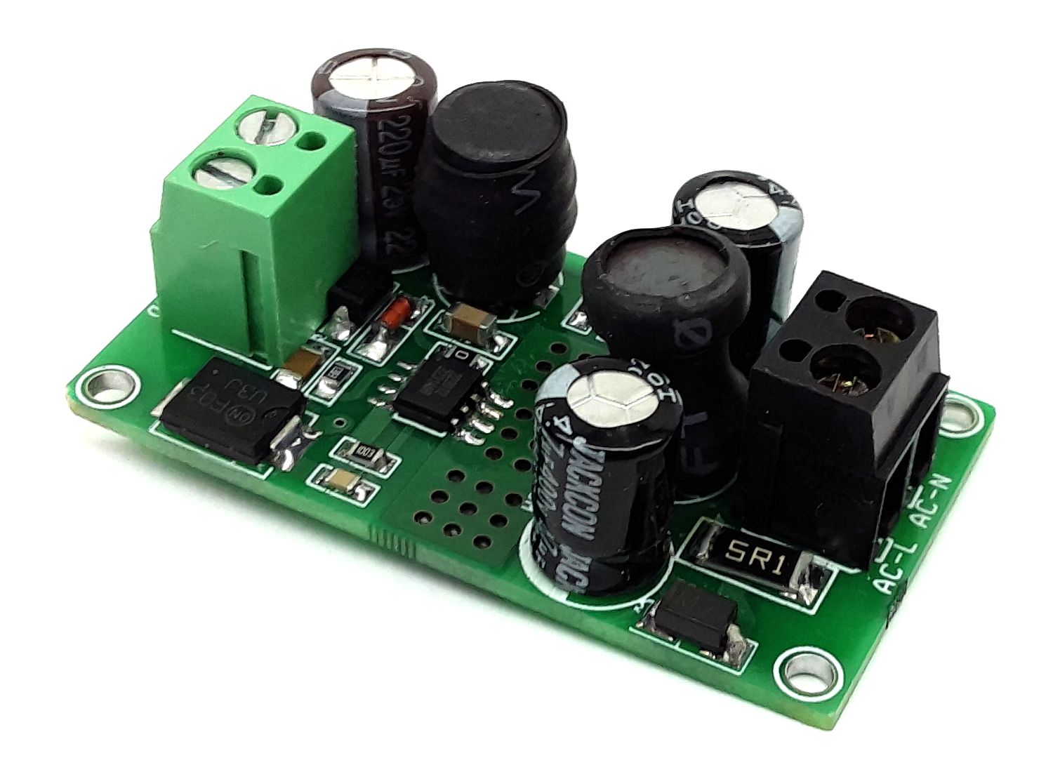

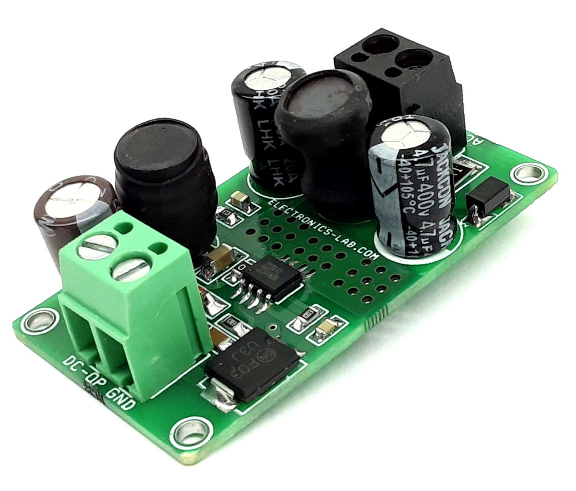

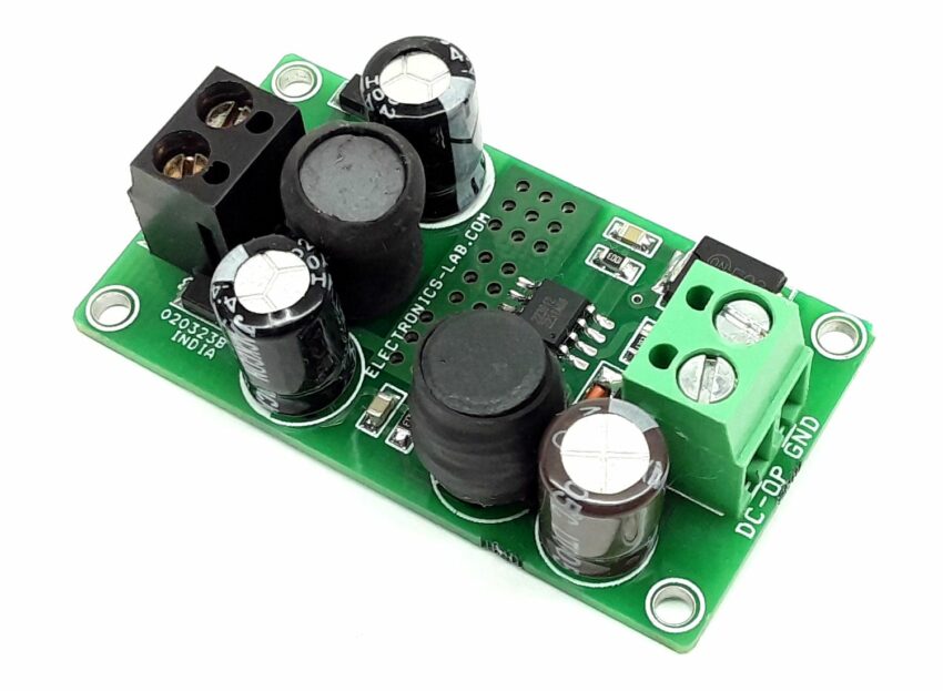

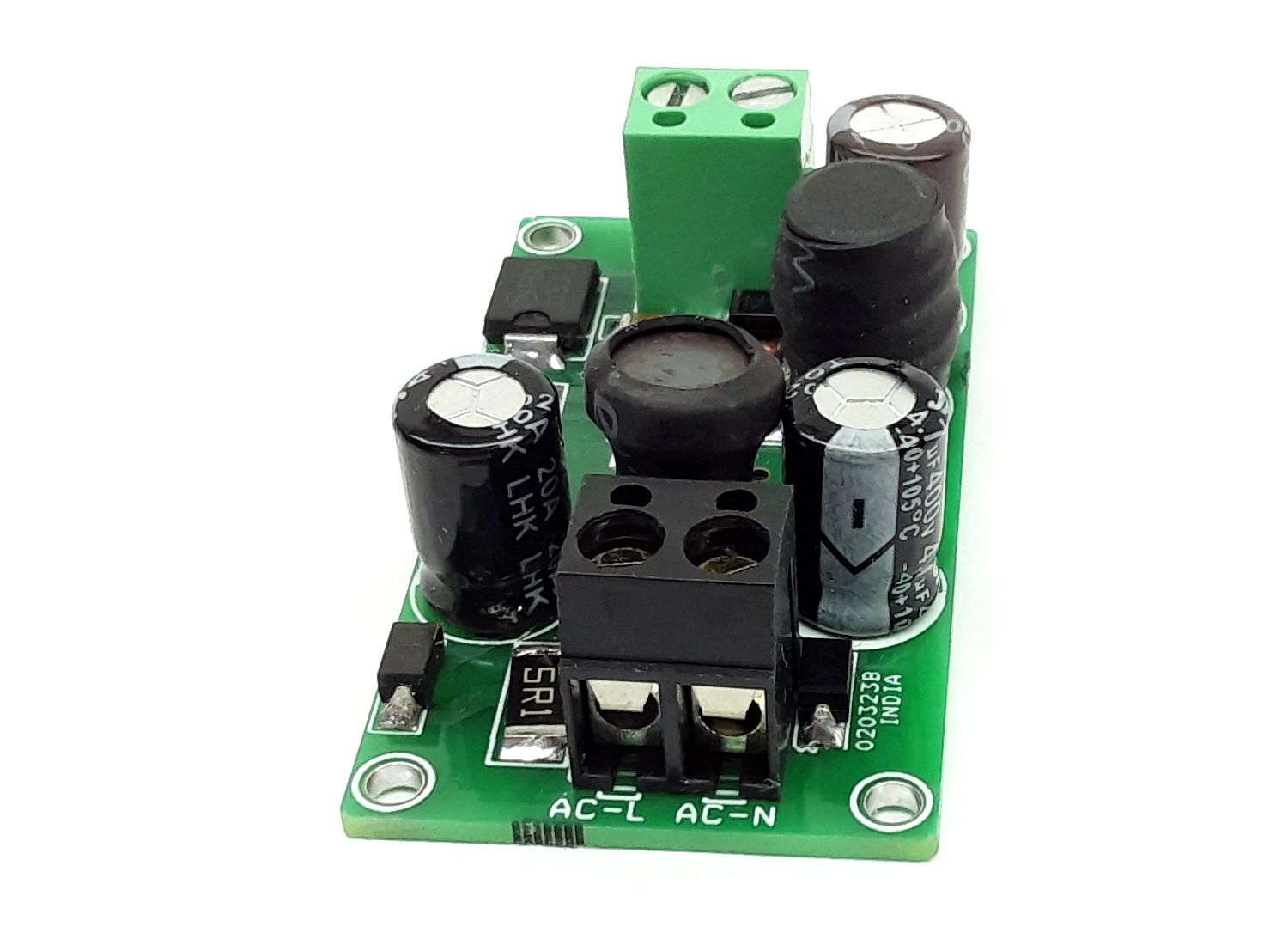

Photos
