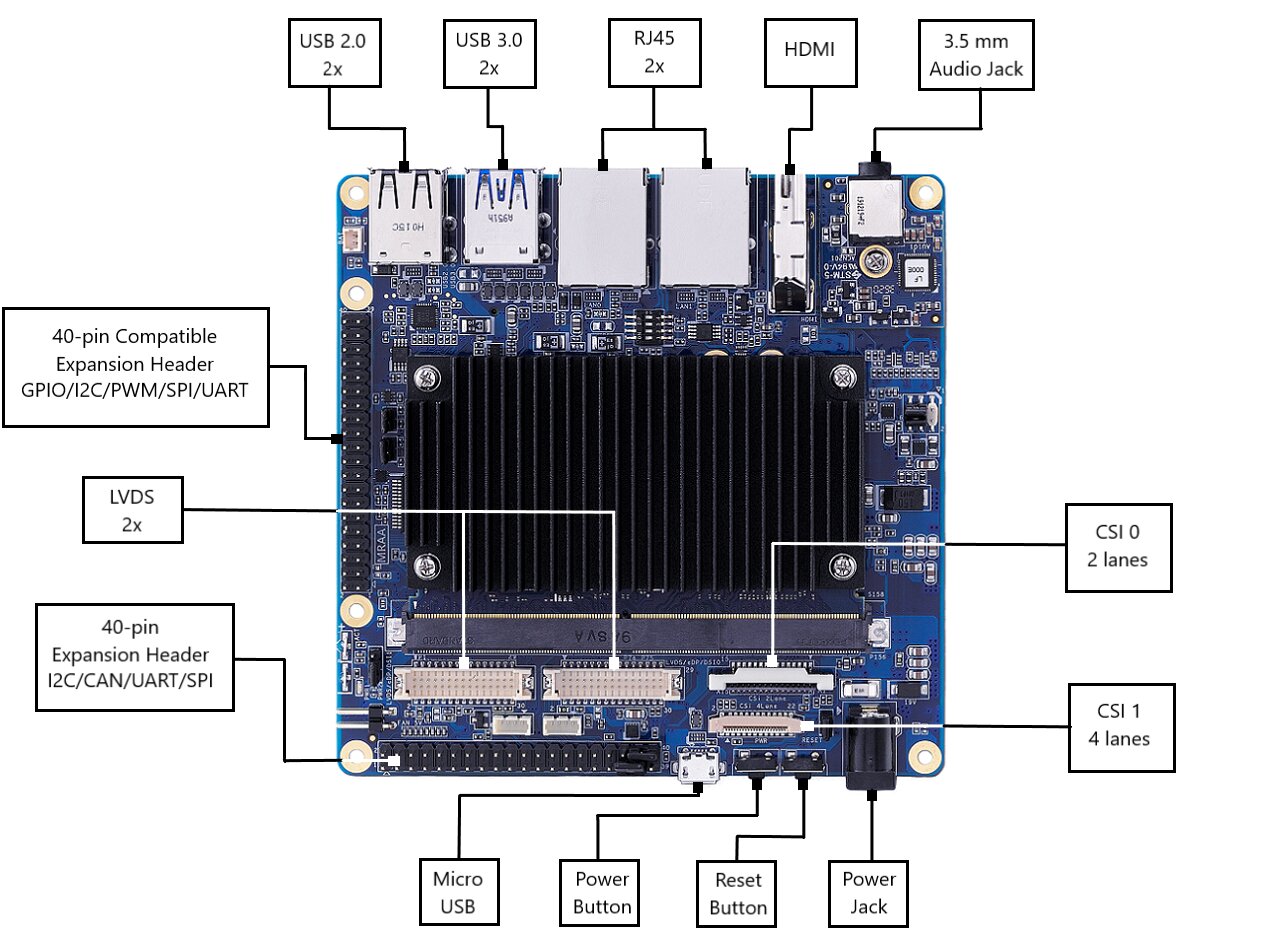

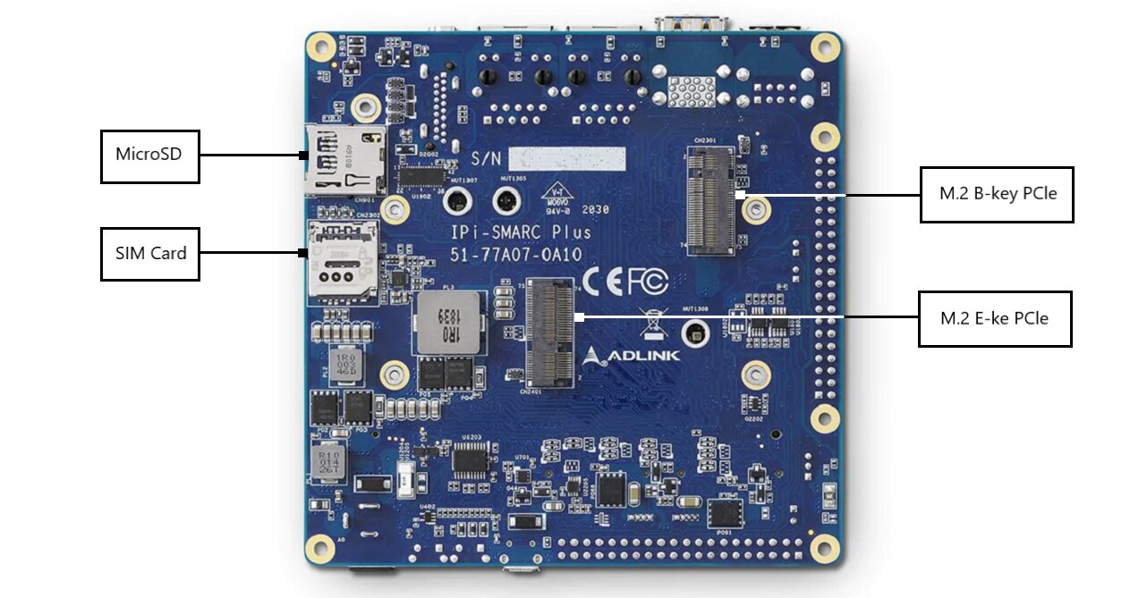

On the other hand, the carrier board features dual 2.5GbE TSN-capable ports, dual Raspberry Pi-compatible GPIO headers, HDMI, LVDS, MIPI DSI, and eDP display interfaces, and two MIPI CSI camera interfaces. Additional features include four USB ports, three M.2 sockets for storage, WiFi, and cellular modules, TPM 2.0 security, and extensive low-speed I/Os. With a rugged design supporting wide temperature ranges and industrial-grade reliability, it is designed for IoT, vision-based edge computing, and industrial automation applications.

    • M.2 B-key socket for 4G LTE/5G cellular connectivity
    • M.2 E-key socket for WiFi/Bluetooth module
    • M.2 M-key socket for storage
    • 2x 40-pin Raspberry Pi-compatible GPIO headers with SPI, I2C, CAN Bus, UART, PWM, and GPIO
