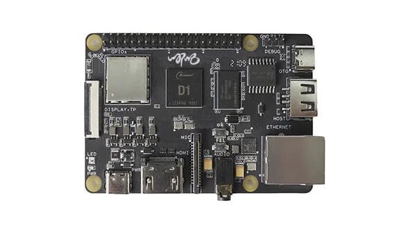

According to Caesar’s telegram post, the Lichee RV module is a style board furnished with an edge connector to support industrial applications. The compact module will be equipped with an Allwinner D1 chip with a 1.0 GHz 64-bit single-issue Linux-capable core with draft Vector extension 0.7.1, 1 Gbyte DDR3, and an inbuilt Nand Flash of 256 Mbyte. The module also has a SODIMM-like form factor with an edge connector, which breaks out most functions of the chip. The module can function as a standalone device with few input and output interfaces and peripherals.
The module is also expected to launch with an optional carrier board that can offer the same connectivity like the one provided by the $99 Nezha single board computer. Other details revealed by Bruce Hoult include 2.5 x 4.5cm dimension, 512 MB DDR3, OTG USB-C, 4 pin UART, short TF slot, 2×67 pin NGFF breakout, and extra 1.14-inch SPI LCD. As for the efficacy of the board, Bruce rates it the best length-agnostic vector implementation available in the hardware ecosystem at the moment.
