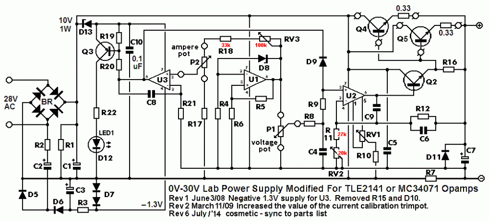

  1. When you turn down P2 to zero then the project's output current should be no more than a few mA. The circuit reduces the output voltage with U3 and D9 to reduce the current. When the current is limited to a few mA then the anode of D9 is 0V and its cathode which is driven from the output of U3 must be about -0.65V. That is why U3 is an opamp that has its input and output able to go close to its negative supply and why it has a negative supply. When you turn up P2 then the current does not go up, the voltage and the load resistance set the current. The maximum current goes up. The circuit is designed for a maximum current of 3A so you should set the current calibration trimpot RV3 so that with P2 at maximum and with the output of the project shorted then the current is 3.0A. If RV3 is set to its maximum of 100k then the maximum output current will be 1.33A as I showed in post #?.
  2. 165mV/500mA= 0.33 ohms that is wrong. 215mV/1A= 0.215 ohms that is also wrong. 1.304V/3A= 0.435 ohms which is close to your measurement of R7. Then trimpot RV3 is set for a max current of 3A or less. When the output current is higher than the setting of P2 then the output of U3 goes low which turns on the LED and reduces the voltage at the output amplifier. Then the shorted output should have a current of 3.0A maximum. The opamp used for U3 and the negative supply voltage must be allow the output of U3 to go low enough so that the input to the output amplifier is shorted to 0V when the output of the project is shorted. Then R7 is the load.

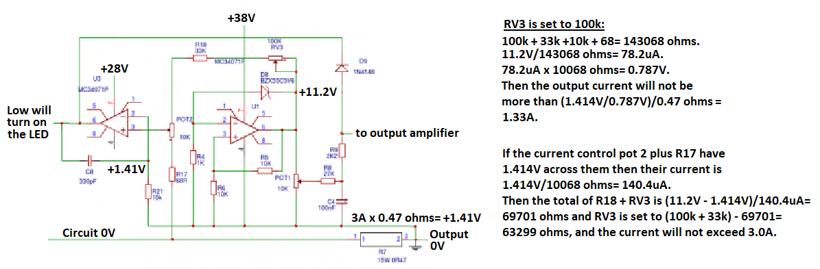

  4. 5V on 10 ohms produces a current of 500mA (0.5A). Then the voltage across R7 is 0.235V. On your schematic, C is the ground for the current regulator. The output ground is its input signal and the 11.2V is its reference voltage.
  5. The Chinese meter is messing up the voltage and current of the power supply project. Try the power supply project without the Chinese meter. Measure the voltage across R7 then calculate the current in it. The voltage across R7 will never be more than 1.414V when the current in it is 3.0A or less. Here are my calculations for the current calibration trimpot RV3:

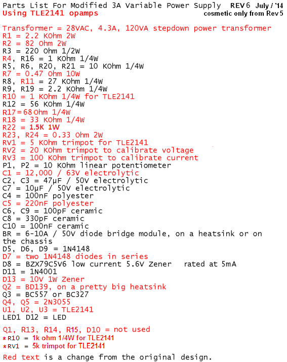

  6. Which schematic are you using? Years ago when I replaced the low voltage TL081 opamps with higher voltage MC34071 or TLE2141 I replaced the D7 zener diode with two diodes so that the negative supply is only -1.3V. The 0V reference (zero point) for making measurements has always been the negative wire of C1, the main filter capacitor.

  9. A solderless breadboard has intermittent contacts that cannot handle the high currents of this project. The many rows of contacts and wires all over the place have capacitance between them that frequently causes a circuit like in this project to oscillate at a high frequency. In my career I made all my prototypes soldered together on stripboard where I planned the layout to be compact and the strips were cut to length so that each strip was used for many parts of the circuit. Some of the circuits were very complex but worked perfectly and looked good enough to be sold as the final professional product.
  10. Why are you using an old fashioned vented lead-acid battery? Most circuits today are powered by rechargeable Ni-MH or Lithium batteries that have no acid.
  11. Every opamp has an input offset voltage error. Single opamps like the recommended MC34071 and the TLE2141 have input offset voltage adjustment pins. The project uses trimpot RV1 to null the offset voltage but your MC34072 does not have offset adjustment pins. Since your MC34072 has two opamps then it has double the heating and I think it becomes too hot. The original project used the wrong value for R10 connected to RV1 and R10 was connected to the wrong voltage. Here is how it was and how it should be:
