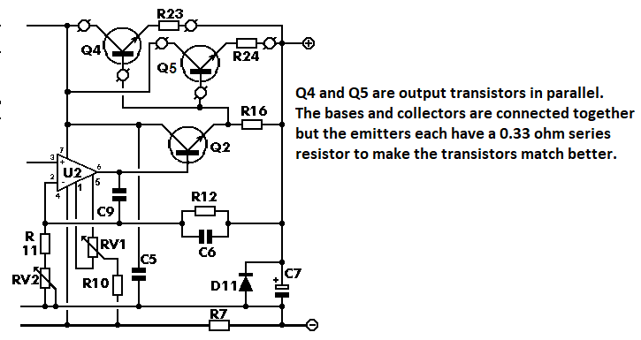

  4. R7 has nothing to do with the output transistors. Instead R7 senses the amount of output current and sends its sensing voltage to the current adjustment opamp. Each of your output transistors need a series 0.33 ohm emitter resistor so that the two transistors are better matched to share the heating.
  5. The parallel transistors in the circuit you posted do not have series emitter resistors so the ones with high gain take a high current and the ones with a low gain take a low current. Emitter resistors help to match the transistors. This is how the output transistors are connected in parallel:

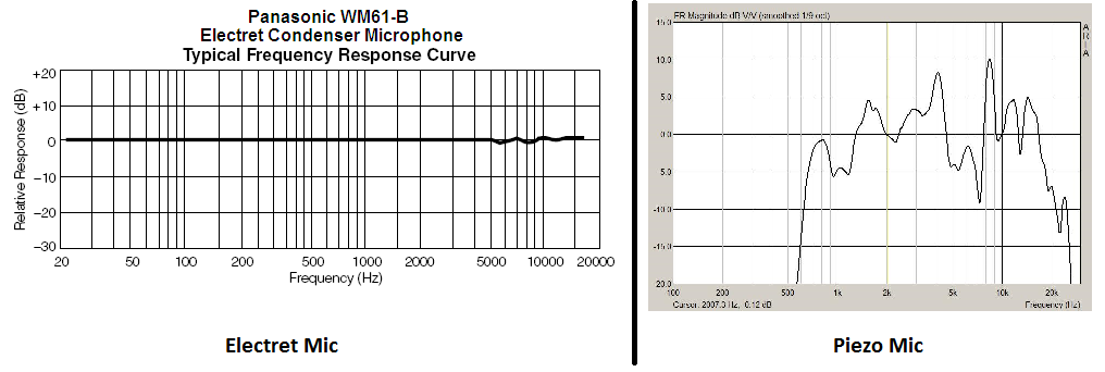

  14. Software will not test the frequency response of a mic. You need calibrated sounds at different frequencies to do it. the manufacturer should have shown a frequency response graph like these ones:
  15. A frequency response spec must include how much the levels deviate. Plus and minus 30dB is horrible but 2dB is pretty good. If they do not spec the plus and minus dBs then assume it is horrible. If you have background noise then you can turn down the volume. Using filters to cut frequencies you cannot hear will not reduce background noise. Instead you can cut all high audio frequencies to reduce hiss which will make words unintelligible and cut low audio frequencies so that guys voices sound like chipmunks. Audio opamps have low noise, "general purpose" opamps produce lots of noise. Your choice.

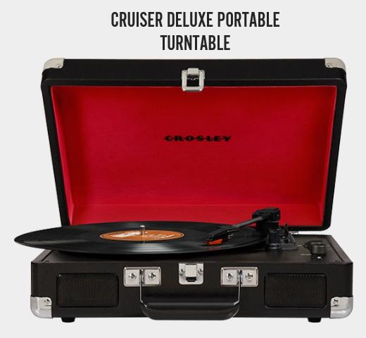

  18. Crosley still make record players. I found one in the trash that was probably wrecked by someone using the wrong polarity 9VDC adapter. it has a full range mono 6" speaker in it. it has an Aux output to feed an external amplifier if you want. A car amplifier runs from 12VDC. http://www.crosleyradio.com/turntables
