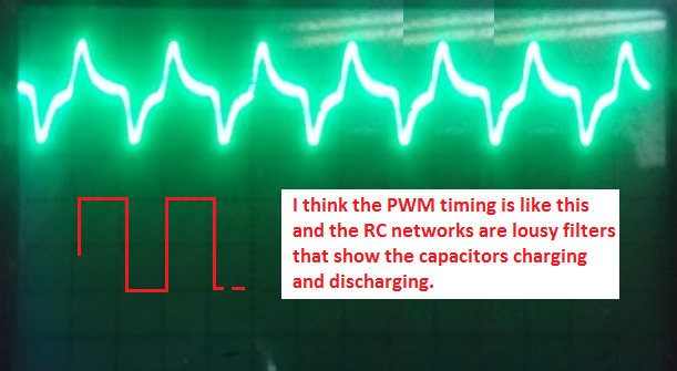

Your ground wire is too thin so it acts like a resistor that has a votage drop across it. You need a "star" ground that has all grounds together at one point then there is no ground wire for a voltage to develop across.
I think the very high discharge current in the ground wire is modulating the 0V of the PWM circuit or the opamp circuit. Use a thicker ground wire.

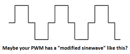

Why are you using poorly filtered PWM instead of variable DC? I don't see any "noise" on the 'scope. Instead I see the filter capacitors charging and discharging. Maybe the signal is a modified sinewave?
