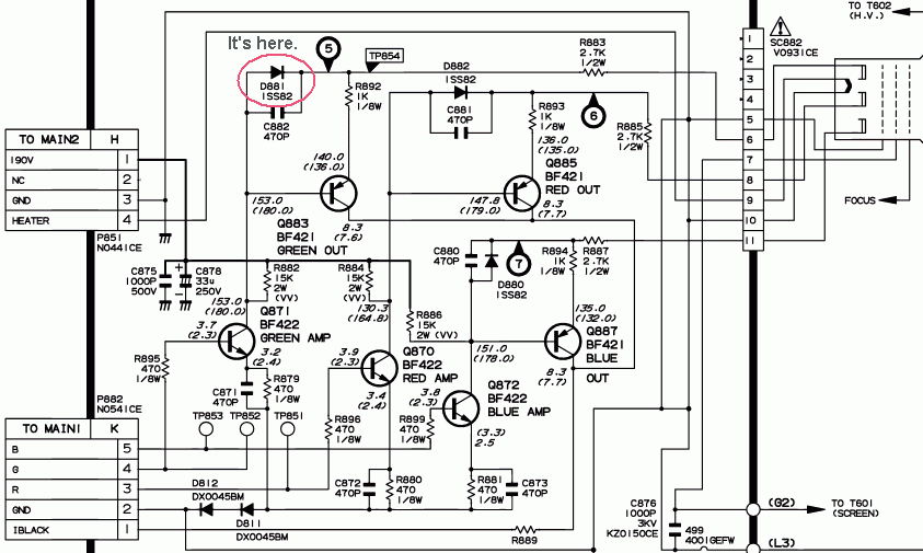

Guest Kasamiko Posted July 15, 2004 Report Posted July 15, 2004 Hi,I need a cross or any suitable replacement for diode 1SS82.Br.. :DRhonn ;) ;)1SS82.pdf Quote

ante Posted July 16, 2004 Report Posted July 16, 2004 The 1N4148 is rated 75/100 Volts and the 1SS82 is rated 250/300 Volts?Ante ::) Quote
Guest Kasamiko Posted July 16, 2004 Report Posted July 16, 2004 What is this diode's functionHere take a look. ;)@HotwaterWizardThanks a lot John..@AnteI was confused too. ::) Quote

GPG Posted July 17, 2004 Report Posted July 17, 2004 The diode is protecting the auto black level sense transistor. Any low current high speed diode rated at ~200V will do. Quote
MP Posted July 17, 2004 Report Posted July 17, 2004 Rhonn, the diode is not quite as critical in this setup as the capacitor. The diode function is secondary. Capacitor value is critical, though. This setup is used in conjunction with all of your PNP transistors.Since you asked: ;) When a reverse voltage is applied to a PN junction , the holes in the p-region are attracted to the anode terminal and electrons in the n-region are attracted to the cathode terminal creating a region where there is little current. This region, the depletion region, is essentially devoid of carriers and behaves as the dielectric of a capacitor. The depletion region increases as reverse voltage across it increases; and since capacitance varies inversely as dielectic thickness, the junction capacitance will decrease as the voltage across the PN junction increases. So by varying the reverse voltage across a PN junction the junction capacitance can be varied. (typically, the depletion region width is proportional to the square root of the applied voltage, and capacitance is inversely proportional to the depletion region width. This causes the capacitance to be inversely proportional to the square root of applied voltage.) This nonlinearity allows the varactor to be used also as a harmonic generator. A voltage controlled capacitance is useful for tuning applications.MP Quote
Guest Kasamiko Posted July 18, 2004 Report Posted July 18, 2004 MP thanks for that very informative reply.. ;)@GPGI think 1S2471 will do it.. Quote
